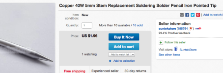

JP, Is it OK to leave the welder hooked up while the battery is being charged?
Also, the tips for solder irons someone suggested have steel tips. I was under the impression using copper or copper alloys was important.

riba2233 said:
18650dude said:
My tips are wearing down too. Bought these as an experiment:
http://www.ebay.com/itm/181759526820?_trksid=p2060353.m2749.l2649&ssPageName=STRK%3AMEBIDX%3AIT
Will let everyone know what happens.
That looks interesting, I was searching online for tips like that and couldn't find anything, but never thought of solder iron tip, nice find! Just make sure that the side surface is conductive, but it should be. And please tell us how does it work :)
Also, 1 mm tip is maybe too narrow (it will work for thinner nickel), I don't know if they have ~2 mm wide tip.
These are the tips I have and was referencing.
riba2233 said:
Oh sorry, I didn't get it at first. So you are saying that linked tips have copper body and steel point? Did I get that right? :)
Yes. The eBay link is "iron tip". Good cheap solder iron tips. I have two more coming and will confirm id need be, but the eBay link is clearly some sort of steel.

Im hoping to spotweld ni coated copper, 0.1mm-0.16mm thickness.
from some research it seems tungsten or molybdenm tips are best fro this. with copper welding, because its so conductive, you can not rely on the materials resistance to create the heat to make the weld, when the current passes through it. instead the TIPS of the electrodes provide the heat. so i think the high temp resistent tungston is a little less conductive so heats at the tip(the rest of the electrode is copper) and the electrode tips will last a lot longer also, as tungston has such a high melting point.
