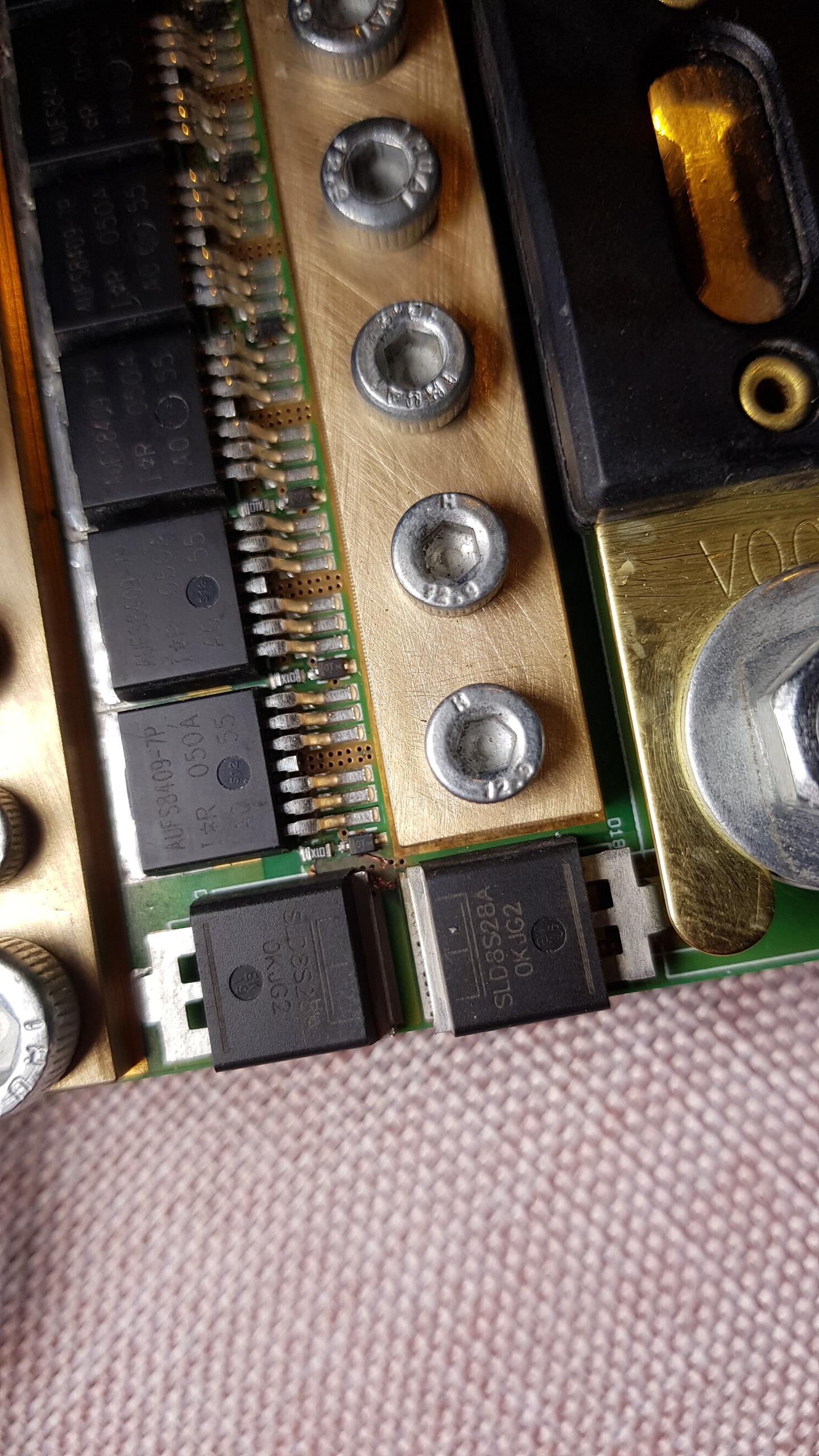

Hi! Today is good day to burn... kWeld ;(
I find that I burn Littelfuse SMDJ28A diode and one place. I want replace by myself...
I can't find SMDJ28A to buy local, but I find only (Transil 33V 3kW SMDJ33A DO214AB / LITTELFUSE SMDJ33A-LF).
Can you tell me if this diode will be OK?
Someone had a similar case? Do you have any advice for me?
The reason was my stupidity... I used 3 modules from the Nissan Leaf, this is the 6S 2P. That's around 2500 - 3000A when fully charged. When they were half discharged it was not a problem... Of course I cheated a bit with the calibration...
The burnt track suggests that the large TVS diodes at the right might be bad as well. These are Littelfuse SLD8S28A. Your replacement parts can't be used as their voltage ratings are too high. Depending on your battery voltage, you can go to lower voltage devices such as SMDJ24A (Digikey has a few of those).
You're right. There is a high chance that the TVS SLD8S28A is also damaged. I think SMDJ24A will be ok, my battery full chage voltage is 6 x 4.2V = 25.2V, this model can support 26.7V, there will be ok :) Either way I'm not going to use the kWeld on a full charged battery. I don't want to cause more damage... There is too much power on this Leaf modules...
EDIT paragraph: Today I found diodes to buy locally, model SM8S26A

Hi! I am still struggling with the repair of the kWeld ... I am looking for a replacement diode. Will the one on the right (SM8S26A) be a good replacement for the original one SMDJ28A?
The SM8S26A looks like an OK replacement for the large SLD8S28A, but for a SMDJ28A it is overkill (but would of course work). Instead of SMDJ28A you can also use one of the other voltages starting from 24V.
But as you keep killing the parts, something else must be horribly wrong. I suspect that either your battery is way too strong (i.e. has a too low internal resistance), or your wiring is bad. What is the total length of all current carrying leads added together? Did you configure the welder accordingly? Can I see a picture of your entire setup that shows battery and all leads? What exact battery model is that?

New diodes SLD8S28A is waiting for second attempt to repair kWeld (I buy 4 pieces, just in case) :) Now I waiting for SMDJ24A from Farnell (you recommend this because lack of SMDJ28A).
On first attempt I replace only this small SMDJ28A -> SMDJ33A. Maybe it caused damage (diode voltage too high) or my mistake during calibration... :mrgreen:
I'm still not sure if I solder everything well. Due to the burnout of paths, I changed the place of SMDJ28A. Can you confirm if I have kept good place and direction? Maybe I should put it as it was originally and connect the burned tracks?

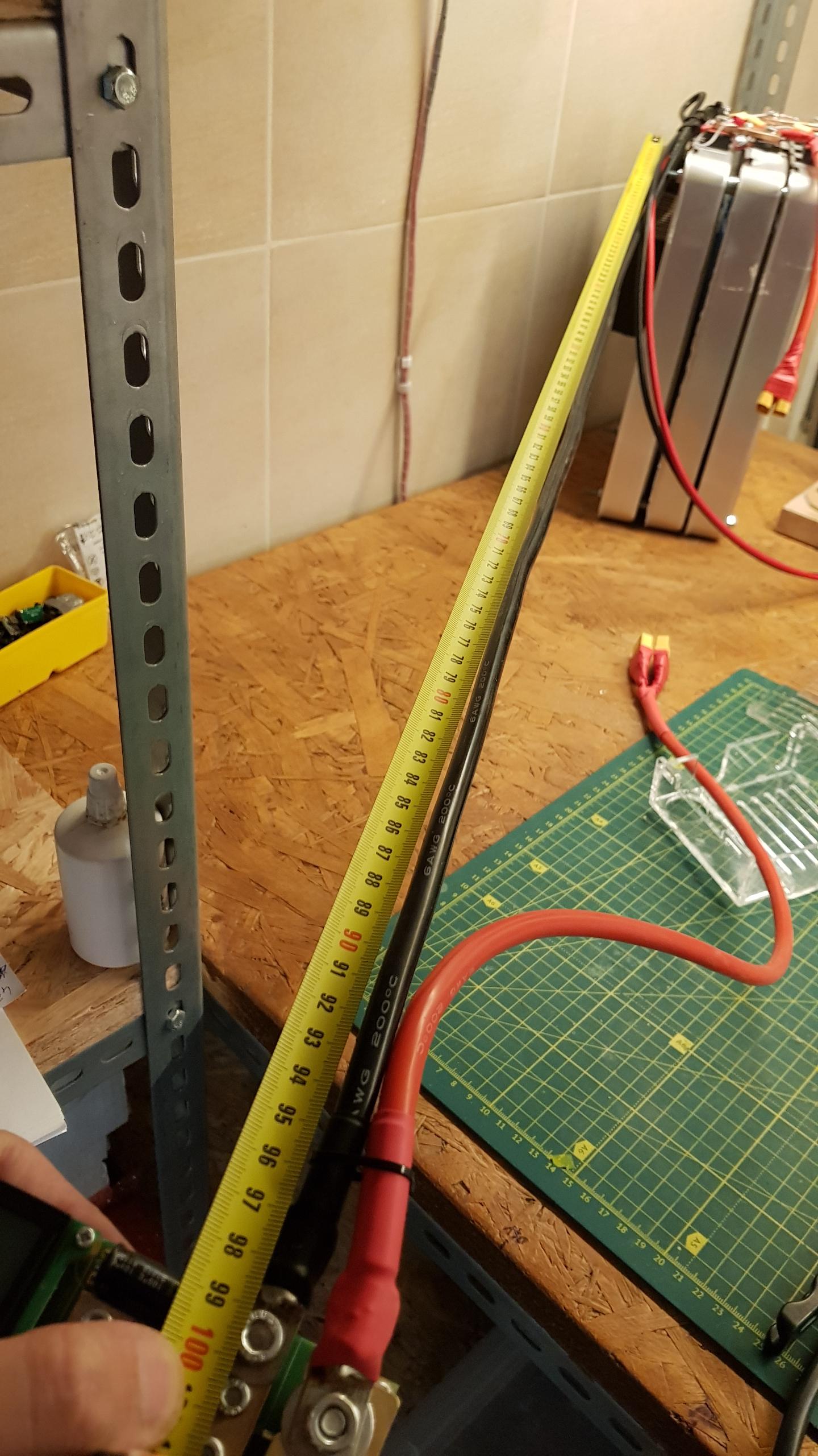

This is my (old) battery instalation, but I already disassembled it. The battery is definitely too strong ... I want to change to a 4S 4P LiFePo4 A123 2.5Ah (green) cells package. If it will be too weak, I will add more cells in parallel to get about 1400-1500A.
22.3V and 9.8mOhm... this is 2275A, and to high voltage for kWeld

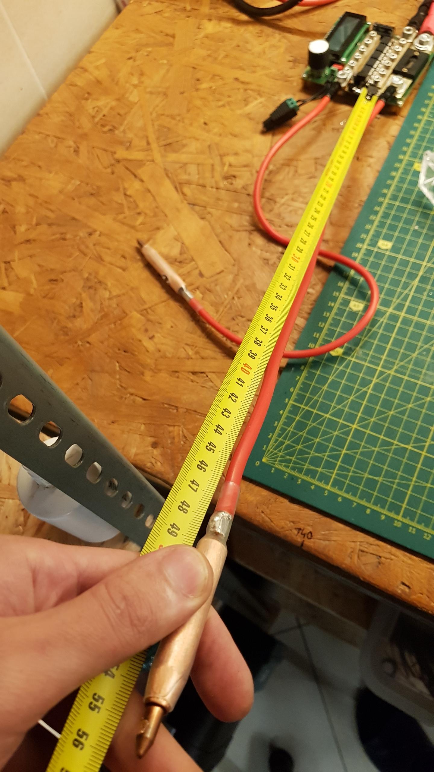

The total length of the conductors is over three meters or 10 feet? Why do you need such long wires? Are you planning to use them as a heater? :)
After all, Frank recommends trying to bring the value closer to 1 meter.
You can connect your modules in parallel, although this will further aggravate your situation, since the resistance will drop and the current will almost double.
P.S. However, I did not pay attention to the fact that there are three modules and not two.
Nevertheless, if you disconnect one module, and connect the other two in parallel, then, according to Ohm's law, the battery is unlikely to give more than 2.3kA. You should also consider the significant drop on long wires. Therefore, most likely you will not exceed the current limit for kWeld. In any case, you can charge to a certain value, say up to 12.7 volts so that it does not exceed the threshold value.
Not sure if this was addressed to me. However, long thin wires act as a current limiting resistor. Thereby increasing the overall resistance of the system. In addition, the overall efficiency is reduced. From personal experience, the most significant adjustment to the resistance of the entire system is made by wires. The current source is 0.4mΩ, the control board is 0.14mΩ, with a total resistance of 1.65mΩ.
The SMDJxxA must be placed at the left of the unit, close to where the original part was. Put the new large TVS at its original position, and add thick jumper wires from there to the rightmost MOSFET (left 5 legs). Make sure to leave out the short tab in the middle.
When seeing your battery leads, it is clear why the TVS diodes exploded. This has been inductive kickback, make sure to read and understand the section in the kWeld operating manual. It is also crucial to configure the welder correctly - for such long leads its max current is probably rather in the region of 1200 amperes only.
Or put differently, as you were pushing more than 2000 amps through the system *and* have very long leads, the amount of stored magnetic energy becomes *very* large - probably in the order of a hammer drill punch or a cariac defibrillator shock.
They do, but they also represent an inductor. And that is what then kills the unit 8)
Inductance will create a voltage spike in the circuit when the current is stopped.
I don't know the exact length of leads that begins presenting a problem, but...two leads of a half-meter each is perfect for low inductance.
To be able to reach the center of a large battery pack, I recommend making a shelf that is roughly 6-inches above the workbench, and this shelf can hold the kWeld unit and power supply.
This way, a large pack formed out of 18650 cells can be moved around with ease, underneath the welder, just a short distance away
If long wires are really needed, it should help to twist them together, but I Guess that is an at your own risk kind of thing.
