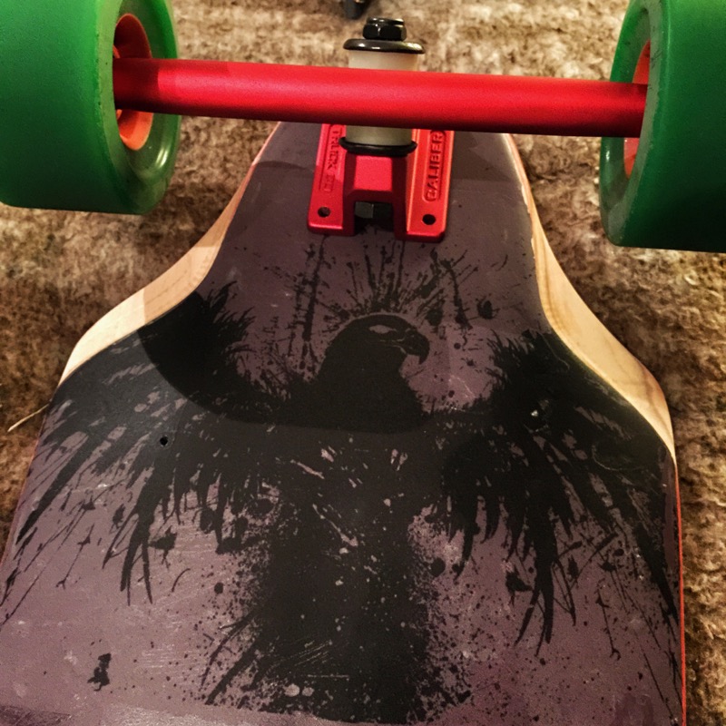

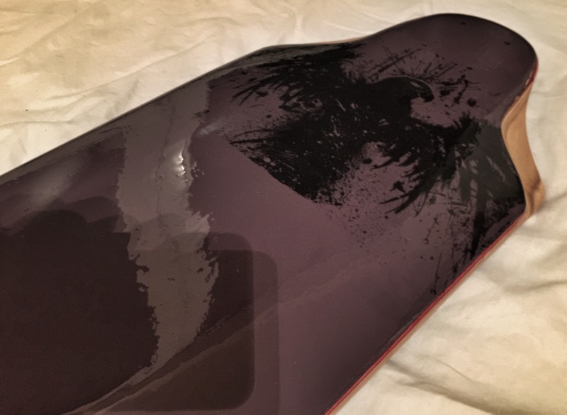

3.) finally I sanded down the board to 7ply maple (from 8) to get slightly more damping by flex. at the same time I was tired of the oiled wood look, cause after very short time it was completely messed up from all the stuff I ran over - looked for a dark color this time and while thinking about how to get graphics on it, I found something REALLY cool: photo transfer potch!! :mrgreen: basically you can print out graphics with a laserprinter (even in color), use this fluid on your surface and on the printed paper, "glue" it on your board or wherever you want the graphics, then use a hairdryer on it for 10min, finally soak it with water and rub off the paper -> done.
directly after soaking and rubbing off the A4 paper:
and now with glossy yacht clear coat:
the graphic is cut off directly where my battery enclosure starts, so the cut off wont be visible. im pretty happy about it - a very simple and very cheap way to get cool graphics on your board for those of us who arent banksy :D

after fiddling with gt2b vs wiiceiver 2.0 a little bit, I sanded the board down again and started repainting with a more mud & dustfriendly color :p

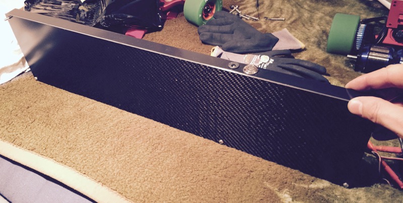

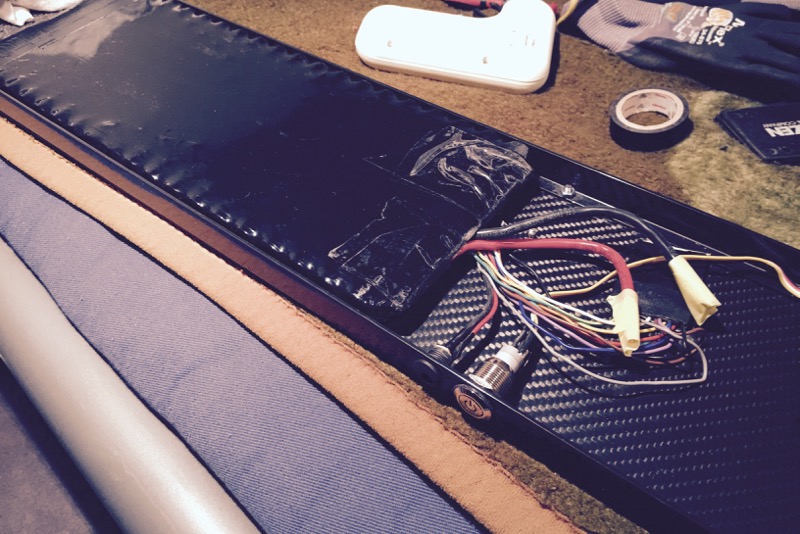

meanwhile I finally started working on a new enclosure ... or more like a refinement of the old most simplistic one: ordered a 600x150x2mm carbon plate and some 20x10mm aluminum L-profiles of 2mm thickness. wanted to use those to cover the electronics and to allow mounting of charging port and power switch. the whole thing looks a LOT more refined and it will be attached as the old enclosure by the 6 rubber cylinders. this time they wont be visible anymore though, since they will be inside the aluminum profiles.
very tidy roadside look - will complement the upcoming new carbon grey metallic look of the board :)
from the inside most electronics are missing yet, but its a perfect fit for the battery. the aluminum profiles have a 2mm height and the room below the battery is filled with 2mm felt sheets for damping and so that the battery wouldnt sit on the L-profiles only.

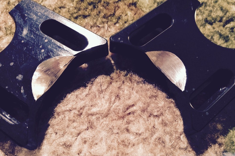

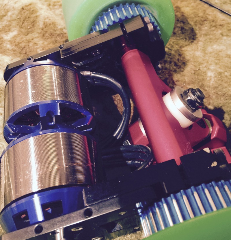

finally went ahead and made the necessary modifications to torqueboards motormount (thank you okp for pioneering!). it hurt quite a bit to eat away on the great looking mounts ...but it helped that they were chipped and dented already after heavy use. :p
currently, if the cables exit the motor the way they do on the enertion r-spec, and if your engine is 63mm AND if you run a minimum length belt so that the motor sits as close as possible to the truck, then there wont be room for the exit cables on the current construction. that basically only leaves you with 3 of the 4 possible exit directions of a motorwire: boardside, enclosureside or roadside. all of these positions have obvious flaws: boardside means, your mount has to be positioned further to the road than neccessary and your cables will constantly rub on the board. enclosureside is ok, but might increase the gap you need between trucks&motor and enclosure AND you need some wire length to allow sufficient flexibility when you turn - so where to put that cable then? finally roadside is a nobrainer - who wants the cable pointing towards the road where its vulnerable. :|
the hands down best exit strategy is "truckside", cause you can bent the wires in a smooth turn, allowing enough cable for flexibility in turns, but at the same time you can adjust the mounts angle so the motors sit as close to the board as possible while at the same time the cable is protected by trucks and motor from whatever youre riding over.
used the dremel to sand down a smooth exit path for the motor wires:
and thats how it looks in the end:
thanks again okp for pioneering and lowering my threshold to try as well. :)

sanded the board down from 8 to 7ply maple for some minimal flex increase. at the same time I also flattened the middle section by removing parts of the 7th maple ply - roadside you cannot see anything of the w-concave anymore, so hopefully the new enclosure will look even slimmer and more integrated than before. finally I spent quite some time trying to get a decent finish ... went with a glossy carbon grey metallic look and Im really happy how it turned out! will also fit the elegant carbon+aluminum enclosure perfectly! :)
Your job on this board is amazing, I wish I had your skills.
