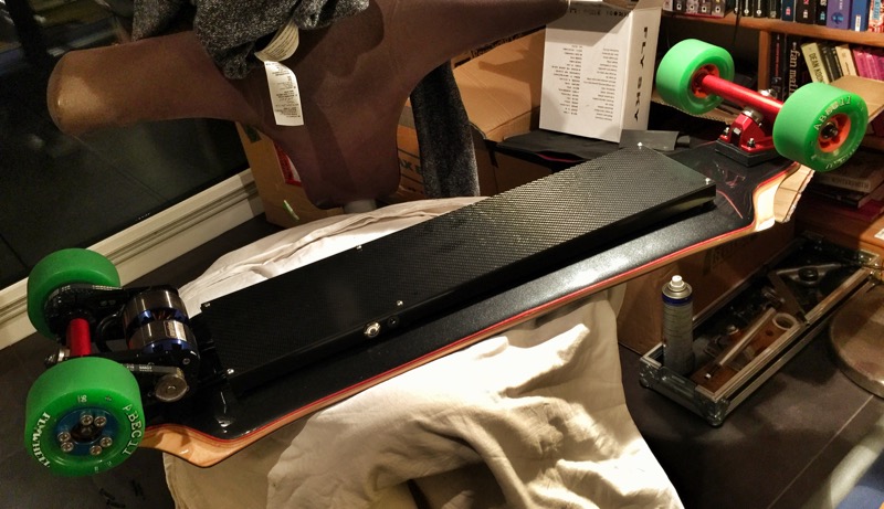

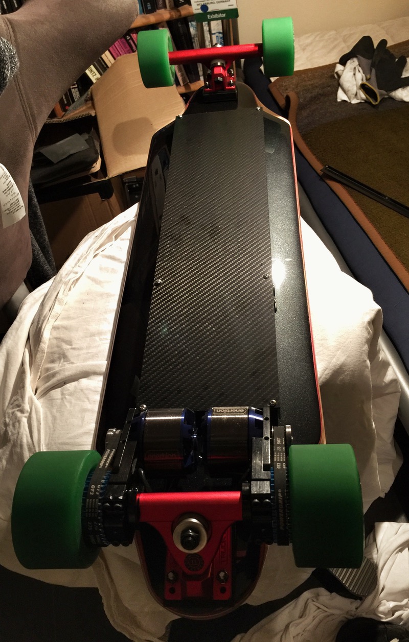

back from a weeks business trip and started to put things together again - wanted to share the snappy flex of the board after sanding 1 layer. the top speed had basically no flex before :eek:

you got a pretty good amount of clearance between the motors & the deck !
hm, the motor mount is <0.5cm from the board surface at max lean angle. there is no room for more really!

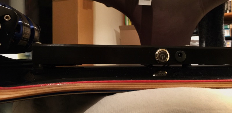

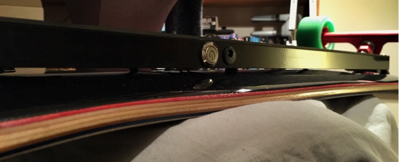

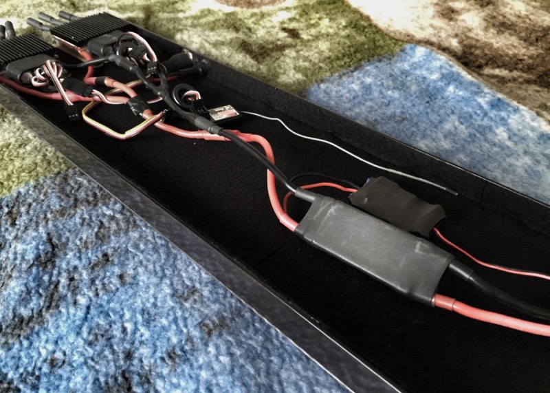

testmounted the new enclosure and it looks really cool, BUT: with the new snappy flex, the enclosure with the aluminum profiles actually puts the rubber mounts under a lot of stress because the enclosure is now very stiff while it just bent with the board before the aluminum profiles.
I accounted for rocker with some rubber washers, so the rubber mount is actually longer at front/rear and short in middle. what happens now when the board flexes: the front/rear rubber tube is stretched, the middle one is compressed. it worked well so far, but Im not sure for how long? :?
also it influences the way the board flexes which I really liked after its down to 7ply maple. maybe I will actually fall back to the even simpler first solution without the profiles over the whole length, but just with some partial profiles to get charge port and power button in.
Looks rad! I love the deck shape You used, it screams "I'm super fast", but the flex is the last thing I would like to have in this set up. Maybe it makes the board more comfy but as You noticed it's kinda problematic when You use long battery pack and one enclosure (instead of two, like in my busted boosted :lol: ) I would reinforce the deck with CF to make it stiff, like okp did with his vanguard, but that's just my 2 cents :wink:
its still quite stiff, im weighting 85kg and jumping up and down with as much force I can put in. even without riding it yet it feels like the perfect response now. before it felt a little like riding a wooden plank, now it stores just the right amount of energy. in the end its about carving for me, not about going 50kph (which I dont expect to be a problem either). :)
just hope that 2 extending vs 1 compressing rubber mounts will not end up with the profile midpoint touching the board. didnt think id get that much of an effect by sanding one maple layer off. :p if it works im probably the happiest whitepony in the world, cause with the flex as it is, i can perfectly tune damping with stance. usually im riding with a fairly wide stance, but for rough terrain i move closer to the middle to allow the board to take the edge off. this behavior is now noticeably amplified and it wasnt pronounced enough before.
ill make it work, the enclosure will have to follow the riding experience, not the otherway round! :D
just returned from a 30km tour with the biggest grin in my face (despite all the leaves and twigs that were on the way :evil: ). the flex is PERFECT! it really helps with the damping, especially when I take on the narrower stance like in the video, but feels as precise as it used to when I use the wider stance and carve hard. if i carve more in an easy going way I can use the narrower stance again and play with the energy in the flex, love it! 50kph is no problem ... as expected - in fact I couldnt tell the difference at max speed between 7 and 8ply maple. also, the aluminum profile is NOT touching the board surface at its midpoint, so it seems to be working out with the enclosure vs. boardflex. even took a few sidewalks and sidewalk->road transition to stress the board a little. seemed all fine!
one thing I still need to improve though: the carbon sheet can rattle against the aluminum profile on very rough ground or flagged floor. only got 3 screws per side and 2 of them mark start and endpoint of the battery. either I add a few tiny screws or maybe I just glue the profiles to the carbon?
It seems like it might be good if the box was split into two sections so the board could flex without over stressing the connections holding the box. If you landed real hard, seems like the middle of the board would bottom out on the box, possibly damaging something.
mhm, im afraid of that too but today I pushed it without running into that issue (didnt even get close, else I had marks in the finish). only time will tell if the rubber mounts will keep up with the stress though. so far Ill just enjoy the sleek looks and well, if something breaks Ill fix it. can always split as a last resort. :)

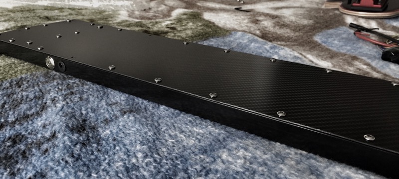

took this weekend to remove the rattling from the aluminum profile vs. carbon plate. there is a double adhesive tape between profile and carbon sheet now, combined with a row of additional screws. ontop of that, I extended the use of felt on the inside.
the "enclosure" lost some of the sleek beauty due to the million screws now, but dont think there was a another way to remove the rattling:
One other thought was if you moved the rubber mounts in a few inches from the ends of the box, you could accommodate more flex without breaking the mounts.
Looks really nice.

I also think with the aluminum profiles, I could reduce the number of mounting points from 6 to 4. these 6 are still a remainder of my initial fiber plate enclosure without aluminum profiles.
I strongly doubt that Ill ever need to worry about these mounts though - earlier I tried to intentionally brake one of those rubber cylinders ... its NOT easy at all. :)

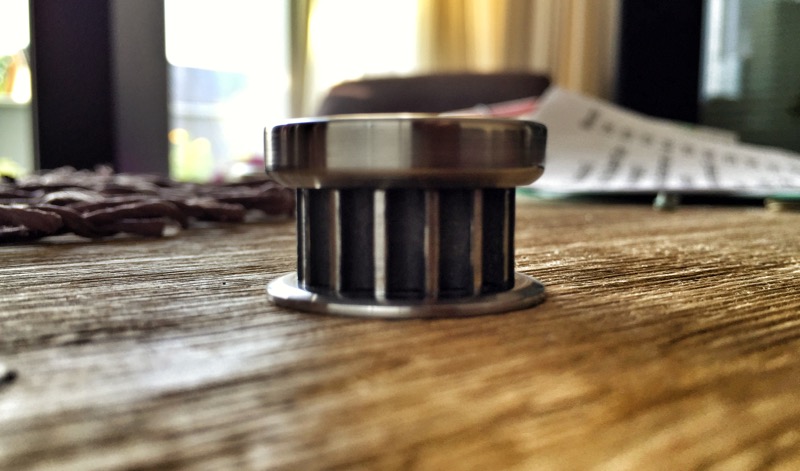

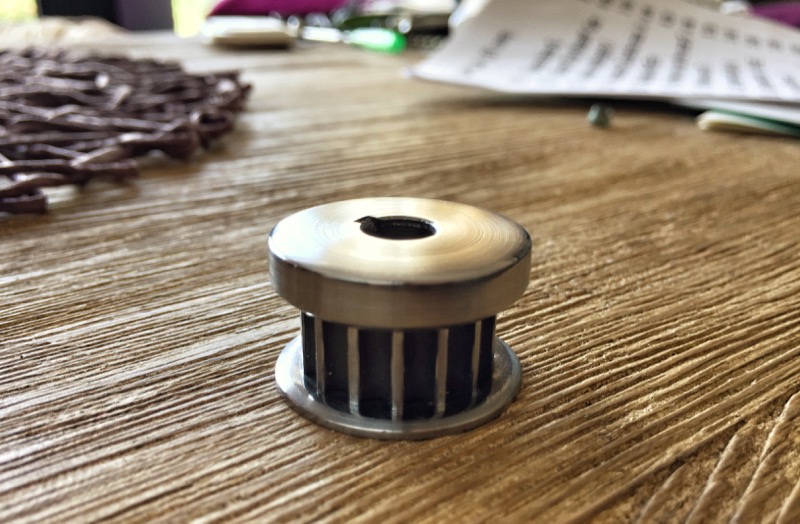

waiting for parts is lame :p wanted to fiddle anyway, so I decided to use my grandpa's self-made lathe to upgrade the pulleys to "precision" pulleys with a really beautiful brushed surface. also smoothed out all areas where the belt will touch! :)
Awesome Board Whitepony , Great build ! , love your battery pack also !
Where did you buy your motor gear, ..and do they make them in 15mm wide?
the pulleys came from enertion with the r-spec motors in black finish. I used a lathe to turn them into these shiny gems. :)
dont think they are available in 15mm ... torqueboard has beautiful blue anodized 15mm versions, but you'd need the right motor for the width of these pulleys.
