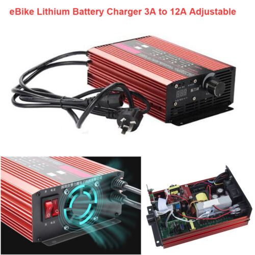

If you go this route, or just the bulk charging route, this charger has been great. I charge at around 7A-8A or so normally, but it will charge up to 12A; not as fast as an RC charger, but still pretty fast. The only issue I have it that you can't dial down the ending voltage, so I manually shut if off when I hit 83V.
