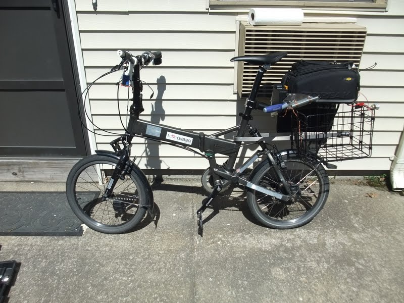

My first impression is this will be a great addition to my workhorse, pedal-only commuter. Over the last year I've gotten into good enough shape that the 360% gear range of the NuVinci is not enough. I hit the top end more often than I'd like, but I don't want to raise the whole range. There are still some hills where - if going uphill and there's a headwind - I cannot handle.
So, I dropped the hear range just about 20%, and added the Speed Drive. Normally I'll use it in 1:1 ratio, where per my initial impression there's no more drag on the drive than a standard BB. But in places where I have a decent downhill, or tail wind, I'll pop the button and use the 1:6 ratio and its higher gearing.
Here's the finished bike - it really looks no different than it did when I started, of course.
When in overdrive, you can definitely feel the gearing. Meaning not just that I can feel the amplification of my stroke, I can actually feel mild vibration from the planetary gearing. We'll see if that remains so after a few hundred miles, maybe the gears will "break in". Since I ride about 200-300 miles a month on that bike, maybe my best move is to leave it in overdrive unless I need the low end for the first month.
Anyhow, I'll be doing a write-up of the rest of the installation - but I wanted to get my first impressions out there right away!

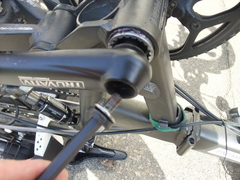

The rest of the install:

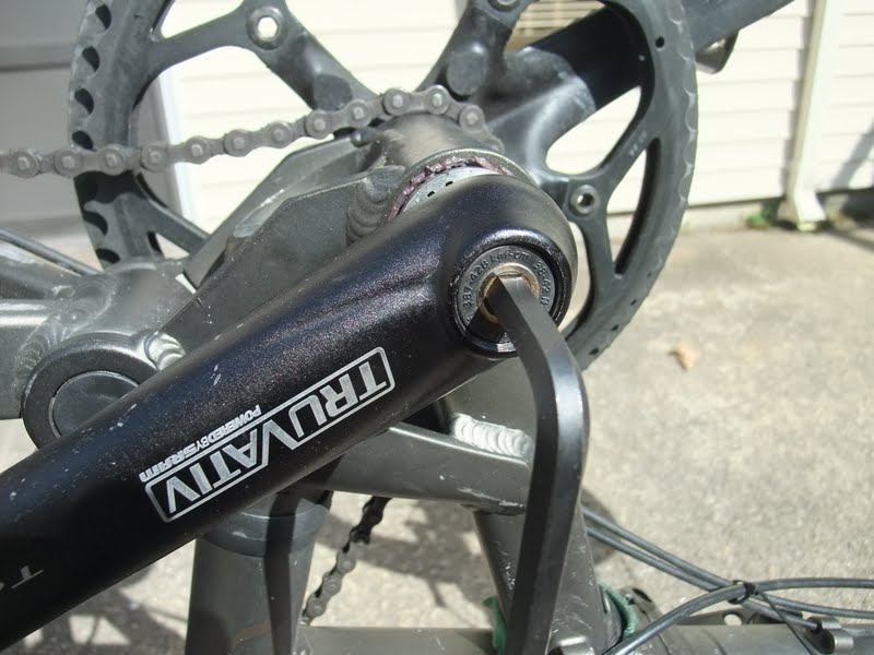

First remove the existing BB. This was easy because I just had the BB off a few weeks ago, to machine the BB shell. 6mm allen wrench takes off the crank bolt:
Easy as pi

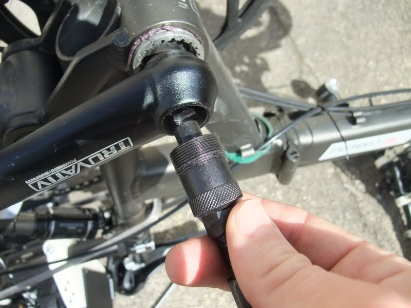

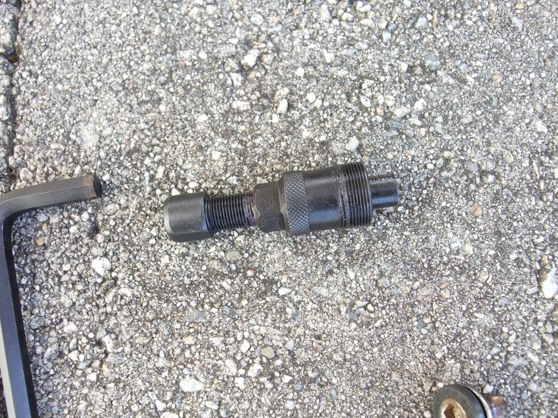

This crank removal tool was one of my best impulse buys in recent memory
Make sure the inner piece is backed way out. Then thread it into the crank all the way until it bottoms, then back off a half turn.
Now use a 6mm allen key and tighten the inner piece. Some crank parts have left threads on one side and right threads on the other, such that you tighten them as pedal. Not so with these bolts, they're the standard right hand thread on both sides. With this tool the crank arm comes off really easily.
