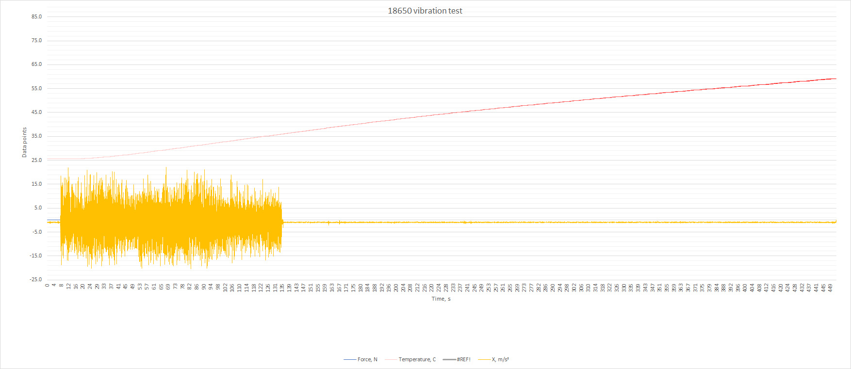

Just did a test on the module. Welded some stainless wire to stainless flat bar, was going for 120A but got around 80A constant. It held good, cells went to 60C realm. Too bad my pressure sensor got ripped. My video is still rendering and will be available later but here is collected temperature data:
[youtube]qmdiBf__BYU[/youtube]
I am really impressed how these modules held up. The cells are rated 20A max so they held pretty good as well, althou i wish it was 120A :) Will weld some more wire and see if i can bump it up.
Anyway, it is visual confirmation that my spec'ed 50A nominal is not vaporware ;)
P.S. note i disconnected my shaker, cause could not get proper reading of temp and it was riding across the room like mad and i could not move camera to point to different bits.

Wow. I played it in slow motion...
From start, fresh of the charger, voltage drops from 4.134V to 3.440 V while drawing 113.9 A at the moment you close the contact.
INITIAL (100% SOC) :
Voltage drop (dV) = 0.694 V
Current load (I) = 113.9 A
So R = 0.694 V / 113.9 A = 6.093 mOhm DC (for a 6P pack of ??? HE2 ??? cells with all conductive parts)
Heat lost from that resistance : dP = dV x I = 0.694V x 113.9A = 79.0 Watts (for whole pack)... The remaining 391.8W go straight into the load (nichrome or motor).
Considering your pulling an incredible 470.8 Watts from JUST 6 CELLS, the heat loss are VERY MINIMAL.
This goes to show you battery holders and conductive parts are really high quality and low resistance.
6.093 mOhm for 6 cells (+ conductive parts) is equivalent to having 36.6 mOhm DC internal resistance PER CELLS !!!!
If your cells are HE cells, there probaly rated around 30 milliOhms DC (or mayber araound 15 to 20 mOhm AC 1kHz impedance), I dunno,
But it's as if your solderless kit and it's conductive parts were all resistance-less and it's only the internal resistance of the cells themselves that account for the resistance of the whole system.
I'm honestly impressed. Don't think I could have done better even if I had the equipement and time for the R&D. Bravo!
FINAL (Almost 0% SOC) :
Voltage drop (dV) = 3.359 V (still some hysteresis would probably go up to 3.50 after five minutes rest) - 2.892 = 0.467 V
Current load (I) = 75.9 A
So R = 0.467 V / 75.9 A = 6.152 mOhm DC (for a 6P pack of ??? HE2 ??? cells with all conductive parts)
Heat lost from that resistance : dP = dV x I = 0.467V x 75.9A = 35.4 Watts (for whole pack)... The remaining 254.9 W go straight into the load (nichrome or motor).
6.152 mOhm for 6 cells (+ conductive parts) is equivalent to having 36.9 mOhm DC internal resistance PER CELLS !!!!
Anybody tried to measure the DC internal resistance of these cells HE in the past (im not talking about AC impedance here).... I mean mesuring precise voltage drop and amp load with beefy 00 connectors to each poles of one single cell...
If we know, we'd able to precisely quantify just how low the resistance orf the NESE kit is... The future looks bright !
