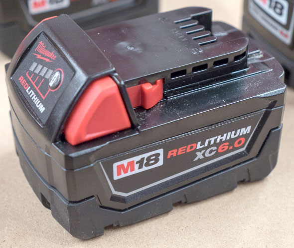

Not sure if this has been mentioned or not, but both Ryobi and Milwaukee are planning to release 2 new 18v batteries.
There will be a 6.0Ah and 9.0Ah pack. The 9.0 pack adds another row of 18650s for 5s3p. 6.0 will be standard format 5s2p.
Just 3 of the 9.0Ah batteries in series will be 54v (63v charged) with 162Wh each for a total of 486Wh. Wow...
Should be released this fall.

Now if Ryobi can bring those 6.0Ah packs in a $100 2-pack, that will make it a very compelling buy for me. Just need to find a way to made a good connection to the terminals and prevent overheating.
The tops of 2 of my current Ryobi 18v 4.0Ah have melted while being used in my tools. Namely, the angle grinder. Prob due to poor connection design.
That is why I used the Mil packs on my bike. They have a far superior connection.

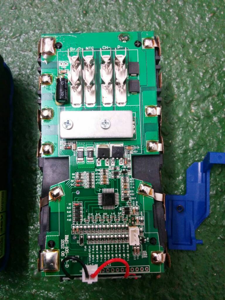

I'm surprised that there aren't any examples of RC power boards / mountain boards using cordless tool batteries. 18V, 24V, 28V, 36V...a system that uses a battery that can be purchased at any large hardware store, and comes with a warranty? I would use these just to transfer the liability to some other company. Without the battery or charger, there's no part on a power board that's dangerous (other than crashes...here I'm talking about home fires)

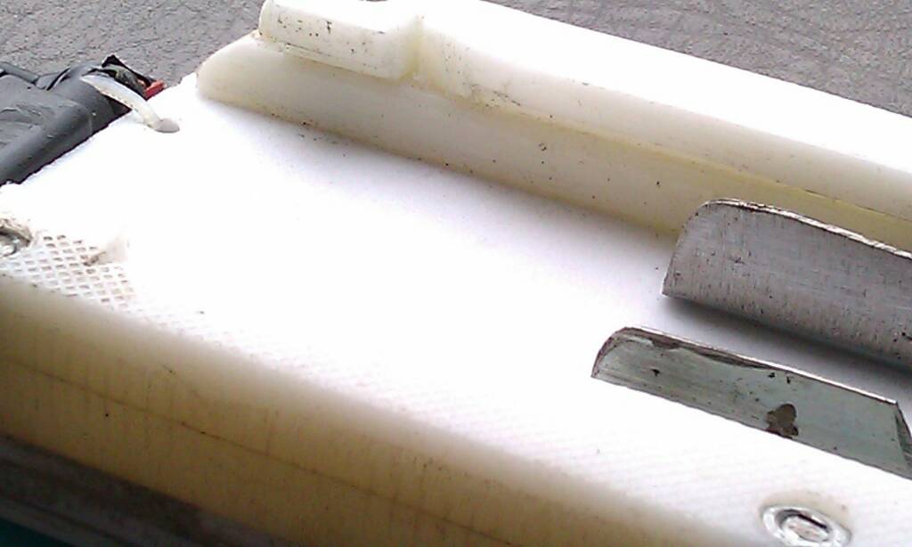

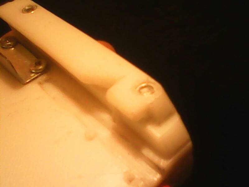

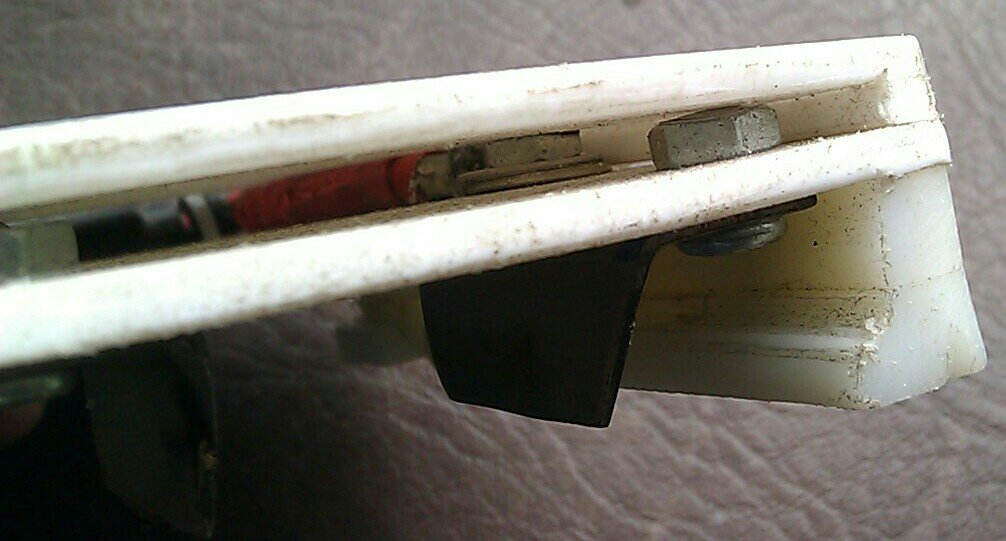

B&Q UK diy store had these 36v 4ah batteries on offer at £34 each with a charger.
I made connectors for them using kitchen chopping board.
this seems like a great idea. Can you show a better picture of the cuttingboard connector? Dual use batteries!

You can always get a 10% coupon from ebay as well. I'd rather use higher capacity packs, but the price is nice on the 2ah version. I'm working on a way to build out a connector rail to make some 48V packs (8ah--4 x 4ah packs, or 10ah--10 x 2ah packs).

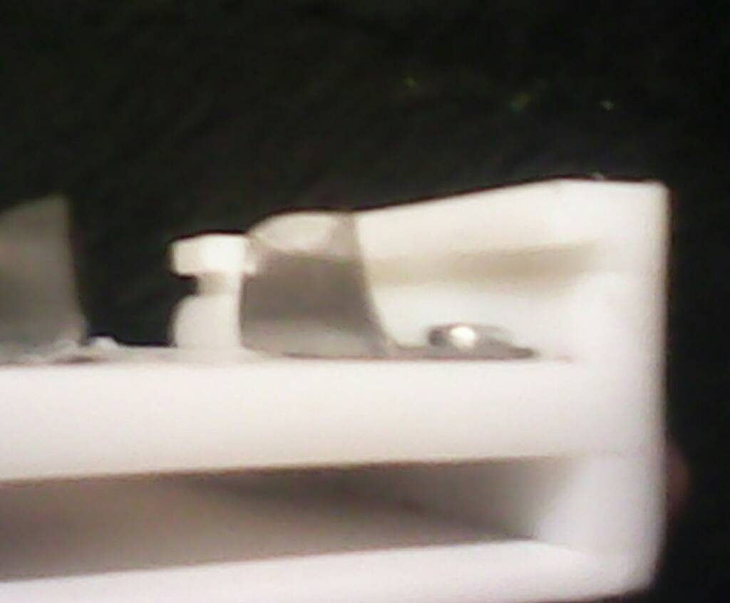

wooden prototype shoots off battery when release pressed.
wompus said:
I like it. Someone with a 3D printer could easily make something similar and easier to replicate.
Yes,I made mine with a hacksaw and razor blade.I was tempted to modifiy two of the chargers,but I thought I would be better off with the chargers in different locations.Two 45 miles away and two 75 miles

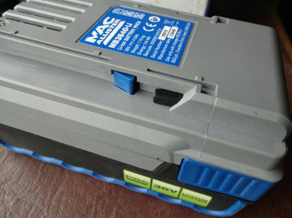

I have 2200 miles on my 6 Mac Allister 4ah in a year and a half.I was told on the pedelecs fourum small battery bargain thread that you could take the BMS off one battery and join to another to make one 8ah.
I wanted to do this to slow the charge rate down.I decided against this due to the batteries been under a 2 year warranty.I may do this when it runs out.I could then get rid of the cases to save weight and space.I do like the protection the case offers though.

Thanks for the pics of the plastic cuttingboard battery case 'craiggor'.
Still hard to see what your metal connectors are made like though.
The plastic is a great idea because it's easy to shape with cutting tools and maybe also use a torch to shape as well.
Wood is also easy to shape with dremel tools etc.
The ability to make a snap and lock in case for it to mount on the bike is good and also lets you be able to use the batteries in power tools still.
