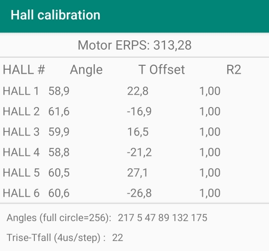

Haven't made a test ride til now, but here are my calibration values (36V motor driven by 11s battery):
These are almost identical values ​​to those of my motor.
Let's see if any more data arrives.
I remember to find the hall sensors reference and datasheet - anyone knows what is the datasheet for the hall sensors? - because maybe this are just defined delay times for signal turn on and off, on the hall sensors datasheet.

It could be, or maybe there is some electronics in the middle that filters the signal.
I don't know, I've never dissected a controller.

Here is the result of my hall calibration.

My hall sensor calibration with a 48V motor and 13S battery:

Here are my values with 48v motor and 13s battery.

Thanks to those who shared the calibration result, both here and on the Italian forum, I see that the average value of the delay of the Hall sensor is quite constant.
However, there are some that have a fairly pronounced variance, probably due to hall sensors with different sensitivities.
I have therefore released a new version where the calibration, instead of calculating a single average value, calculates the delay for each state of the Hall sensors and a new firmware which then uses the calculated value for each state.
For those who have had quite different absolute values ​​of T Offset in the calibration, this new version will bring benefits but will have to re-calibrate the Hall sensors.
Again everything needs to be updated: Android application, ESP32 firmware and motor controller firmware.
As usual the files are on Github: https://github.com/TSDZ2-ESP32/TSDZ2-ESP32-Wiki/tree/master/bin
