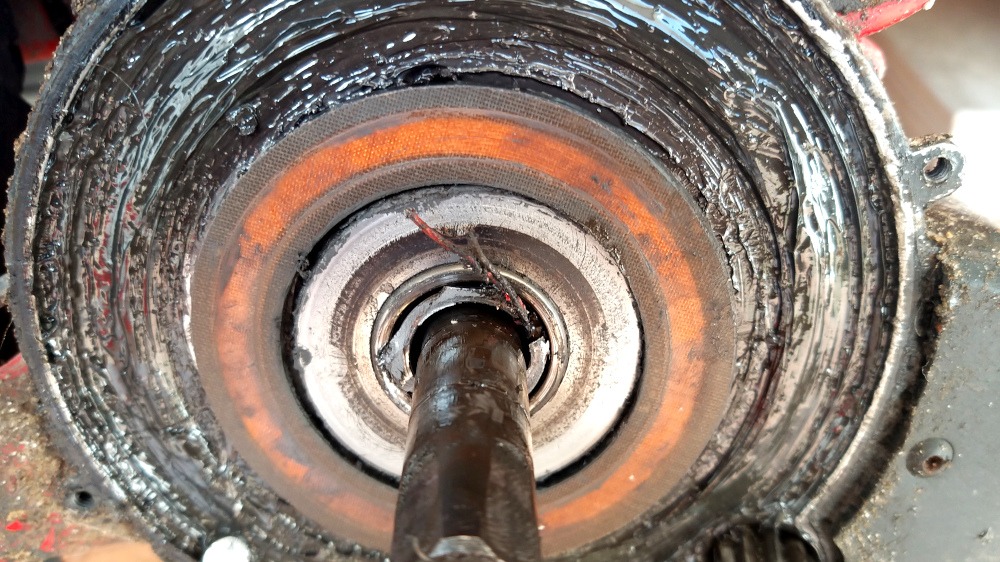

Hello. Could someone tell why my motor start having a little wobble in the botom bracket. The motor is new and only has few hundred kilometers on it. Motor shaft is slightly moving. What is the problem? Is it the bearings? Motor itself is well attached and cranks are properly bolted. How to repair?
vshitikov said:
Hello. Could someone tell why my motor start having a little wobble ......How to repair?
That wobble is a wellknown problem of this motor with Chinese tolerances. The axle is a bit too thin for the bearings.
Here I have shared some links for a solution, with adding a second bearing and some thin metal sheet.

To describe exactly what I can feel:
I can feel no lateral movement in the axle (ie nothing at all on the green axis). There's slight rock in the cranks (blue axis - not enough to see, but I can feel it bump when I push and pull it), and a good mm of play on the cog (red) - I can see it rock side to side when I rock it.
Those instructions look like they would fix play on green, but not my blue and red?
Cheers
Rob
Cheers
Rob
You can put another 6902 bearing on the left side of the axle, like in the picture below (taken from the OSF FAQ depicting older vs newer axle type). This stabilizes the axle to some degree, although did not eliminate the play completely for me. Also make sure the lockring on the drive side, below the chainring spider, is properly seated. I had a loose lockring on a new motor that lead to increasing wobble of the chainring.
