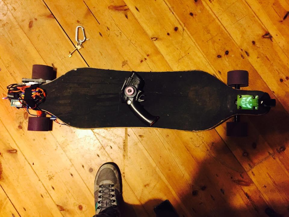

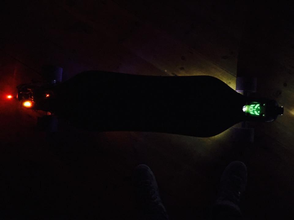

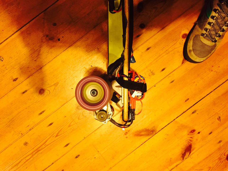

Hi there, my first build he he.
Specs :
ESC :Turnigy TrackStar 150A GenII 1/8th Scale Sensored Brushless Car ESC
Motor : Turnigy Aerodrive SK3 - 5055-430kv Brushless Outrunner
Battery : Alien 6s lipo 8000mah ( that Bruno guy is great btw)
Motor mount and wheel pulley(36t) from aliendrivesystems (personally i think that a mount is overpriced, if only i would be back home in my garage...)
Motor pulley (15t) from beltingonline
Magic stick :) : Quanum 2.4Ghz 3ch Pistol Grip Tx & Rx System (works great, only thing annoying me is that i need to speak with security in shops about what i have in my pocket, and evade crazy drivers on the road who things that im carrying a gun)
Wheels : 80mm kegels orangatang
12v CAR CIGARETTE SOCKET (wow) for those dead phone battery days you all know xe xe
Cheap leds, leds, and some glowing phosphoric stuff.
Range: dont want to lie to you guys, but here im not sure, i still need to keep eye on that, but i would say, looking at google maps and counting miles i get something like ~9-10miles ( im accelerating and braking like a sick bastard)
Speed : I looked at my phone it was showing 42kmh (~26mph) and then i fall off and started making that noise of pain (way too much, in future will go for something with less kv)
Enclosure : had to rip off one side of my pc case and use metal scissors for that, some bending and screwing and bingo, battery hopefully is safe now.
Weight : 5.9kg
Now, i want to do more like an offroader board (mountainboard) but will wait, short on money... ;(
Thanks for everyone, i learned a lot from endless-sphere!

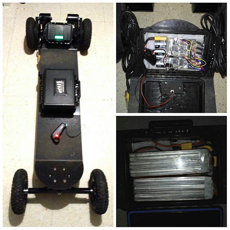

Heres my board.
MBS Core 90
MBS Vector trucks
Kenda K909 8" tires
MBS Rockstar Pro Hubs
Used snowboard bindings 2 sizes smaller than on my snowboard.pulled the back plate off.
Custom motor mount and hub/sprocket mounts my buddy welded for me out of 1/4" 6061 Aluminum
2x Torqueboards 6374 230kv motors
2x Torqueboards 12S ESCs
torqueboards mini 2.4Ghz remote controller
Torqueboards antispark power switch(and soldered in maxi fuseholder in place of mini)
cheap ebay digital voltmeter
4x ZIPPY 5A 20C batteries (2x 6S5A packs)
waterproof case off ebay
#25 chain drive
5:1 gearing
1 motor on 6S 14mph
1 motor on 9S 21mph
2 motors on 6S 17mph
2 motors on 9S 22mph
I havent maxed it out on 12S yet but my max speed was 25mph and i started getting the speed wobbles. Ill try again with the trucks tighter.
Its pretty torquey on 6S. 9S is faster/more fun and 12S is trying to tame the beast. It climbs descent size hills and runs through grass. Usually traction is a bigger issue than power on the hills. Probably cuz of the tires but they should last longer than stock on all the pavement. The battery box came with the foam so i spent alot of time carving room for everything in that. I changed all the connections to 5.5mm bullet connectors that werent already. If I want to bump voltage up I can connect batterys together. The hardest part was drilling the sprockets right with hand tools.
