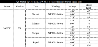

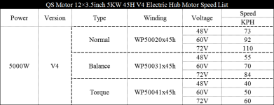

12*3.5inch 2kw, 3kw and 5kw V4 hub motor
4 different color available
Different speed choice
Reference link: https://www.aliexpress.com/item/4001237703829.html?spm=5261.ProductManageOnline.0.0.1d754edf0fp96h
