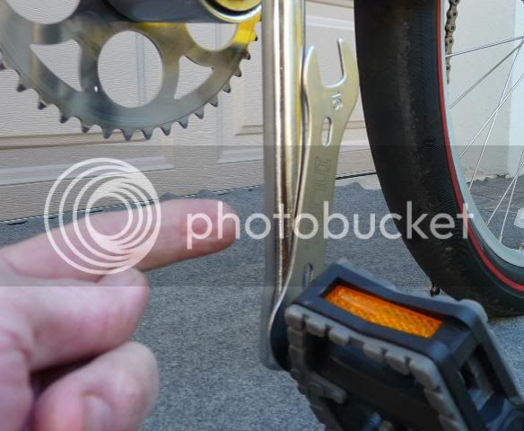

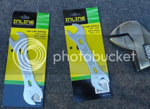

All the wrong wrenches for the right job. Those cone wrenches are not for breaking loose thick nuts.
Crescent wrenches are third rate at best.

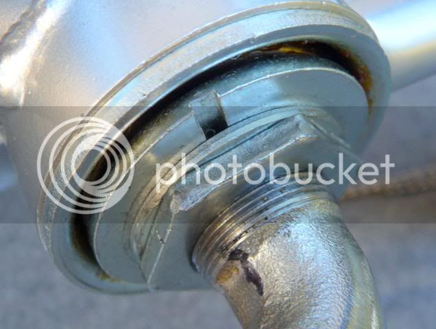

Left pedal, left hand thread: use a strong wrench to break it loose, then spin it off with fingers or a cone wrench, as you like.

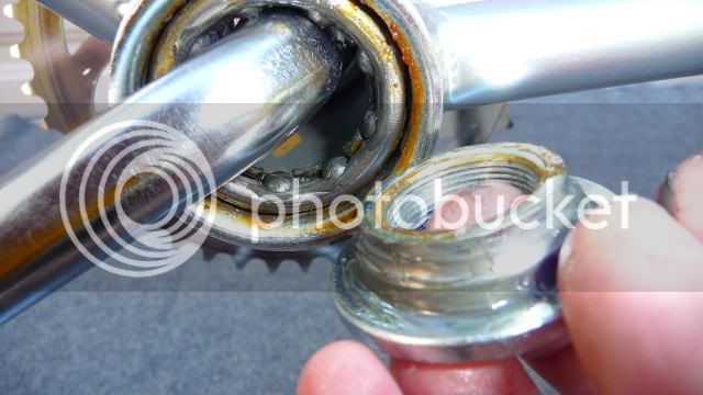

Left hand threaded lock nut, fixed (anti-spin) tabbed washer, adjustable cone. Trial and error in their clamping-adjustment.

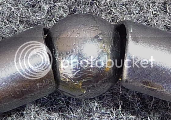

Gray grease: wear products, mostly from the soft steel bearing cage (the balls rub against its edges, especially when new).
Fissures in a ball: as it was made. Will cause some rolling noise. We only hope for truly round balls, all identical in diameter

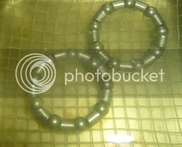

I got this tiny ultrasonic tank in 1971. It's still handy for micro-scrubbing small parts. See the dirt floating away?
