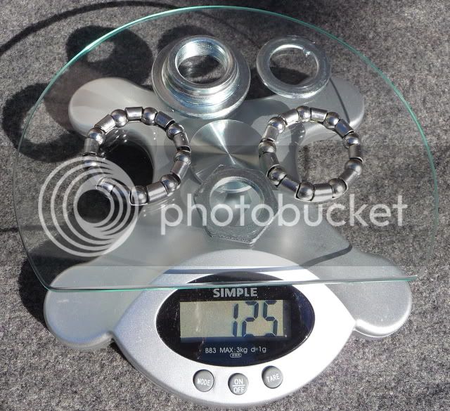

i haven't seen bearings like that since i took my bmx crank out in 1985 :) is yours a one piece crank too???
on the upside you can at least inspect and regrease your crank bearings - i'm no expert (as you've probably guessed) but the sealed crtridge type are just that,sealed.
i guess they are far less prone to dirt and water penetration??? better? i guess for that reason alone?

You got your pedals off with a cone wrench? Man, I use vice grips for that. I'd pretzel cone wrenches trying that stunt.
Nice thing about OPC is you can pickup new bearings for like fitty cents... Gotta love the cheap inline stuff, I replaced the press in cups, bearings, crank, everything on my 1968 OPC BB for twenty bucks. And I bet they last another fourty years, they can keep the fancy sealed stuff!

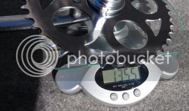

Must weigh the forged crank and ring assembly: it is heavy!
Sealed bearings, cartridge bearings "best"? It might be open for debate; again,

...is yours a one piece crank too???
Yeah, it sure is, and it's mighty weighty:
one point three kilos
And that's a big plus for my book.

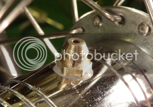

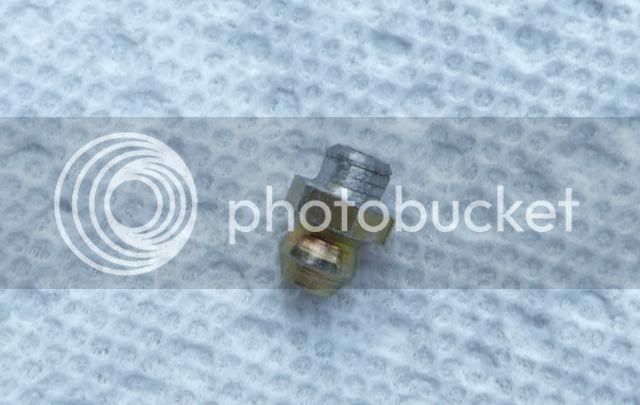

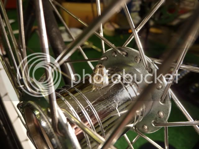

Am going to SEAL the bottom bracket from water intrusion on a later day
(the video to come will show how), and fit a Zerk fitting so I can inject fresh grease
and thereby eject dirt and water and grit.

Thanks for your thoughts, Deecanio. About to grease the cleaned bearings right now (it's 2:45PM EST here in my Miami)
More pitchurs to come, greeeeasy. :wink:
ready for the grease...
#4: Old-School bottom bracket take-down
#5: Reassembly of the one-piece-crank bottom bracket

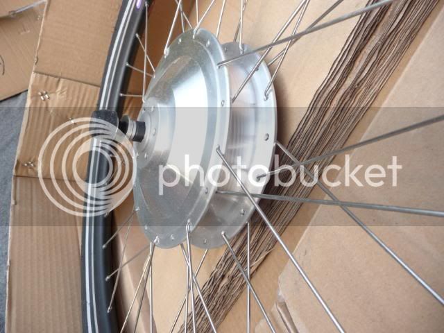

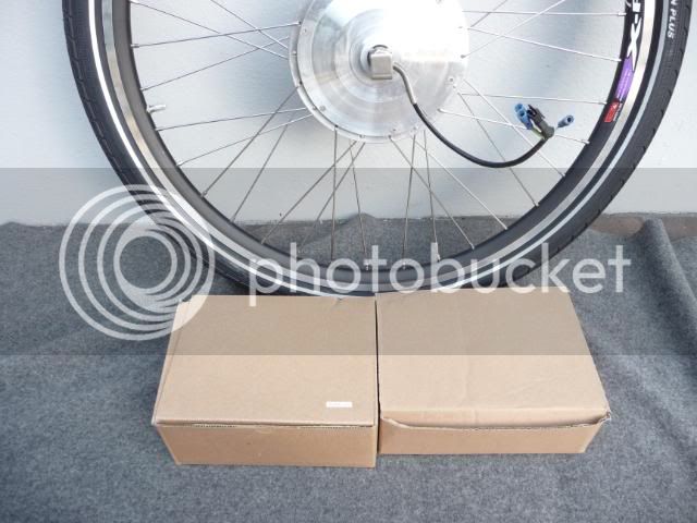

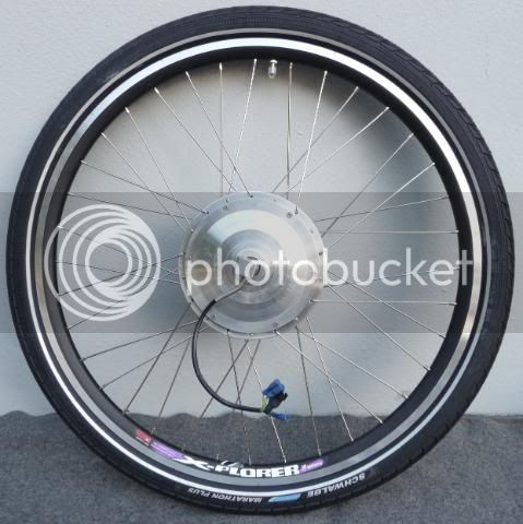

Bike will be all tuned and "perfect" by when the Ping Battery and Ezee wheel kits arrive. Then the fun will start!
How to hide the wiring best? How much of the wiring can I hide away in the frame tubing?
Aim: to make this cruiser bike as plain-bike looking as practical.

Ans: regular servicing: clean and re-grease seasonally. Or, perhaps, inject fresh grease on occasion,
just a bit of new grease, at whatever intervals you care for: the bearing will eject the excess, older grease, and need wiping-off.
And so, we might, if we so-design (grease fitting) push an ever-fresh supply of grease through the bearings, ejecting dirty (water and gritted) grease out, to the outside world, ready for a swipe-off of your wiping rag.
No lip seals, no lip seal "drag", however slight. Fear no stream fjording then; when you get home:
pump into the bottom bracket, some fresh grease.

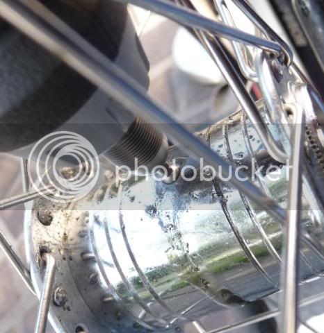

Good news for me: I =know now= that I can indeed fit a zerk fitting to the rear hub. Need only a 1/4" 28tpi tap...
This means: no more need to ever disassemble the rear coaster brake for seasonal maintenance.
:D

VIDEO #7: of the joys of learning by doing... :evil:
Owwww

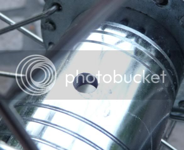

.... This blasted hub! It's not only chrome plated, but deeply case hardened steel.

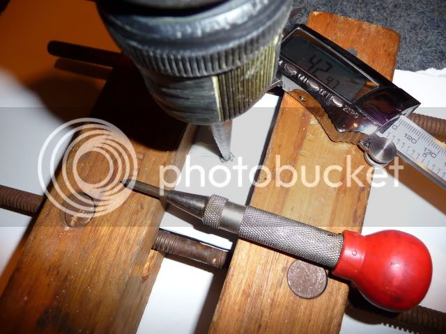

A center punch to mark the drilling place for the zerk fitting: not even a dent comes from the sharp, hard pointed, spring-triggered center punch:
So, grind and grind with carbide grit or diamond dust coated Dremel bits:
An hour of "fun" to get through the totally hardened steel:

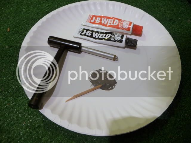

Now chuck up a zerk fitting ,and cut it short, and make it a tap-fit (with JB Weld epoxy) to the hole:
Here the parts are ready:
the epoxy has been thoroughly mixed and allowed to set up for twenty minutes
(it is a very slow setting brand). A drift-punch of aluminum tubing and a tapping hammer:
the burr slipped and skittered, oops, those reminder-marks: don't mess up like me:
Now, to speed-cure the epoxy in a couple of hours instead of 12 or more hours:
a 40W halogen desk lamp is warming the hub 150F:

Reid,
Next time please remove spokes and rim from the hub and use a drill press to drill hole.
I don't see a check ball on the zerk fitting. You planning on driving under water or something? Usually you see that done for boat trailers.
Hi Marty,
But how would a guy "drill" through a hardened file, a round one? Because that's how hard this steel is.
It is as hard as a file! And I am not equipped with experience yet to tear down and then reassemble, true-running, a new wheel. So I did it the "easy way": easy for me, a rank beginner.
D-man, right: no check valve. It's not a high pressure job; just a place to inject grease.
Will put a plastic snap cap over the fitting--they used to sell those. Or I can make one from a tire valve cap filled with RTV rubber.
I have no prior experience with coaster hubs--have only read that at one time the "grease fitting" was merely an oil hole for a heavy oil to go into. IF the hole could've been threaded, then, even a small round head screw would've served as a "cap": no "3,000 PSI" grease gun really needed: there's no resistance to injecting a light grease there, because the unit has no lip seals, nothing at the end points whereby to resist grease injection at the middle.
I used to inject grease into "sealed' bearings with that special hypo needle tip they sell for grease gun use;
but here: there are no lip seals, only flanged, outboard "shields" (not true seals), and no way to grease through those points.
So I figured: put the lube into the middle of the hub and let the excess work out the outboard ends of the unit, wiping it off as it shows up.
I got the butchered Zerk in place, secure, without "special" tools or wheelwright skills, and the hole took only about one hour to grind, total, with one each of a burr-ball, then a cone-shape and then a cylindrical Dremel-type diamond dust bit.
It's done! Today: reinstall the cleaned internals and pack in the very soft lithium grease.
If I don't like the grease, which seems to be identical to the factory grease in consistency,
I'd just compound an even softer grease, for even less grease-drag on the retracted internal brake shoes.
One can imagine why the hub, itself, is so thick and of such totally (all the way though-hard) steel:
to resist wear and deformation from the incredibly high wedging-pressure-action of super-hard steel shoes
when back pedaling.
That this system of hard steel shoes against the I.D. of a hard drum works, oiled or greased, means that the shoe pressure must be enormous indeed. So the hub is thick and super hard to resist skidding-wear;
and an anti-galling grease like a lithium grease completes the package.
I hope that a vinyl snap cap over the zerk, just to stop ooze, home made or otherwise, stays put. I think it will.
Otherwise: I drill and tap the soft steel Zerk body for a 4/40 or 6/32 screw.
and "inject" grease directly from the tapered tip of a plastic syringe, then replace the little cover screw.
But, Marty, are there "drills" made for drilling through file-hard steel....other than the burrs I used?
Would a tungsten tipped bit, like for concrete, have done the job?
How long a time to unlace and then re-lace a wheel, true, for a rank beginner?
The grease input device is "in".
It should work..."we" will find out very soon what comes of the job.
Thanks for all corrections and ideas,
R.
