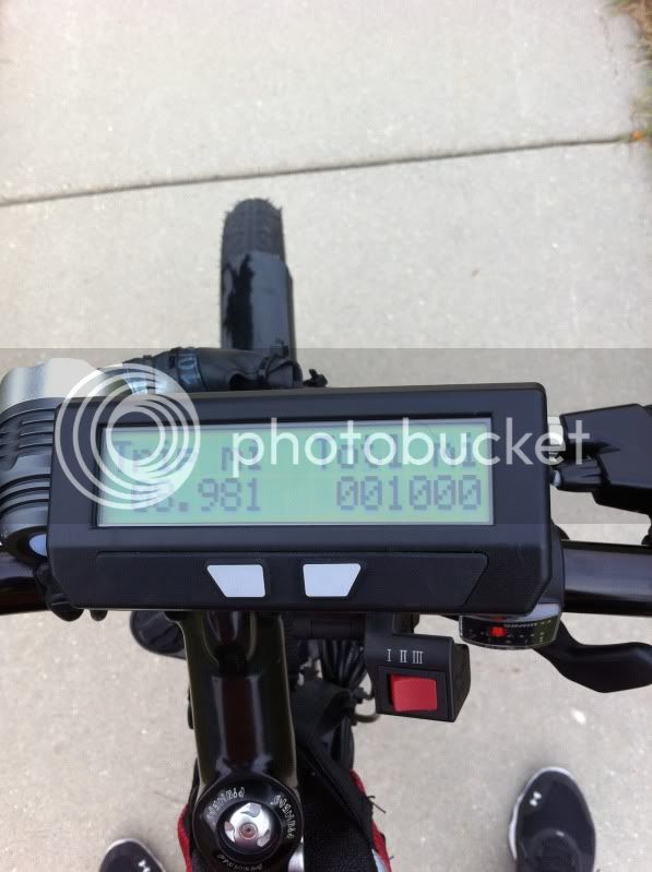

I am expecting the same kit next week from cell-man.
Couple of quick questions:
Notice you did not use the ebrakes. Was there a problem with integration or use just don't prefer them?
Also can't you get cruise control with the CA 3? Have you set it up?
What is your average range on the 18.5 battery when you are not holding back?
Thanks,
Roger
PS NICE build!!
I can confirm that the CA v3 has a cruise control option. You can set the number of seconds it takes holding a steady throttle for cruise to kick in. You then need either ebrakes or flick the throttle again. Ebrakes recommended as it's easy to forget.

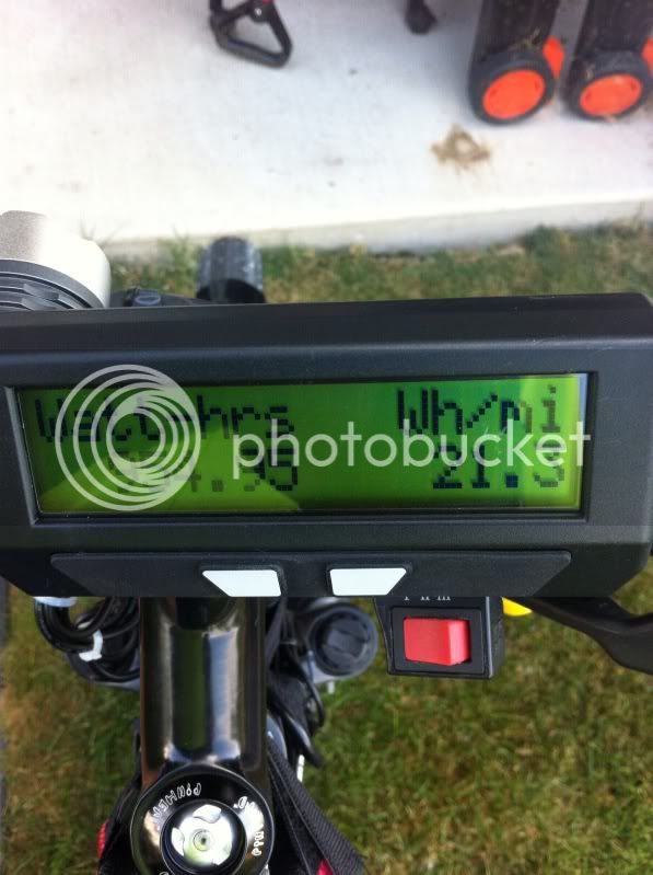

Thanks!
Sorry for the late reply, haven't been checking the forum much as its cold here and riding less.
I do use the ebrakes, I took the cell-man kit ebrakes and changed/shortened the connector on them, made a Y adapter and ran them through the CA so the CA is the only thing that interfaces with the controller. When I pull either the brake the throttle out goes low. The brakes are kind of crappy and have a lot of play so I replaced the brake handle pivot pins with bolts and put some washers to shim it up on the inside. The switch inside the brake is simply a normally open pushbutton switch that goes closed when the lever is pulled away from it.
CA has a cruise control option, but it doesn't work very well for me since I don't have the CA limit speed, only power.
My bike will always get up to about 25mph on the flat no matter what power level I use, higher powers - 25-35A get there faster and help hold that speed up hills.
(acceleration etc...) I do use the cruise control but only so my wrist doesn't get sore.
At the most inefficient high power setting I do about 35 Wh/mile which would be about 25 miles on the flat.
A lot depends on the tires, terrain and rider too. 25-30mph is scary and requires frequent checks for loose bolts and worn parts that could throw you.

I'm starting to see the lifecycle with the battery, it won't charge up to 57.9 / 58v any more - 57.7v is typical in the morning after a night of charge.
Not a huge deal, I expected for how hard I ride it, still an awesome battery.

Screens from my last ride (a night ride in a thunderstorm!):
I used about 3/4 of my battery for that. I only ever use about 3/4 of the capacity, I charge it to %90 and limit the draw to 30A (just under 2C) to preserve the LiMNC chemistry and battery lifecycle. This isn't a LifePO4 so no 2000W speed demon. Most of the time I cruise around using 9 amps (1/2 C)
I use the CAv3 closed loop throttle control, throttle controls total Power (W) used by the controller/motor.
I use a three position switch to set the limit of maximum power to 500W, 1000W and 1500W max.
