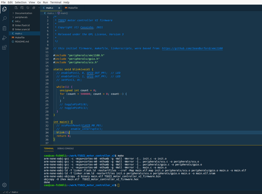

The TSDZ2 motor controller V2 is a way more capable hardware to implement FOC (ARM 32bits 64MHz VS STM8 8bits 16 MHz, and with added 3 motor phase current sensors), which will mean more efficiency motor control and less noise. Also the microcontroller manufacturer provides a ready code for FOC witth an application note documenting, so should be very fast to get it working!!
With TSDZ2 motor controller V2, there will be no need to do hall sensors calibrations and we can have sure to get the best efficiency possible and lowest noise.
The cost of the motor controller V2 is the same 35€ as old motor controller. The only thing that changes is the programmer to flash the firmware, that is the J-Link but is also very cheap as it costs 4€ on Ebay.
This is a call for help, because, if more developers help, I am pretty sure we can have the very first working version of the firmware in 1 month or less!
I just started the very initially firmware, here the repository: https://github.com/OpenSourceEBike/TSDZ2_motor_controller_v2
We also have all the information about the hardware, like all datasheets and application notes of the new microcontrollers as also all other chips.
And building the very initial code:
My first impression with adding

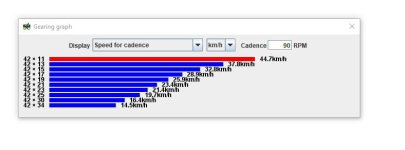

I have made today 35 km with OSF 1.0.1
I have used most of the time 8-12 level of assistance.
a lit bit of enduro ride, flat with single track
Distance: 35 km
Outside temp : 19 C
Motor temp start - 21C
Motor temp - end- 41C
peak- 54C
FW- On
Battery: 830 Wh
battery start-100 %- 54.6 V
Battery on the end of the ride: 65%, 49.1 V
Im very happy of that results.

Battery weight is 3.3 kg for 17,5 AH . Samsung E35 , 3.7 v ,
I use it for longer distances and for ... MTB. As We all know efficiency and power is going down if the V is dropping. Having bigger battery let me go with power for around 50 % of capacity. Then it drops and I can feel it. ( I have some problem to set up resistance as it is changing. Power loss- sometimes small like 2-7 , sometimes big like 17-20. I do not know why...)
My weight is 79 kg.
But the most important is that because FW I started riding with higher cadency and lower ratio- around middle of my 10 gear cassette. Before that I used to ride almost all the time the higher ratio .
I have notice that this change is ( besides is a good thing for U knees) much more efficient and put much less stress on the motor, drive components and blue gear. It is kind of thinking like "modern bikes " where we have front sprocket max 36, most of the time 24-32 and bigger wheels.
Also important is that i use ( for now) 26 + tires ( 26 x 2.6) that gives me around 27' diameter. Higher cadence and lower gear ratio is the way to go ... Im using front 42 and rear 11-34 , and i know that U have around 50 in the front. ( I done the same some time ago ..) In my set up I can easy go like 43 km/h
For my next bike what I building now ( 29+ bike ) I have design special front sprocket ...38! With proper offset of 9 mm. Bigger wheels, higher cadence ...It works for me well. All because OSF! I can design whole bicycle around that firmware. THANK U for such a great work.
Here Is a lit bit of calculation. Speed for cadence. Cadence 90
38 chainring in 29+ size tires
42 chainring in 26+ size tires
cassete 11-34
Printed prototype.
