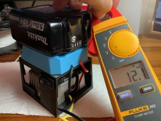

Got this thing put together this morning... 30A DC/DC converter, 30A rocker switch, 14 GA wire. Off the shelf Makita 18V battery dock from Amazon. Everything is off the shelf except the black 3D printed mount which is optional (the battery dock and DC converter can be sandwiched and hard wired as in the earlier version pictured above), as is the switch. This converter puts out 12.1V DC.

This is great. I'm a Makita fan and need a 12V source. Last time (1-2yrs) checked on the docks they where priced crazy high. If you don't mind I will copy your design. Great Thread.
You are certainly welcome to use the design, in fact I am posting it on Thingiverse right now. The docks are $15 on Amazon, cheap enough that I didn't bother trying to design and print one. The DC converter was $22, and the switches were $8.99 (for 5). See the listing here on Thingiverse for the 3D print file and links to the parts. That site is slow so it may not be fully loaded with the photos and such yet. But the parts links are there.
And if you don't want a switch or to do a 3D print of the mount you can just sandwich the dock and the converter and connect the wires.

Watch out for heat buildup on the DCDC might need to add heatsinking and/or a fan
without that 15-20A might be maximum.
If it becomes important, carry a spare
This thing won't be running continuously for long durations so I am not really worried about heat. But I have lots of alternatives... can usually plug into the car, and I have the Milwaukee version as above, and I have a Li-Ion jump start pack that will also do the job, and failing that I always bring a manual pump. Lots of ways to skin this cat. Perhaps too many?
