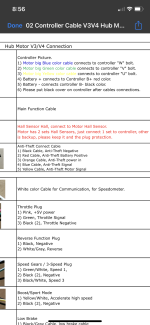

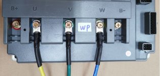

Hoping someone maybe able to answer this for me. I’m setting up my V3 3000w hub motor with a Votol EM150 controller.
In the pics and docs they say to set the 3 main wires up in a Yellow, Green, Blue order and everything else I’m reading and seeing shows Blue, Green, Yellow. I emailed my sales rep and he said to go by his docs not the colors.
So before I turn this baby on I wanted to see what others may say. Even in the word doc. I was sent it says to do Blue to “W” Green to “V” and Yellow to “U”
Thanks!
Thanks!
Actually there is a menu in Votol software (page 3) to exchange the phase wire.
