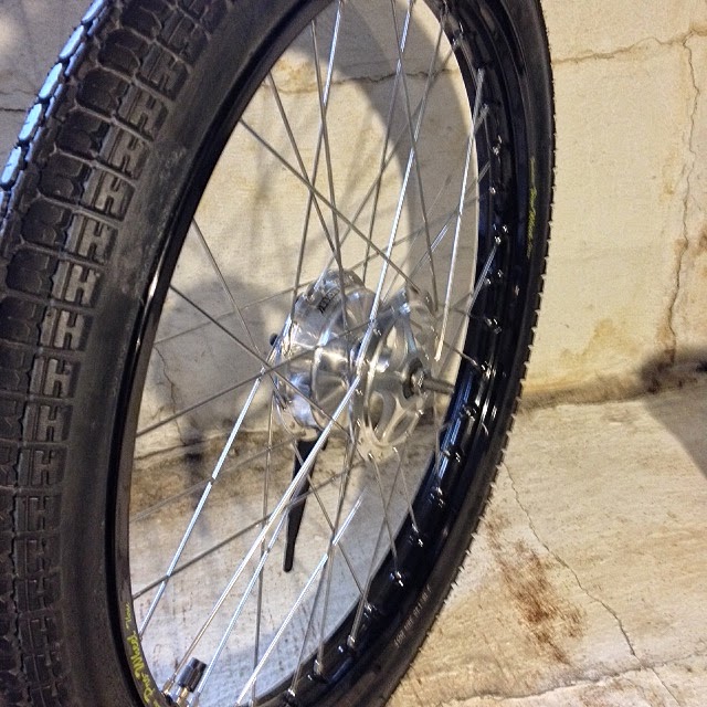

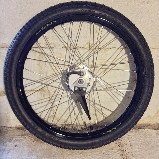

Front wheel = Pro-wheels 19" x 1.4" rim, Holmes Hobbies 13 ga. spokes & nipples (with washers) laced 3-cross to a Sturmey-Archer XL-FD 90mm drum brake hub, surrounded by a Vee Rubber 19 x 2.25 tire.

S-A 90mm front drum brake hub.... I like it!

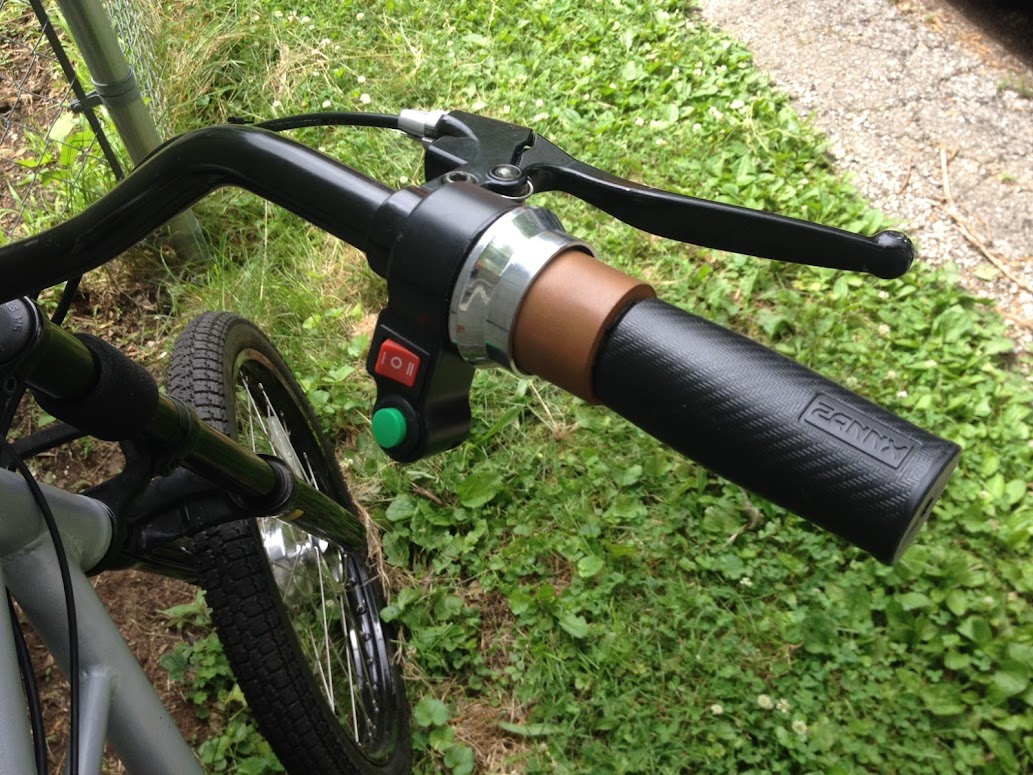

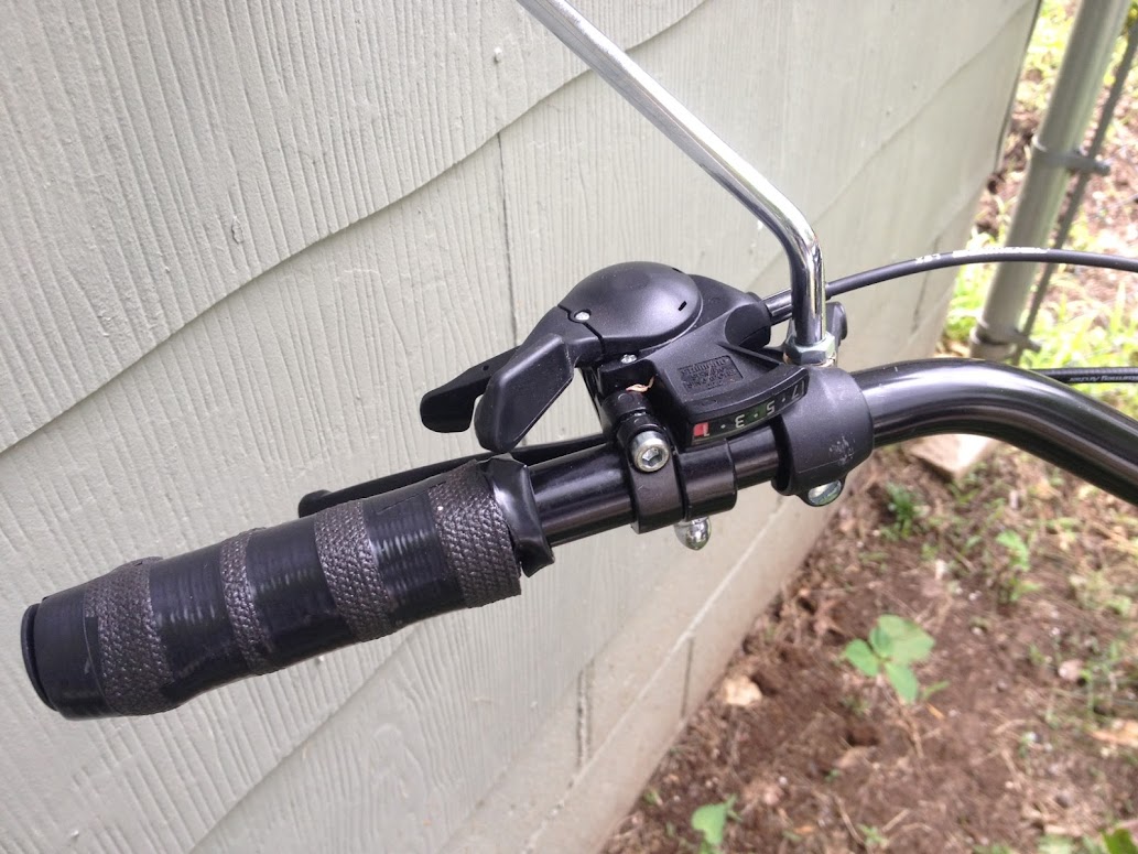

Upside-down 7 speed shifter on the left, since there's no room on the right. Works well. That ghetto grip will need to be replaced eventually.

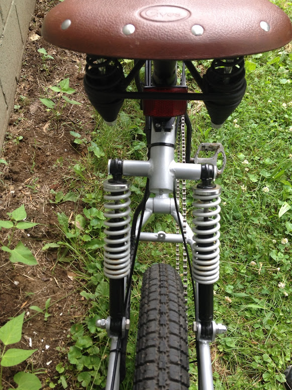

Dual rear suspension: seat and shocks.

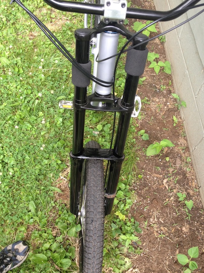

Front suspension: Suntour Double Down fork, same one from my first cruiser.

I have built a few wheels with the Sturmey drum brake. I have only ever used them on pedal bikes.
If you are used to discs the drum will probably disappoint. They are very progressive and don't lock up easily which is great for a regular bicycle but I don't know how they will go hauling up a heavy ebike like that. I'd take it pretty easy for the first few k's.
They do look good and the build quality is superb I use them when ever I can.
Modbikemax, I've used this wheelset on my green cruiser for awhile, and I agree the S-A is not as "immediate" as disc, but it just took some getting used to. This is the larger 90mm hub which is suggested for use on pedicabs and cargo trikes, and it seems to be holding up well to my heavy e-bike use. Granted, I max out at 25mph, YMMV. Also, I do use a rear disc, which helps for sure. Above I mentioned a test ride where I didn't have a rear brake hooked up due to cable issues, but that was a short ride with calculated risk. I wouldn't rely on one brake alone for normal commuting.

Where did you get the 90mm drum brake from? I didn't even notice the size in the pictures.
I have a project in mind where this would come in handy and I don't like discs much.
It's the XL-FD model (Extra Large-Front Drum) $81 at Universal Cycles. https://www.universalcycles.com/shopping/product_details.php?id=42788
They of course carry most other models as well.

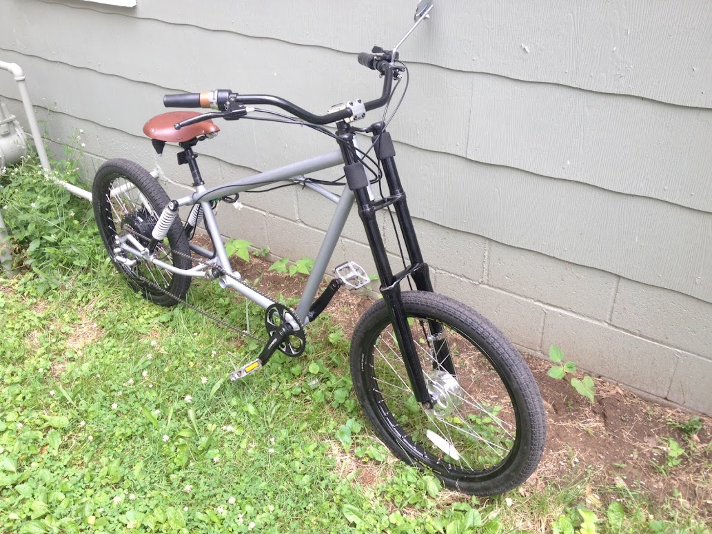

A couple of rides in, still need to work the chain rub issue and improve the fit and finish. As it seems it will never stop raining in the midwest, it needs fenders for sure. The wood panels are still raw and need covering of sorts, maybe just a clear/stain.
Here's a pic of my brother just before he took it out for some miles. The good news is that the seat adjusts to fit his short self (5'6"), which was a goal. (The green cruiser was for the 6'+ crowd only.) The bad news, as you can imagine from the pic, pedal strike is a concern, due to my tire selection on the moped rims working out to be 24" in combination with 175mm cranks. I'm looking into shorter cranks, though the easiest method may be bigger tires.
