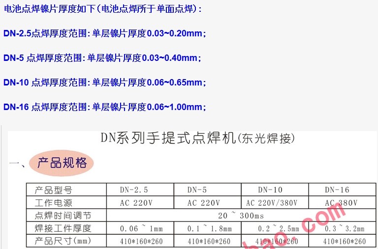

ride, as far as i know ivanov has the DN-10 welder. DN-16 would be way overkill IMO.
i now have a DN-5 on order because i think it will have enough power to weld nickel tabs to batteries. Also i read something from andreym they had to weld with the lowest setting on the DN-10 when using 0,3mm tabs. i guess its better to have some room for lower settings for thinner nickel. not sure what this setting does (if its welding time or power setting) but i will figure out.

how is the d16 spotwelder performing now?
wery good :) In total, it made more than 50kwh. And din16 is right model. Not din10. Battery is so good and after ~45 cycles (~7000km) it has 9mv difference

as for the welder i wish i had taken the DN-10 or DN-16 because the information from the chinese about max metal sheet thickness seems to be massive overstated.
check the numbers on this pic. the blue numbers on top seems the correct one:

iv contacted the supplier for a dn16. they said it must have 380v for operation. dn10 uses the normal 220v imput.
did you need 380v or 3 phase for your dn16?
or perhaps its a different unit..
