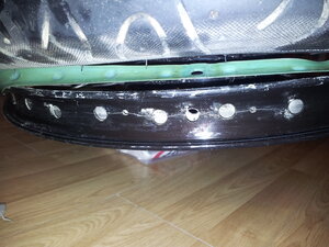

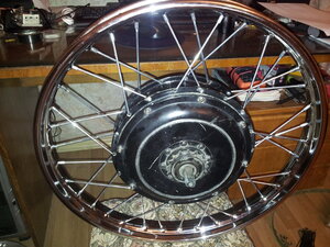

Back rim fail, ~15.000km:

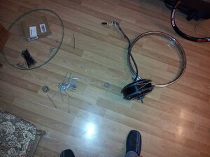

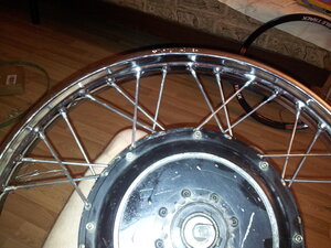

Time to change at...
mounting the tire, sawing off the superfluous:

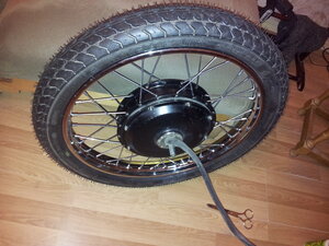

the result, 500km later:
18x1.40 + Michelin Gazelle M62 18 x 2.75
nice work with the wheel! do you have a studded tire option for snow/ice?

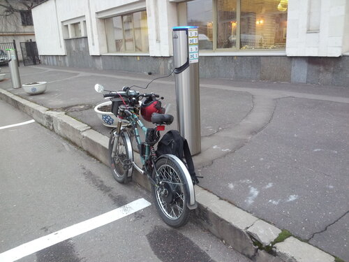

so cool to see you charge up on the street. how much does it cost for a charge?
what kind of washers did you use for the spoke nipples?

yeah it would be great to have charging stations like those here in aus.
itd save me sneaking round the back of the supermarkets to charge at their outdoor sockets :D
New tire well kept on ice. Tested yesterday.
80% of infrastructure is free, 20% 1$ for hour (testing mode) https://my.revolta.ru/fow/pages/home.jsf
Spokes and nipples have been found >>here<<, 115mm in length. Rim was purchased >>here<<. Additional washers are not needed. Nipples came to the rim perfectly

I have heidenau 2,5" 41J on front and 2,75" 46J on rear rated for 100kmh.
The 2,75 is not perfectly round (maybe i got a "monday" tire), but apart from this these are good tires and due to the high weight (both about 2000g) there is lots of gyroscopic force for driving stability which makes the bike feel more like a moped.

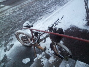

For winter riding i now changed my tire to Conti KKS 10. They have very soft rubber.

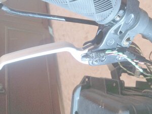

Front brake on the left huh? Guess it's me who is used to motorcycle style brakes...front brake on right side.
Where is the regen button for the rear?

Hall regen (and a reed switch for stop signal) is located under the handle. At the right side besides the lever gas and lever light switch is nothing.
ps At the Institute, he is chained at the entrance for 6 hours per day. Abus city chain x plus 1060 = 2.5Kg of tranquility :D

Nice vid :) With the right clothing you can be comfortable in those conditions. Are you running studded tires? Looks like there was some ice on those paths?
Summer tires: Hookworm + gazelle m62, as it was before. Not seen bike\ moto studded tires under the 24/18 "
ivanovlev said:
Hall regen (and a reed switch for stop signal) is located under the handle...
thanks for pic. i had a hard time figuring out how best to have the magnet wipe the hall - cause sometimes the voltage seemed to in reverse...
does regen kick in the moment you move the lever? do you remember how much voltage range it has like that? finally, what's the adhesive? epoxy?
