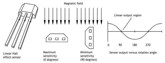

About the hall. By default, it gives 2 volts. One pole of the magnet change it to 1v (2-1v), another to 3v (2+1v). So there are two options - either to keep 1v using permanent location on the magnet , and pressing the lever (removing the magnet) to restore to default 2c (as done), or place the hall so that the magnet on the contrary suited to him when you push lever and raise it from 2v to 3v. The second way is undoubtedly more difficult to do in this form factor, because hall is so oak (whether I got, only they all are), that for deviations in 1v it should be placed tightly to the magnet. Removing it literally millimeter leads to loss of half of the range.
adhesive - hot glue
interesting... just testing here -my lever (and magnet) shape is very different, so i've got a bigger gap to cover, and the brakes don't contact until i've depressed the lever halfway...
and the sensor is so senitive, that if the magnet sways away, it doesn't work..
i'm not sure if this is the same sensor, but it's interesting...
and i can't remember the max side but i think you're right that it's like 2V delta:
my sensor and magnet came from inside an old throttle, and the magnet moved from end to end over the hall giving a lot of range. maybe i should try smaller button magnet...
