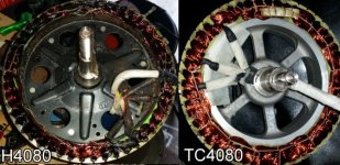

Speaking of post race stuff, I just pulled apart both my motors to start work on repairs (new axle for the TC and stator swap for the H40.
Check out the difference between the TC and the H40 stators.
The TC did 10 laps at a time in practise sessions running flat out with sealed side covers and looks like new. The H40 had drilled covered and riding more conservatively thoroughly smoked itself after 7 laps. Both have 40mm wide stators and discounting the slightly deeper slots on the TC, the rest comes down to the extra heat sinking of the solid TC stator. Really impressive and the difference is more pronounced that I'd have thought.

I have 2 lots of cro-clones, the 'batshit' motor is crazy fast but has the stamped stator. I've gotten it so hot it melted to solder out of the bullets and when the bike stopped and I wiggled the wires to see see if they were loose a bullet dropped off into the dirt :lol:
The other cro style motor I have here has the solid stator so no doubt it'll be more heat resistant.

Awesome data man. Reckon there'd be an easy way to upgrade the tinny stators?
Science FTW.
Nice stuff Jay...very interesting info on the stator differences.
This...
You could probably replace the stator core with a solid or more fancy one but it probably wouldn't be worth the effort. I may still do my dual air / oil cooled idea one day.
The thing is under normal circumstances and with thermal monitoring the H40s are a really solid performer. Not much chop for racing at silly power levels but you dont need to be a rocket scientist to know that! What I should have done was have a water bottle on the side of the track and stopped mid race to spray the motor down, then continue on :lol:
Wow, what a huge difference. I think I will get my the TC4080 when they become available with the regular spoke flange. Light weight like the 40xx, more tolerant to higher current like the 54xx, even though not quite as much. I noticed the TC80 you have has 14mmx1.5 pitch axles, like the 54xx. Is crystalyte using the same diameter axle as the 54xx? If not, I will have to contact Tench and have him Tenchalize me an axle.

Interesting pic of the stators from those motors Jay. Apart from the better heatsinking ability of the TC its also a lot to do with just how efficient those TC motors are compared to the rest - as per the ebikes.ca simulator.
