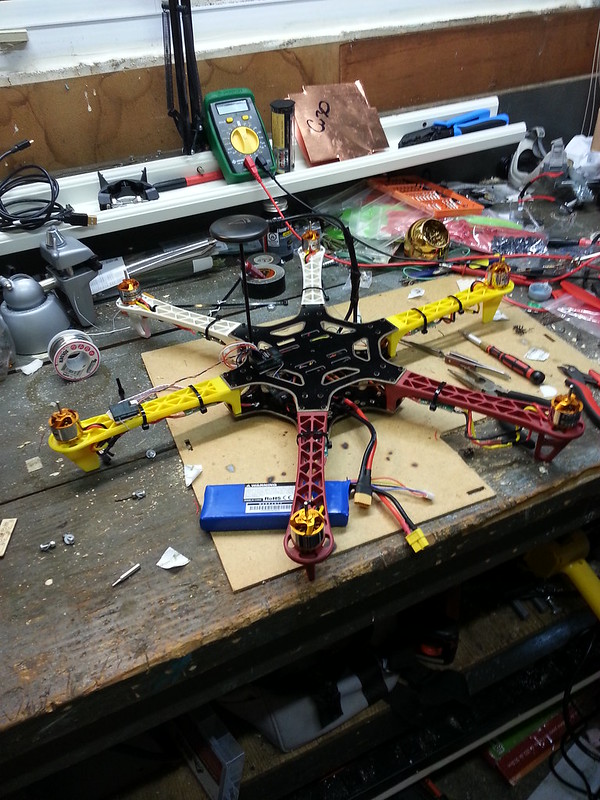

Got the hex nearly built :)
The GPS is working and locking.
The Bluetooth module took me many hours of troubleshooting to get it to work with Megapirate and Mission Planner, but it seems solid now. I have not had time yet to make sure it works with my phone. That's tonight or tomorrow....
Once I get a good prop balancer I can balance the props, install them, then give it a test run! I also need to get my radio configured for at least 4 flight modes (no 3-toggle switch on my Dx6i.... ).
What is the best way of mounting the main battery pack?
20140929_204640 by deanwvu, on Flickr
mount it where if you can, try and keep it balanced tho..
What was the issue with bt and megapirate?
I think it was a power issue for me. Once I powered the BT module from the BEC it worked. Before, I was powering it from the board, which gets it's power from the ESC.
I am not able to power my board from the BEC. There is something wrong with my board... On my board, the EXT power (BEC power) is shorted, and I don't know how. When I first applied power from the BEC, I saw a puff of smoke and immediately powered down. I then tested continuity--the + and - of the EXT power leads have continuity. So.. short somewhere. It doesn't seem to affect the performance of the board as far as I can tell, but I have to power it from the ESC.
