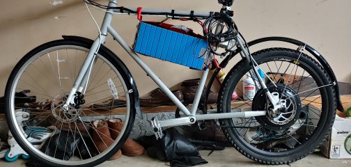

Hi guys, My ebikes are all Retro MTB but my last ebike frame broke so i decided to go a different route as i have always liked the sleeper look and im getting old.
Its a 1000w motor with a 20ah 48v battier and its a little bit scary but much fun to ride :), it was a pain to put together If you want to see my thought process, broken ebike & other ebikes please see my other post, there is some loose ends to tidy up but let me know what you think please all.
The first picture is the original ebay listing photo.

I like that bike. Cross-2 spoking in the rear wheel will be a problem sooner or later, but that's fixable when it becomes an issue.
Now you need a matching front basket to carry your stuff.
by Chalo » Sep 05 2021 5:44pm
You have a sharp eye. Why is that if you don't mind?
Its a nice ride, but personally I hate the way those handlebars are. I tried handlebars like that a few yrs ago and it wasn't to my liking but to each their own.
A 1pc front handlebar welded basket is something I've been looking at. A 5" riser with a deeper basket, might have to make my own.
Bought some Evo Brooklyn handlebars. Havent tried them out yet but I know already they will affect handling, so I wouldnt put more than a few pounds of stuff in them. Origin 8 also makes a similar product.
Check out the Azor front rack. Its frame mounted so your steering isnt affected as much.
https://www.amsterdam-bicycle.com/shop/options_accessories/options/aluminum-front-rack/
Thank you for your feedback guys, the rear wheel was built with13 gauge spokes cross 2, cross 3 with a large hub is problematic, if you check the white bike wheel you will see the angle of the spokes and that was with a smaller hub, the original hub wheel was a cross 1 but with 12 gauge spokes when i brought it, but you are right as less crosses less strong and the spokes will/do work loose on hub motor more so with fewer crosses, the main problem was the rear brake, if you look its bolted to the rear rack as not enough room to fit between frame and rack stay, not ideal but its a strong rack and the only other option was to remove/replace the rack and that not happening, didn't want a disc brake but had no choice as couldn't fit cantilevers as no fittings & the brake bridge is too high to fit caliper brake.
Im 6.4" the handle bars hit my knees at low speed corning which is not ideal but i have spent my MTB life bent over arse up head down and to sit upright is glorious but the front gets very light as all the weight is over the back wheel.
Was going to fit a wicker front basket but its a bloody massive bike as is and i live on second floor and i cant even put it on its back wheel as the mudguard is to long plus the frame flexes, it doesn't stop, it doesn't corner and when you hit a bump as 25-30 mph its scary as hell and everything would just bounce out of the basket anyway......but i do have kittens i did think that would be cool with them in the basket :).
