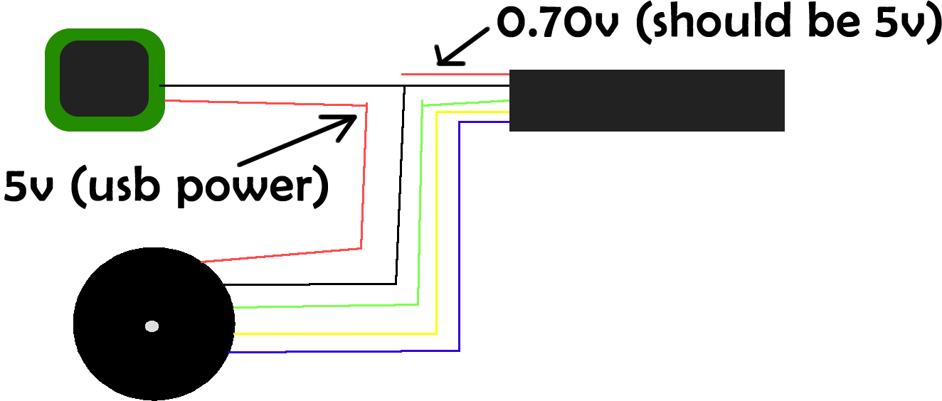

Damn! Just as I was starting to get the hang of all these settings and "fine tuning" for trowing 6kw shots.. "!Halls!"...or did I just learn enough to be dangerous :roll: !!
Yesterday, I was working on my 12 o'clock salute, mini-e tuned for instant power, when I first noticed the "Halls!" come on. Not thinking much of it, cus it's been running great, I continued on my ride.
A few miles later, It started again.... by the end of the ride, I was only able to run sensor-less. I don't think it's the halls in the motor, as sometimes they register in the health monitor strong and in order and sequencing correct (001,010,100)? However, I will check with a DMM tomorrow. I don't think it an FET, the motor is smooth and easily maintains 40mph in "sensor-less".......... Is it possible it could be a resistor? 113 or something I think I read on this thread?
Any help here is appreciated!!
I think you need to measure the voltage from the halls plug coming from the controller, it should be 4-5v I think. If not then it's the resistor on the board. I think C2reak had this problem with his Max-E.

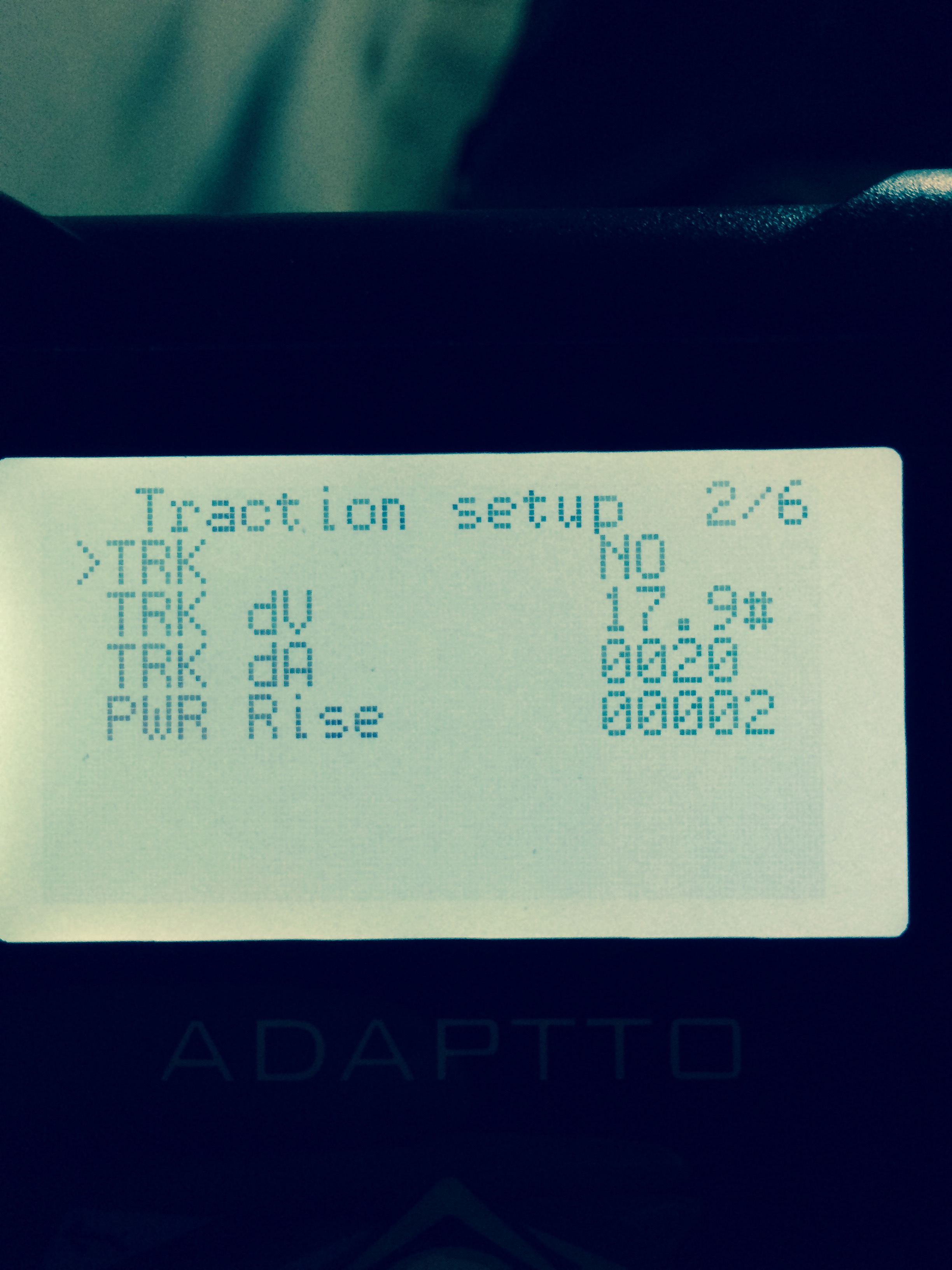

Screen dumps below! Make sure you get all of the images, because somehow imgur did not resize all of them. If you have any problems viewing, go here: http://imgur.com/a/c1WN7

Traction setup 1/6:
Traction setup 2/6:
Traction setup 3/6:
Traction setup 4/6:
Traction setup 5/6:
Traction setup 6/6:
Thanks Jackrabbit! Yup, just as I suspected, Halls are only getting .5 - 1.5 volts. Must be that 113 resistor? 2 - 8 ohms, huh? I know if I send it to Moscow, be mid-July before I get it back!?!?!/

SMD components?? Sooooo, I imagine if I can't read the # on the resistor, kinda counts me out for doing this repair with my Radio Shack soldering set-up, successfully anyway!!?? The resistor doesn't even look like it goes through the board...... better call one of my buddy's from McDoug's, see about some ceramic cap upgrades too......wtf. under the pocket microscope, looks like "3R9"..... 3.9 ohms? Help Adaptto E-Drive labs?

crea2k3 said:
I took a 5v feed from the usb port of the display unit and soldered it to the halls 5v input only, then took a ground from the display unit and soldered it to the motor to controller ground wire, just to make sure they are using a common ground and it now works fine, so for now il leave this bodge in place until I can take the controller apart to look at the power supply circuit for the halls
Doing that would save me having to send the controller around the world to get fixed.
I believe the Halls voltage should be around 4.8 or something, even 4.3 volts will cause the !halls! error, or if the resistor is shot the halls voltage will still read in the low 4 volts. If you have the !Halls! error you have to run an ohm meter over the resistor to check if it is shot.
Any other value than 3.9 Ohms means your halls resistor is shot.
If shot it will usually read like a million ohms or something high like this.

Guys - for future reference, R113 does not just randomly let go, it's there as protection for the upstream circuits. If it has blown, you have a problem either in your wiring or in the motor itself. Back when I had the core of my HS3540 shift sideways on the splined axle 2mm and this was enough for the side cover interior surface to sand through the hall wiring insulation and short it out. That caused my first failure, no fault of the controller.
Crystalyte is anything but high quality and I would look very closely at everything else before you blame the controller. The infineon type controllers are more tolerant of transitory shorts in the hall wiring, you might not even notice (until they randomly blow up of course)
DO NOT bypass the power feed as a 'fix' for this resistor blowing! It's there to save you headaches.

Just to add not only the halls wiring but the temp probe wiring will also blow this r113 fuse.
