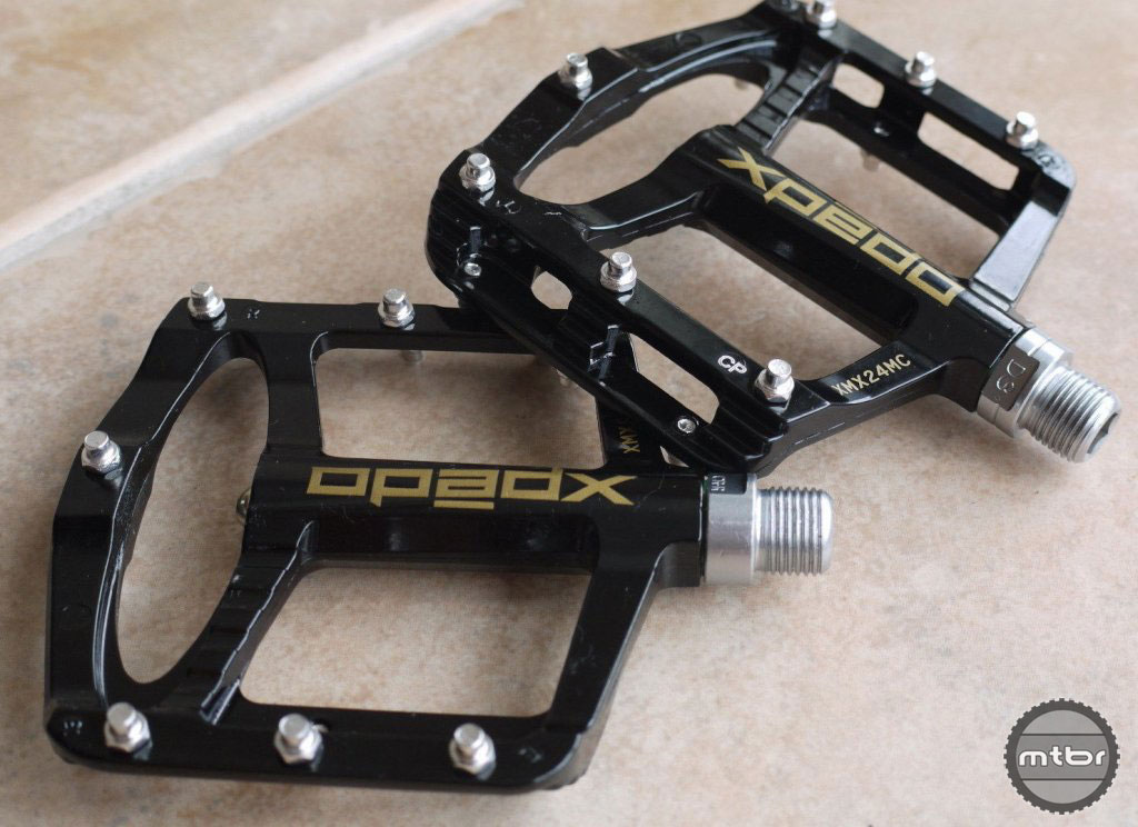

Shimano Saint pedals look great but I won't buy another pair. They weigh 500g which is a lot.
I've worn the bearings out after two years of light commuting.
I pulled them apart and they're all lubed but the design seems wrong; there's 2 races at one end (furthest from the crank) but
just a plain bearing and token rubber oil seal at the other. Am I missing something here?
My next pedals will likely be these. They're cheap and light.
http://www.xpedo.com/products/pedals/platform/144/spry

Those pedals look great!
