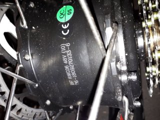

I have been trying to learn more about the motor I have on my bike. Being that this motor is on a manufactured bike from what I have been able to learn it looks like the wattage is not part of the numbering system like it is on some examples of Bafang motors. I suspect this is so the OEM can make multiple claims of power level for selling into different markets, But this then leaves me wondering what else is different with the numbering. If some else more experienced could look at the numbers and give me a idea of what info I can get off them that would be of help.
Have I found the correct motor here? https://www.ebikes.ca/tools/simulator.html?motor=MG01_FST&batt=B4823_AC&wheel=28i&mass=130
How in that numbering system do I know if it has fast or standard windings?
What does the "10" in brackets stand for?
What does the -6 stand for?
Thanks.
Yeah, the 10 is the winding T number. They also have 13 for bigger wheels and more torque(if your controller is limited in current capability) at lower speeds, and even 15 on some of the rear hubs. Their regular wind is 10 & 11 and their fast wind is 8 & 6.
Now if someone can explain why their motors are classified for different voltages such as 36/43 or 48 and whether there are any physical differences inside the motor, then that will solve another mystery.

G06 marks the series (casing)
Last number (x) is winding indication (6 to 12 on G060 series).
Voltage rating indicates that nominal wattage rating is applicable within those voltages. From the fact that 750w 48v nominal motor is also rated 750w at 36V follows that actually at 48v the motor is "rated" 1000w (750w/36v=20.8A-->48v*20.8A= 1000w).
Fiddling with the Grin motor simulator shows that the Bafang watt ratings don't correspond to anything of any use. I have a theory about this as per item (3) below.
Regarding the motor windings: If you look at specs in the Bafang motor datasheets and catalog "workbook" then you'll find that there is a huge disconnect between the winding suffix (6~15) stamped on the motor after the part number, and the Bafart published voltage+RPM specifications. Perhaps someone here can explain how these correlate? I'm sure EvErYoNe would like to know!
Lastly, if a motor is stamped for example with "FM G312.250.D/V 10" then does this fully define the configuration of the motor? Or could there still be two fundamentally different motors with this same stamp? I ask because Bafang seems to make a big deal about motor voltage ratings, for instance the difference between a 48V motor and a 36/43V motor. Why are the datasheets segregating motors into different voltages and then having to quote n0 values when they could simply have quoted Kv values? Is it because they are afraid to publish Kv and winding T values in the specs? Are they afraid of legal motor power restrictions in the EU? What is going on here?
In the end, it's important to have a good specification for the motor because that will determine how one should spec out the controller current and voltage capabilities, given any particular application/usage scenario. I wanted to order a G311 motor and when I asked for a 13 suffix I got the run-around and yet this is absolutely fundamental. They would rather ask "How big is your tire" and "how fast do you want to go" instead of allowing me to order by rational motor spec. Sigh... It's like having children, when the motor finally arrives in the mail you just don't know what it's going to be.

And so I'm pretty parched after having tried to buy an FM G311.250.V/D 13 motor and getting the run-around regarding "how fast do you want to go" and "how big are your wheels" and "what is your battery voltage" and all that crap. My answer is "suffix 13" and so I still don't have a motor and I'm still trying to buy it. 80% of all expended human effort is usually wasted so once again, ignorance is bliss.
@OP, I see that your motor is stamped as having a "10" winding. Do you really have 26" wheels on your bike? A 10 winding is often associated with either a lower battery voltage or smaller wheels. That thing must go like stink on full throttle at 48V!

26x4" wheel fitted with 10 turn G060motor has no load speed of ~50km/h @ 48v.
Max loaded speed ~40km/h.

One thing is that 26x4.0 wheel circumference is approx 28.5" depending on rim width and tyre brand. Regarding to actual battery voltage my measurement is done closer to full 48v battery, lets say ~52-53v.
