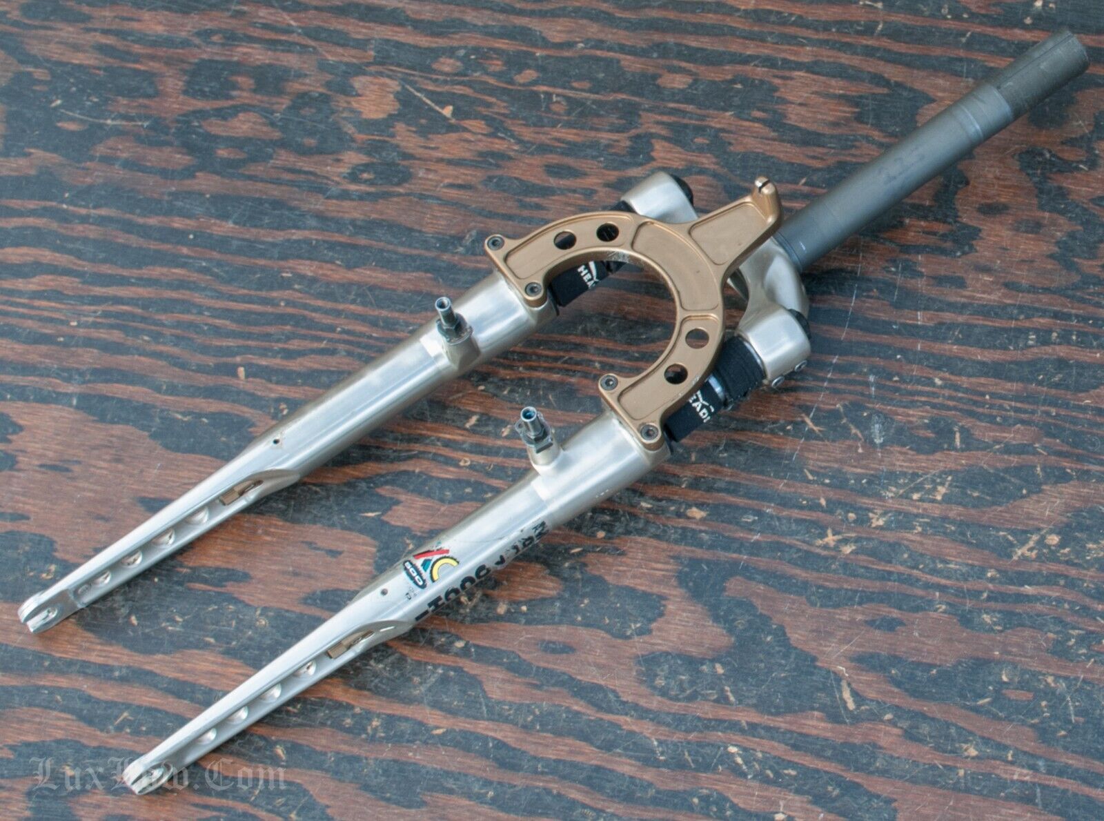

Folks are really sold hard on fork diameter these days, but remember there are other qualities to a tube than diameter. Wall thickness and material are just as significant or more so.
Keep in mind that the same snooty early adopter types who insist on chubby forks these days were using 25mm or 25.4mm stanchions when telescopic forks were the latest hotness. They would have pooh-poohed today's fatty forks as impossibly heavy and ugly motocross stuff.
Also, note that aluminum stanchions are considered to be the good stuff, but you need more than 35mm of aluminum tubing to have the same stiffness as a 25mm steel stanchion of otherwise identical dimensions. So today's "discriminating" fork buyers who boast thick forks for rigidity, but reject steel steer tubes and stanchions as less-than, don't really understand rigidity at all.

Sure. But skinny ≠ crappy, it's crappy = crappy. My guess is that the flexy/wobbly quality was related to bushings rather than structural element size, and the snapped-off event was a result of nickel-n-dime engineering and penny manufacturing.
Hey i'll admit there's some older components that were quite strong with limited diameters, due to good engineering/materials.
But not in the bargain basement range!
30-32mm stanchions is pretty common on a $200 fork, which is the minimum price you need to pay if you want to get into oil/air goodness. It's also about as small as you want for a strong 180mm disc, which is kind of a minimum front brake for a heavy 30mph bike going up and down mountains.
