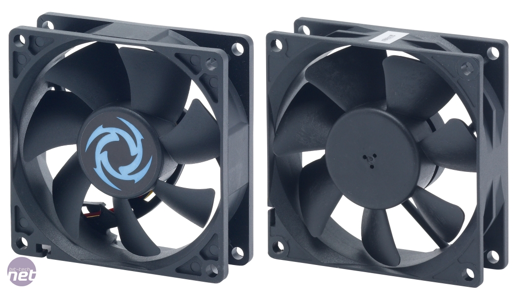

mauimart said:
.....If there was an easy way to effectively get the heat out of this motor (who hasn't heard that before), it would be the perfect e-bike...
My 2 cents, 80mm pc fan glued to the rotor, forcing air in....?
What do you think about eliminating the rear cassette freewheel so that the motor is always getting air even with no load (with the above fan)? Regen braking and shifting without accelerating or pedalling as bonuses...
Perhaps even an air scoop!! :D
I've thought of something like this but decided to try one of Thud's centrifugal fans that will draw the air from one end of the motor out through to the other. I will post updates once I get some results.

My idea: Remove the rotating part of the 92mm fan (my bad :D ) and glue it to the 80100 rotor with a plastic sleeve around to force the air into the motor.
fba09a-1%2090mm%2092mm%20case%20fan%20side%20panel%20cut%20out%20diagram%20dimensions%20cutout%20template.gif
Didn't explained explain my idea well enough, sorry...
Thud's fan shows awesome craftsmanship but bad design in two ways: straight blades and sucking hot air instead of pushing cold air. Curved fan blades are more effective and pushing in is a lot better because it's denser, therefore, great cooling effect.
Of course, you could test both options (real conditions temp monitoring and no load current) to compare.
