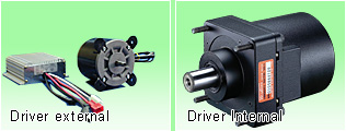

This is a long post, but it gives important background knowledge for anyone considering Cyclone kits/components.
The specifications on the Cyclone website are confusing, patchy, unorganised and some cases a blatant lie (efficiency in particular. Some dynometer graphs show much lower efficiencies than claimed in text).
Here's my attempt to clear things up a bit from what i have learnt in my web wanderings and communication with the company.
Firstly, there are two size classes within the planetary motor selection, but the larger of the two sizes are manufactured in both internal and external controller configurations. I am in agreement with others that the internal controller models should be avoided by anyone looking for a setup that doesn't need to conform to 200W limit regulations. The fact that the motor and controller are thermally coupled is a recepe for unreliability.
These motors are manufactured by Headline electric Taiwan and resold by Cyclone with the kit components. http://www.headline-motor.com/bldc-scooter-driving-motors.php
The motor options go like this;
- Short barrelled motor with 9.33:1 planetary gearbox with 24V rated 200W(250W really) > 360W internal motor controller
- Long barrelled motor with 9.33:1 planetary gearbox with 24V rated 500W internal controller
- Long barrelled motor with 9.33:1 planetary gearbox wired for use with 36V/48V rated 650W>1200W external controllers
Headline Electric External Controllers
Electrically (Excluding the rescaled LED 'fuel guage' indicator levels programmed into the MCU), there are only two types of external controller also manufactured by Headline Electric Taiwan and resold by Cyclone. Although the Cyclone website would seem to suggest there are four versions, the two upper and lower spec models contain the same power electronics despite having different voltage rating labels stuck to the casings.
The 36V 900W/48V 1200W controllers are the same and have 75V rated Fets (IRFP2907 - RDSon = 3.6mOhm) and 100V rated capacitors so max voltage = 75V
The 24V 650W/36V 720W controllers are the same and have 60V rated Fets (IRFP064V - RDSon = 5.5mOhm) and 50V rated capacitors so max voltage = 50V
It is my strong suggestion that anyone buying these motors/controllers/kits should opt for the larger 650W>1200W version with a 36V/48V external controller. Regardless of the intended voltage that the motor is run at, reliability and upgradability increase and the price difference between the 24V/36V and 36V/48V external controllers/kits is trivial. The 36V/48V 900/1200W version is electrically rated to as high as 75V by its internal components, but the RDSon of it's mosfets is lower than those within the 24V/36V 650W/720W external controller. This results in greater efficiency and less heat build up at any driven voltage and current between 24V>75V.
