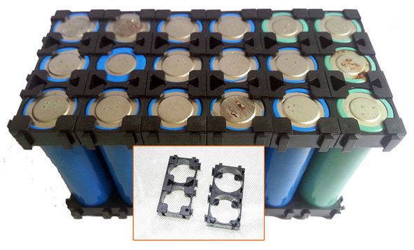

I disassembled my 10S4P MKEPA Li-ion battery pack and found out that it is unsafe as the individual cells are directly glued together without the use of additional plastic spacers. This poses a considerable risk of short circuits. This vulnerability arises from the potential wearing down of the thin plastic film that encloses the cells, especially during vibrations experienced while driving.
Short circuit is dangerous and will cause fire or explosion.
Please give your opinion on this issue..

Do you have any experience with packs build in this way?
I have experience from packs with plastic 18650 moulds plus a bms and charge- and discharge fuse.
I have not seen any black spots or alike when doing checks.
I would prefer not to own batteries built in that manner, It's a long term reliability problem for an ebike pack, which is subject to mechanical stress and vibration. Less of an issue with a stationary battery, Yes, no glued cells for me,. They should be in a plastic cell matrix.
Another good practice is to use insulating rings over the positive terminals. Otherwise, the only insulation is the PVC wrap over the edge of the cell. It also helps protect damage, if the spot weld is off center.
FWIW, if the cells are actually securely glued together, and secured inside a casing that prevents it from moving around except as a whole entire unit, it's unlikely that vibration will cause any degradation of the shrinkwrap.
However, if any cell actually did fail in a way that heated it enough to cause the wrap to split (which has happened without actually causing a fire or any other failure than killing the group of cells it's in by discharging all the rest of the ones in parallel with the failed cell), and that heat caused the contacting cell(s) in the next parallel group in series with it (either + or -) to *also* split it's wrap, *and* those splits line up...*then* a short that can cause a fire could happen.
If the cells are not really thoroughly glued together, but just have some glue on some of the cells in each group of cells that's glued to the next series group, then vibration can have it's way with the ones not secured by glue.
Same for if the glue is a type (like hotglue) that doesn't really stick under some conditions and can crack and come off.
Also same for shrinkwrap that is either already damaged or is fragile and cracks under age or various environmental conditions the pack is likely to see.
Note also that if the glue doesn't securely hold the cells in place, and they can move even a tiny bit inside their casing, then over time the interconnects between cells that can move can fracture, usually at the spotwelds, and cells in groups can become disconnected from the pack, reducing the pack capacity and capability, and stressing the remaining cells in those groups, shortening their lifespan and heating them more in use than the rest.

Prolonged voltage sag is usually the culprit. If you can't afford to buy a more expensive quality battery to minimize voltage sag try the following: Shift down from say 5 to 3 and do some power pedaling assist up a lengthy hill climb.
If that happens the culprit is inferior battery fabrication. Even if you added another shrink wrap tube over the can label the culprit is more often excessive heat that can burn a hole through the cell can. Either due to cheap Chinese blue shrink wrap batteries (e.g. AliExpress, Alibaba), inferior DIY using salvaged cells, human DIY error, prolonged voltage sag leading to excessive heat and potential fire.
There will still be professional builders that will glue to save time, cost and space. Whether or not it is "acceptable" depends on the quality of the cells and taking into account the particular battery application to minimize voltage sag.
Using the following plastic spacers may not prevent a fire anymore than gluing side-by-side when one or more cells overheat to the point of burning through the can wall ...
