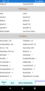

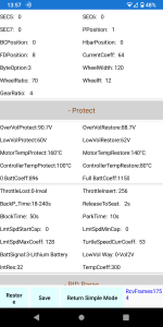

finally i bought a Fardriver NS72450 and it works :)
i use v223 of FarDriverApp. got it from Alibaba where i bought the controller.

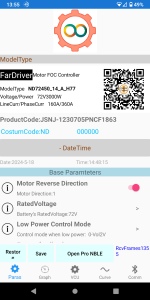

now i'm looking for information on my hub motor (Rear Hub Motor for Delfast Top 3.0 and Top 3.0i)
i don't know how many pole pairs it has and i think i will need the correct this value within the Fardriver App. After AutoLearning procedure it came up with 4 pole pairs, but i don't think that this is correct.
there is only this number on the motor: 211221 1668 3.5T

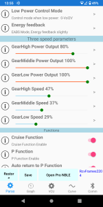

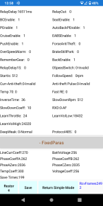

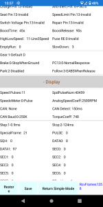

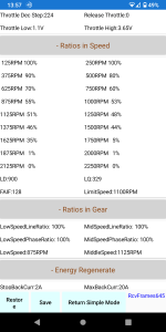

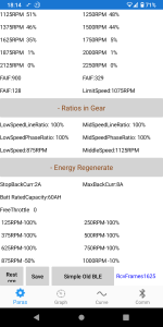

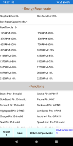

today i managed to get regenerative braking to work on my QS205 hub motor. it needs further improvements but for now i'm quite happy with the results.
here are the actual parameters in farDriver App 2.2.4
for some reason 'EABS when brake release' did not work for me. i got no regeneration with this setting.
'EABS when release throttle' works.

i'm on this regenerative-braking-thing... i'm wondering how much breaking is possible with the QS205 bldc hub. when i drive down the hill and reach 50km/h the regerative breaking puts out -470W at the most. i've set the parameters on different rpm speeds to 100%. playing around with maximum back current seems to have a little impact but not much. it is set to 20A actually.
That depends on the specific way your controller does it's breaking, the speed you're going vs the winding of the motor vs the votlage of your battery, and the specifcs of the controller's settings that relate to it's braking operation
If your controller and system supports enough braking curent (either negative or positive, depending on braking method), it could lock up the wheel.
FOC controllers can change the current flow in the motor to what would make it spin in reverse, while it'smoving forward, to actively brake the wheel. This doesn't genrate power back to the battery, so it isn't really regen. Whether a specific controller actually is programmed to do this you'd have to check, and on what current limits it has, to know if it's suitable for the braking forces you need. Doing things this way can heat up the motor, cables, and controller quite a lot, so if you have to brake repeatedly like this you could overheat things if there's no automation in the system to prevent that (which would be able to take away your braking unexpectedly, so not usually a good thing to have--a warning would be better).
Regulard cotnrollers use at least two ways of regen braking--one simply accepts any voltage higher than what the battery is and feeds it back to the battery to generate current in the system that loads the motor down, dragging to slow it down. This is only useful at higher speeds.
The other repeatedly shorts t he windings and uses the voltage spikes to get that current flwo that drags on the motor, so it can get braking down to a much lower speed...but not zero, and the higher the battery voltage the hihger the lowest speed it can brake effectively at.
stop back current is the limitation for the controller , the max back current has to be set 50% higher than stop back current according to the manual, but it has no visual impact.
found out the exact motor type now. it's a QS 205 V3. temperature sensor should be KTY83/122. motor should have 16 pole pairs.
found some useful information here -> http://www.siaecosys.com/upfile/202203/2022032841777345.pdf
