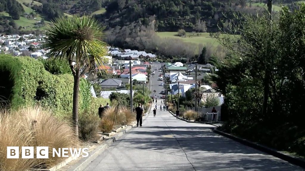

That must be offroad since there aren't many, if any, paved roads with a 35% grade. What kind of tires are you using?
It's an old tarmac road and is actually called "19 degree hill" (because nobody can pronounce the real name). When I want to test how things are working, I head over that way and challenge it. When I had only 500w to battle it with, it always won. The locals used to take their new cars packed with their buddies to see if they could make it to the top:)
I'm using stock tires in the summer and Cake Eaters in the snow...
That must have been a challenge to pave. Are you in New Zealand?
