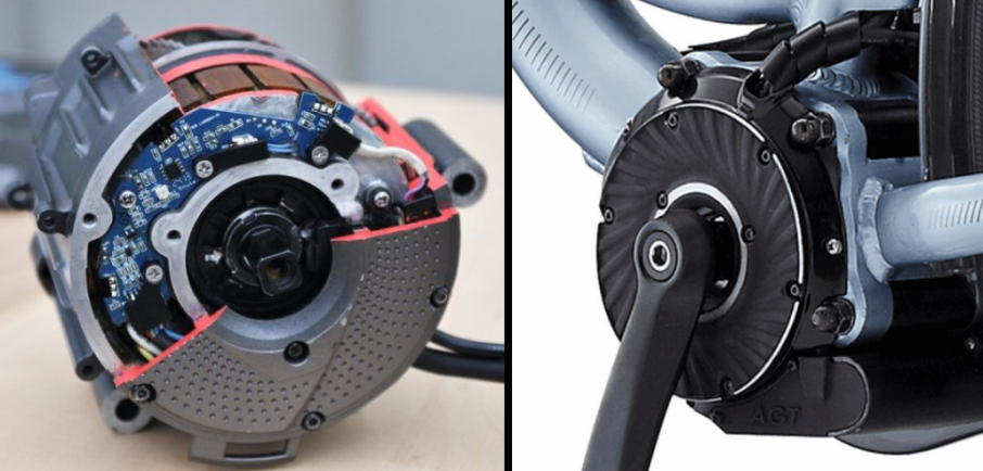

I would also agree with Rassy that the BBSO2 is a very good system, but since you mentioned some concerns about it, here are some other options:
TranzX (Bottom Bracket Drive available in a complete E-Bike package made by Currie)
https://www.electricbike.com/2014-mid-drive/
(I've been very impressed with Currie's latest line-up, the ***EDIT Pro Tour *** will be available soon for 2016 with a 500W (most competition is in the 350W range) and "mid drive or BB drive" units often can multiple their advantages using the bicycle's gearing + better over-all power to weight ration VS hub motors in the rear wheel, giving better handling and over-all performance, since you can go longer with less battery because of the increased efficiency.)

Mid drive. Is it a coincidence that the major brands are all offering tons of mid drives in 2016? Not hardly, But the best systems, the bosch and the shimano steps will be VERY pricy.

The BBS02 is hard to beat for what you're looking for. Its by far the most efficient so you can either go with a smaller battery or enjoy a longer range. The drawbacks?
• Shifting requires developing new habits; don't waste the money on the "shifter switches", just lean how to shift either at speed or with a quick backpedal.
• Single front chainring - you can later upgrade to a SRAM DualDrive hub but set the BBS02 to 500 watts.
• PAS Cadence sensing on the BBS02 is OK, so long as you're not trying to exactly match the speeds of other riders.
• Drive systems will wear about twice as fast/ chains sprockets.
• Buy a battery with an internal "fuel gauge", the Bafang is a bit off.
