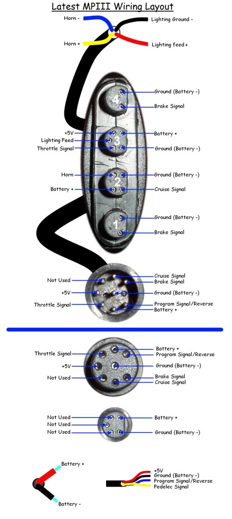

This may be a dumb question but I am trying to install the universal external controller from Golden Motor on my magic pie 3 and several of the connections call for red wires coming from the harness into the controller connections. I only have one red wire. How do I make this work?
We'll need to know exactly what you have and where the wires go / what voltages they have before we can tell you. Red wires could be for literally anything, so we need to know what red wire you have, what it is for, and what red wire(s) are called for by the specific connections you need to connect to.
If you don't know any of those things yet, then links to the specific parts you've bought may help, along with pictures of the wires you have there, labelled for where they come from on the bike or motor. We might have to have you make measurements with a multimeter once we see what you have.
This is the diagram I am following
Although any color wire can be used for almost anything when it comes to Chinese components, there are generally two voltage levels used for red wires that provide power. For the existing wires going to your Magic Pie, the fat red wire is the battery source B+ wire, powering the internal controller. This is the wire that would go to the battery input of your new controller. B+ is also used for the "key switch" on controllers, used to turn the controller on and off.
The rest of the red wires used for power are usually 5VDC used to support various control inputs, like the throttle, PAS sensor, three speed switch, brake cutoff, if your controller has those inputs. Your input devices may or may not use red as the color convention for the 5VDC source, so may take some trouble shooting before connecting them up to the new controller.
Things like lights or alarms are a mixed bag between battery level voltage or 5V, or something else (12VDV), if they use red wires.

Overview: As your changing the location of the internal controller to outside the motor housing. The motor's wiring which includes the 3 larger phase wires, as well as the 5 smaller hall sensors wires. Must be extended to where the new controller will reside.
The existing 8 pin wiring harness with the wiring to the peripherals will then go directly to the new controller location, as well as the battery wiring.

As far as the upper harness connections to the controller go, I do not know of any verified wiring color aids such as the one below for the M.P. V5... although the second MP3 harness picture shown below has some.
In your case you will have to carefully identify or verify what color of wire goes to each pin at the 8-pin motor harness connection.
And label them accordingly to which pin they go to at the top pin connectors. I.G. Throttle, Brake, Grounds ECT.
Now there seems to be 2 types of MP3 harnesses that I've seen... hopefully one matches yours.
And this one...
fetch
This careful identification and verification of wiring colors may be helpful to others in the future... (hint, hint)
Then just match up your controller's wiring to what to hook up too.
Please note that your controller requires a "key lock" connection to power it up.
