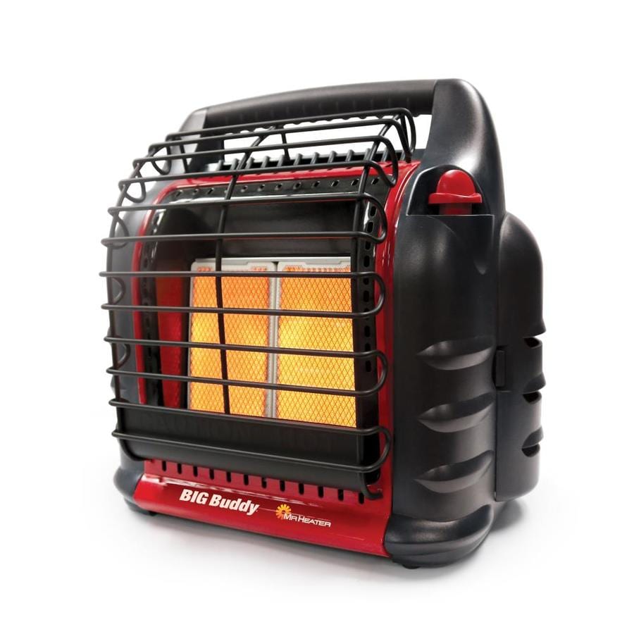

thundercamel said:
I used to use one of these heaters in my old garage. Do you have a tank from a grill perhaps?
Hm, you know.. i have a 'mrbuddy' heater which would be adequate to provide continuous heat, but it only takes a very small propane tank.
Perhaps it could be modified so that it could use the larger propane tank using a hose etc.
I'll have to look into that, since i don't want to bodge up the epoxy settings and expose it to heat/cool cycles during the >24 hr curing period.
Does this help? It's a bunch of pics of propane "can" adapters to tanks:
https://www.google.com/search?q=propane+can+to+tank+adapter&tbm=isch
Maybe it will show you the right thread/gender combination to do what you need to?
