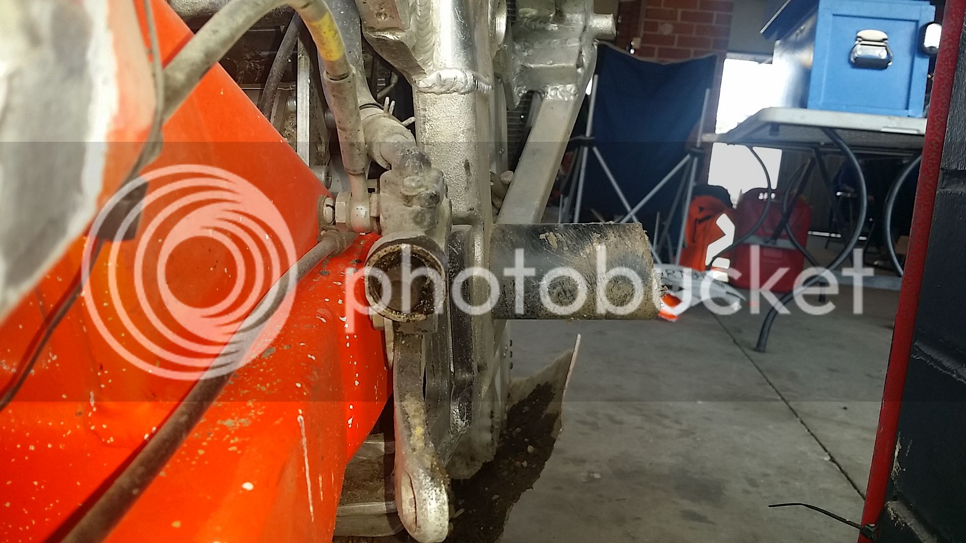

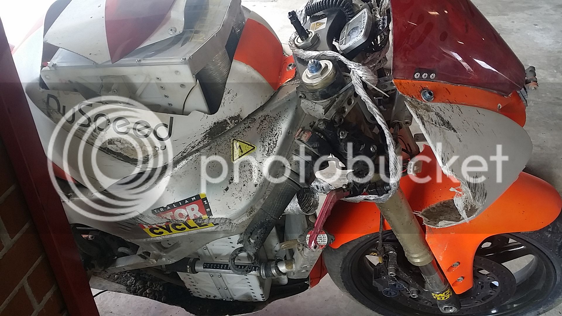

brad went down in race 4, scratched the bike up a bit. weird thing was he wasnt even pushing it. Was doing 1m 46's all day with good tires.
So missed out on 50 points.
Heres some shots.
Aww! Rebuildable?
Tough luck, was it the front end that lost traction? Looks like the crash knobs did a reasonable job. Is the rear brake master-cylinder snapped off or is that the photo angle?
It was a high side after watching the live feed video, he got pretty winded as he hit the tire wall.
He was almost out of the turn as the rear let go when he amped it up.
The rear master cylinder push rod has a ball type socket on the end of it. That just disconnected and fell off with the foot peg and lever.
Funny, never got to use that brake, only had to put it on for club racing rules.
Look in pic 2 theres a long crack in the side panel of the new battery I just built so it took a big side impact as it hit the ground.
Its rebuildable, most of the parts that broke are parts I can make in my cnc.
Brads Dad will get a new fairing but brad is up for new leathers AND helmet
Brad clocked 232kmh on the straight when he was drafting some of the twins :mrgreen:
