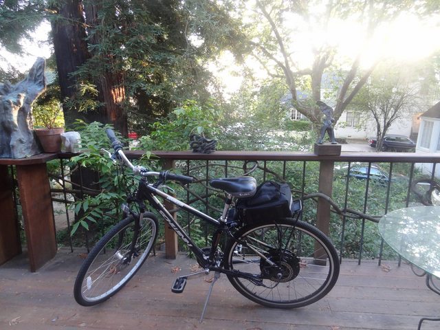

My trusty steed:
It is currently powered by EbikeKit.com's direct drive motor (model they had in 2012) and their 'upgraded' 72V controller they offered back then.
The battery is no longer the lead acid in the picture, but the straight-from-china special 48V 10aH lithium ion (as pictured here: http://www.alibaba.com/product-gs/844093031/48V_10Ah_e_bike_battery.html)
Surprisingly this pack has held up well, the bike has just passed the 1500 mile mark with it. However, my own personal ambitions have driven me to try and create a faster E-bike.
Currently the bike cruises at a respectable 27 mph (on flat terrain) with a 15 mile range (measured on the very hilly terrain of Northern California). My new goal is to create a bike that can cruise around the 40 mph mark (again, on flat ground).
I have done some digging and found some reports that the Ebikekit direct drive motor is a 9C 2807 clone (source: http://www.electricbike.com/9c/) However, I do not know how to verify this.
I hope to make the new pack out of these 6S packs (http://www.hobbyking.com/hobbyking/store/uh_viewItem.asp?idproduct=8582&aff=221230) because of their cost/watt, but I am open to suggestions.
To put it simply, what should my battery voltage and current goals be in order to hit the 40 mph flat ground cruising mark? What should the mAh be on the pack to achieve a (hilly) 20 mile range? With these requirements, will the EbikeKit.com controller I currently have handle these requirements or let out the magic white smoke? If not, what motor/controller combo would be a good choice?
Additionally, do you think the hard-tail hybrid commuter bicycle I have converted (pictured above: Schwinn Voyageur GSD link: http://www.performancebike.com/reviews/performance/power/pwr/product-reviews/Bikes-Frames/Bicycles-Frames/Cross-Comfort-Bicycles/SCHWINN/p/30__9536-2007-Schwinn-Voyageur-GSD-Comfort-Bike.html) can handle 40 mph without falling apart?
If you have any questions or if you need more information let me know and I will try to answer it as best I can. This forum is usually very good about answering these types of questions, thanks in advance.
