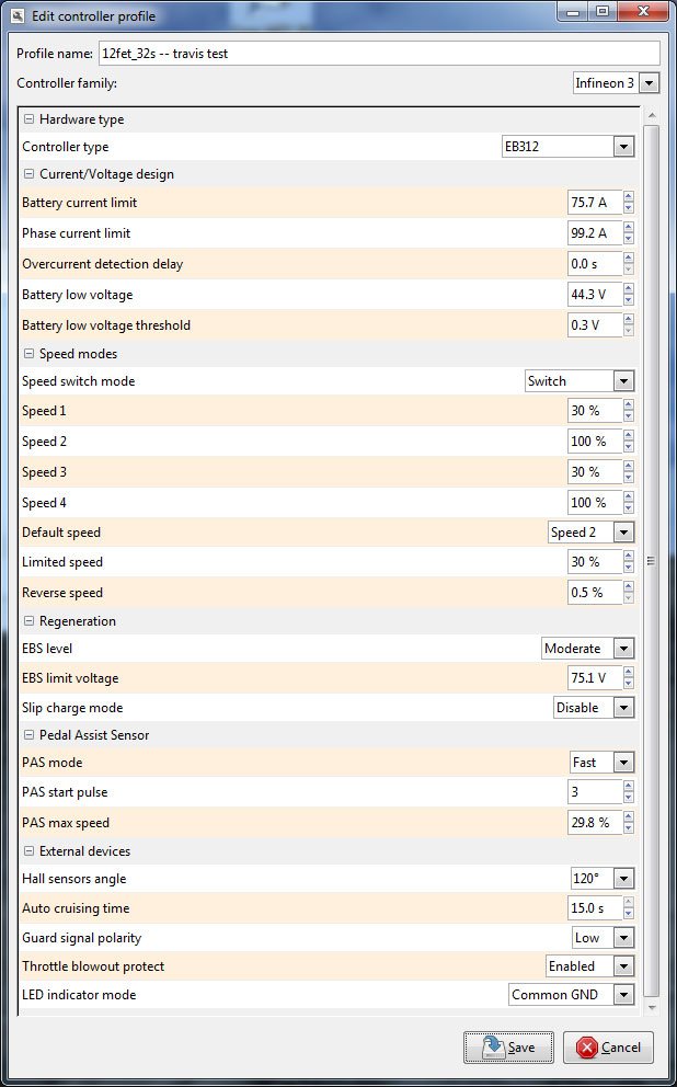

I did just put this together at work... Anyone see any issues with these settings? If not, I plan to flash the controller up tonight, and maybe test the motor.
well.. one thing was off.. low voltage threshold should be 59.2v... (3.7*16=59.2v)
I'll reflash to make that correct... but that aside....

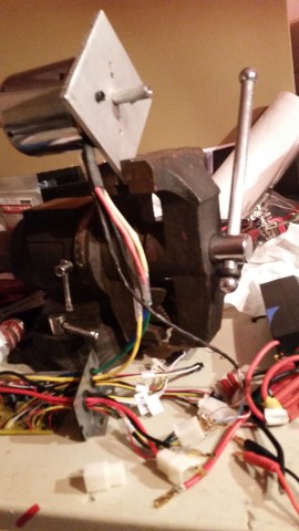

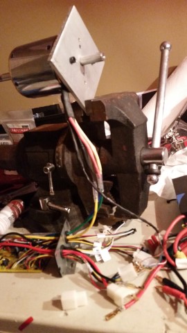

so first thing I did from the post above, was test out the motor and find my hall combos:
once I had that setup, I knew my motor controller worked with my motor and halls..

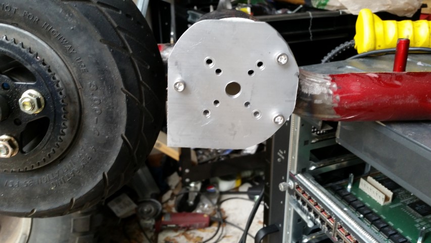

I still have a little to-do here.. The wires for the halls inside the motor kept moving into the way of the can bearing. so I used some superglue to tack them in place.. I need to re-open the motor and use the proper high temp silicone adhesive to hold them in place. I also found that the can of the motor is slipping on the shaft. I need to pin that down for sure. I'll get back to this later.

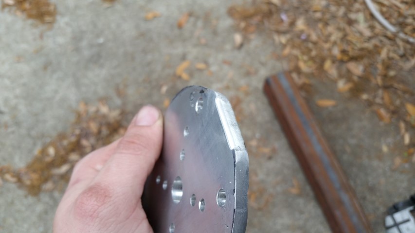

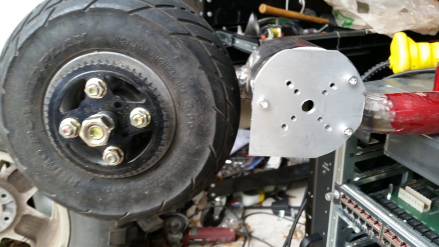

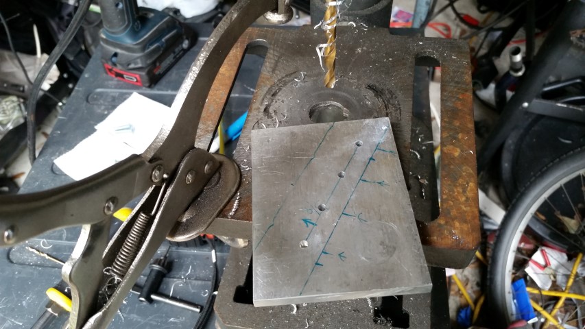

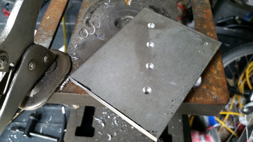

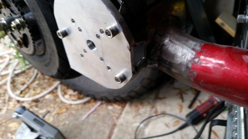

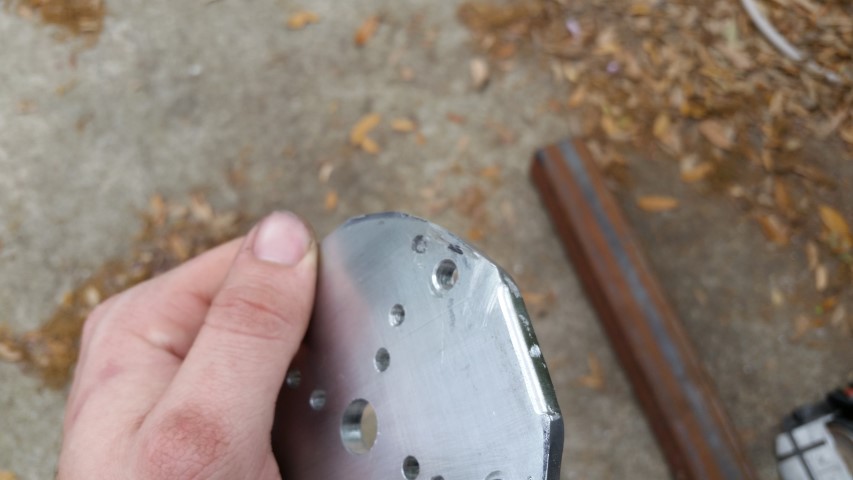

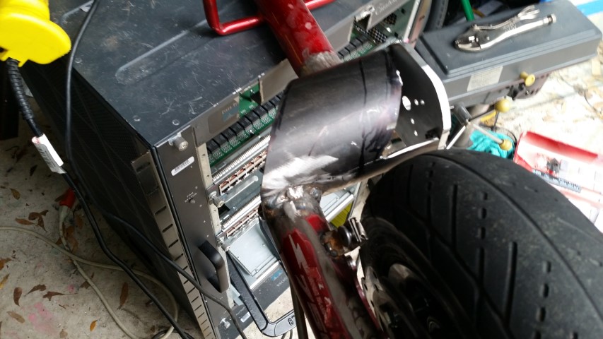

I dragged out my tabletop drill press and made the holes for the plate you see above... I then measured out and drilled the holes to mount the motor to the can. I decided to do a 3 bolt mount. I wish I took more pics, but I was working on it and didnt think about it at first. How I did it was simple..
After figuring out where the bolt holes needed to be, I drilled them out.
I took the proper size nuts, and "spun" them on the belt sander.. this takes the cad plating off the side of the nuts, exposing clean metal for welding and makes them nice and round.
I then tightened the nuts to the plate.
I put the plate up in place.. the nuts are now touching the frame tube. with a little filing,everything just clears with a very light, by hand press fit.

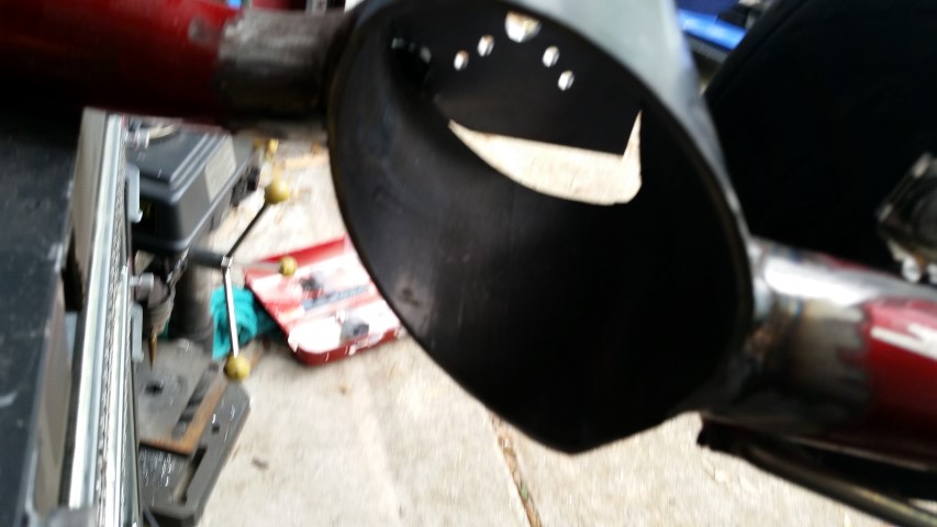

At this point I mark out the tube where I want to cut and keep.
where the cut marks meet, I drill holes, so they have curves in the corners instead of sharp points.
I chop the extra metal out of the tube... the top motor side cut is a little strange, but it had to match the fender/chaincover I will be using. all the other cuts are uncovered, so they are nice and straight.
With the tube cut, theres access to see where the nuts meet the tube. tack the nuts to the tube, and unscrew the plate.
finish up the weld around them and you're good.
Then go back and clearance the inside of the nuts to clear the motor if needed.. i only needed a couple swipes of the file in one spot and it all cleared nicely.
I then took the mount plate, and used the belt sander a bit to make sure there were no sharp edges near where the wires were...
then bolt the whole thing back together, and use a little flap wheel so the edges of the plate match the tube.
The lower rear corner was left alone, as it will eventually have my chain slack device there.
Pics of the mount:

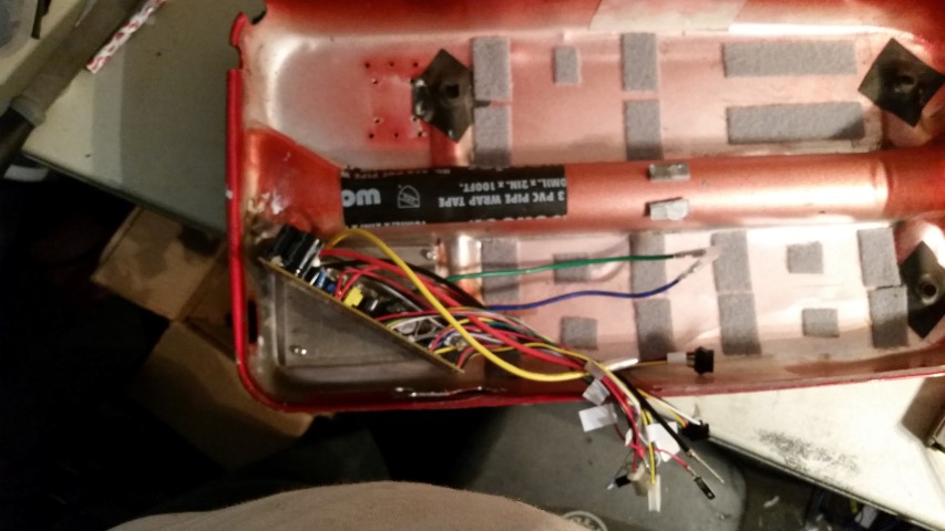

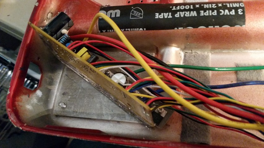

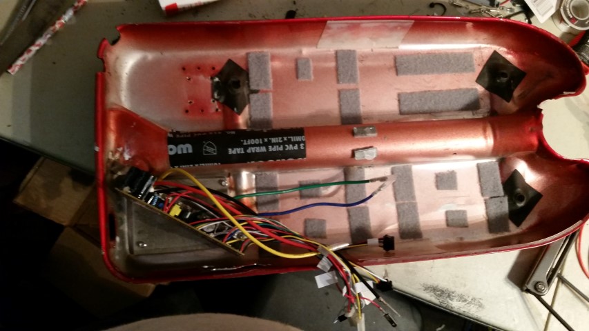

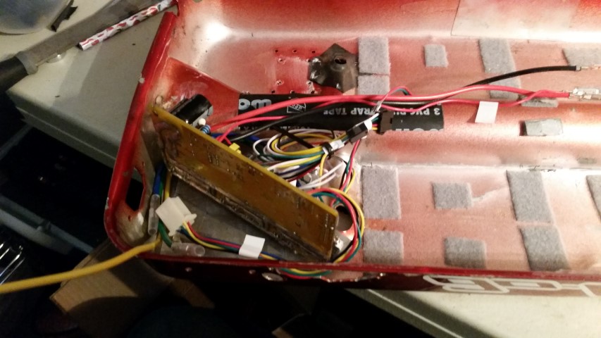

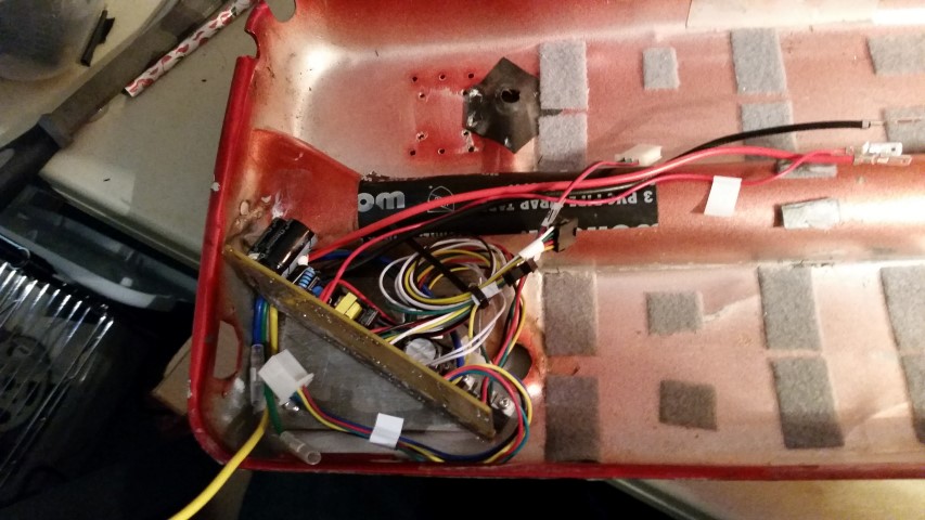

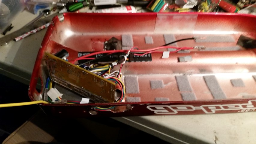

ok, with that done, I went on to the controller mounting.
I marked out where my holes needed to be.
Then I flipped it over, and countersunk the heads

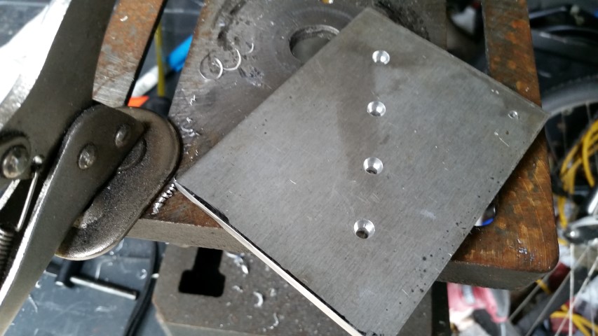

I then tapped the mounting holes for the plate... and installed the controller to it:
And then I screwed the plate to the pan with button head screws... all this will have heatsink paste on it when its on final assembly

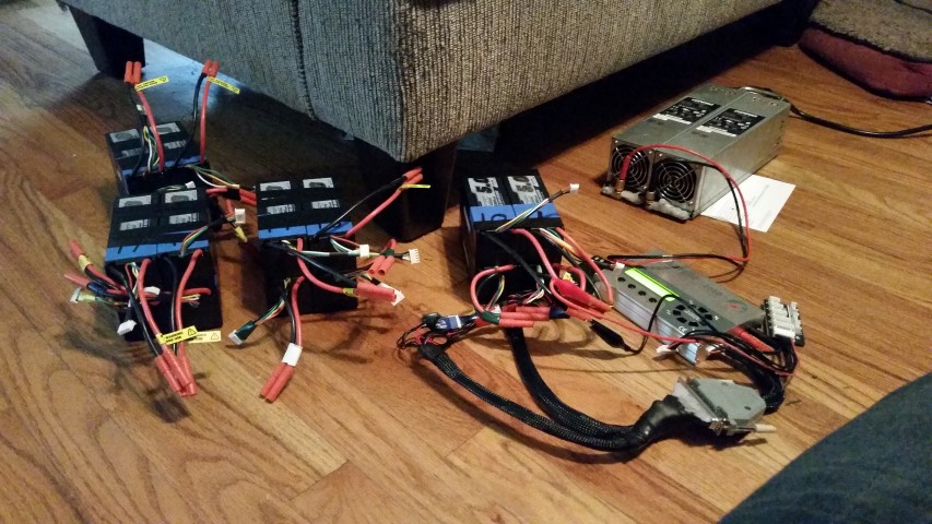

so last but not least... I charged up all 4 16s packs... 8 cells at a time. that way they could all be the same voltage when I paralleled them.
In these pics, we have two server powers supplies connected for 24 volts (24v @ 32 amp capable nice supplies.)
They're powering a 208b i charger.. where its charging each 5Ah 8s pair at a solid 1c rate of 5 amps.
for those wondering about lipo safety.. notice my jeans/leg in the corner. I am sitting next to this the entire time as it charges.... tv is on, but I am reminded... server power supply fans are LOUD!
While this is charging, I made the balance charger harness ending in two 8s connectors and the main power harness.

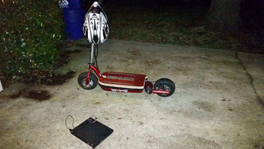

So I get home late and decide I will try it out.. just a little bit. I carry it downstairs, set it down and remember... I had to let all the air out of the rear tire to disassemble the wheel, so I could add my sprocket spacers. I normally filled the tire using the air compressor, but I JUST loaned that out to a friend who has a garage he can properly set it up in... So I try using my bicycle air pump... but unlike my air chuck, the pump is a 90* connector, and that wont fit behind the disc brake adapter. Frustrated, I raid bat-pig for quarters.
( Not my actual bat-pig, file photo used. Actual bat-pig located in man-lair, below TV.. Hidden from wife.)
Quarters in hand, I run over to the gas station and pump up the tire. While I am gone, the cat manages to steal and bat the wheel spacer around the house. So I trace that down too.. I find 3 quarters in the process, so thats 75% off what I just paid for air. yay.

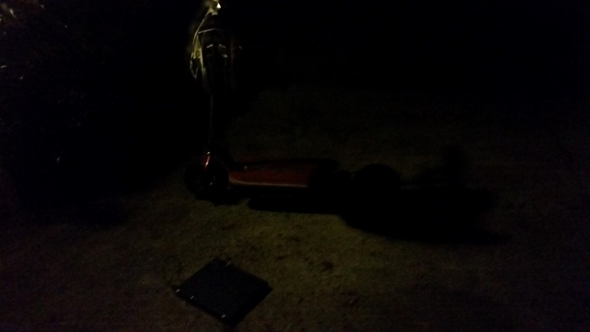

So now its late. I take the scooter outside, and point it down the driveway. *click* button on.. all should be good. ease the throttle down.... oh yeah gotta connect the battery. duh.
pop the deck off, connect precharge, connect battery.. and we're good. deck goes back on.
i click on the the power, and ease the throttle down.... *JERK* the damn thing attempts to rip away. Now, not to brag, but I am good with motorcycles. You can give my the meanest, touchiest monster 2stroke you want, and I will ride it with a stupid grin on my face.
I did not have a grin on my face. I know the difference between a voltage throttle (what I have) and a current/torque throttle (what motorcycles have). I still didnt expect it to be THIS touchy.
I realize I am being stupid, so I go back inside and grab the brand new helmet I bought specifically for this thing...
I attempt to feather throttle away, but the slightest throttle and it jerk/ripped away. completely unrideable... But I DID start out with 75 battery amps and 100 phase amps.

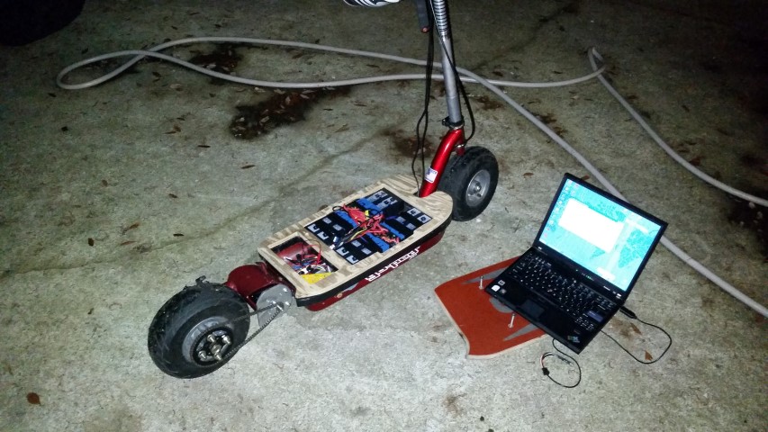

So I drag out the laptop and reprogram it with 50 battery amps and 75phase amps.
I manage to get to the end of the driveway, but only with bumping the throttle. its really jerky.
I program it again, this time 50A battery, 50A phase and 50% throttle...
It will now move, but it "stutters". Its really jerky like the motor loses sync. Its not smooth at all, like it is when freewheeling.
I go around infront of my house once, but I realize all this is silly, so I pack it in for the night.
I need to get a cycle analyst.. I would try to build the current throttle arduino someone posted, but I also want a battery monitor, speedo, watt meter and all the other cool features it has... so might as well just get that.
But before I spend more money, I really need to figure out why the motor was "stuttering" like that.... too much current that it overwhelmed the cutoff? poor hall sensor placement? bad hall sensor? I have no idea. I need to look into it further for sure.. maybe at lunchtime today, if the weather cooperates.
I realize I stopped taking a ton of pics, but I havent been able to really get into working on it like I did at the beginning.. not for lack of desire, but when you get 10mins here, 15mins there... its hard to remember to take pics.

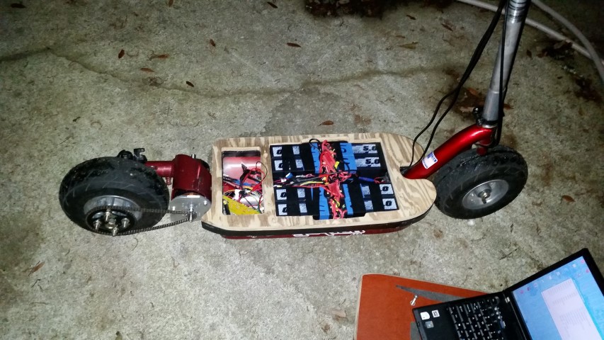

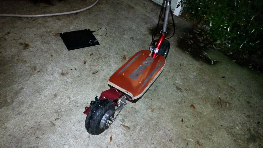

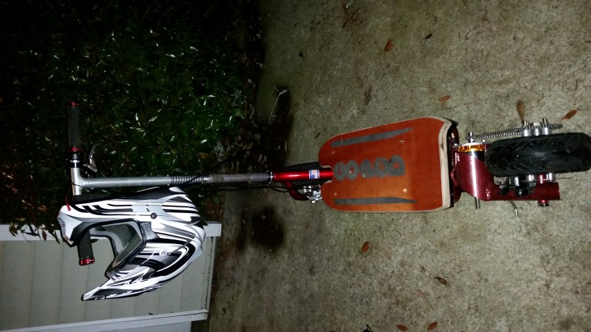

So heres some pics of it in my driveway lastnight. I sprayed some TEMPORARY paint on the raw steel to prevent rust.. and clearly it doesnt have the fender/chainguard I am working on... and the deck spacer needs to be sealed/painted... but here she is...
another thought.. I really need to disable the regen right now.. between the chain slack whipping back and forth, and the small wheel for the regen amount, I should disable it.. it should smooth it out some when I am bumping the throttle....
What did you set the 'block time' at?
I would put it at .1
If it is set at 1 second, that could be your problem.
I believe "Block time" is the same as "Overcurrent detection delay"... its set at zero as recommended by Thud.
I am using XPD to program it, as Lyens controller software is not as flexible... but they both work identically as far as the controller is concerned.
Should I keep it at zero, or bump it up to .1?? I think Zero means off, and .1 means its still on a little...
