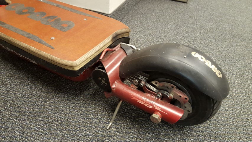

ah. I never updated here. Probably should.
So I had this annoying pulse to the chain drive, because it was not perfectly centered on the rear wheel. It was yanking on the chain and motor mounts
If you recall earlier, I couldn't clear the mounts I wanted inside the tube, and was forced to use nuts, tack welded on each side.

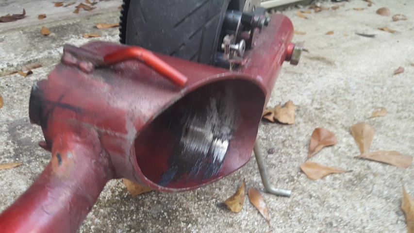

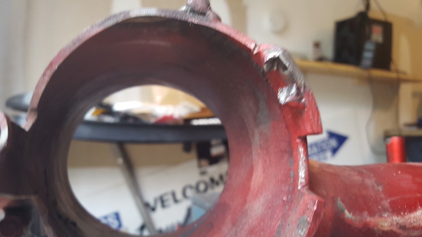

This all went to hell a couple weeks back. one of the nut mounts broke... no big deal to fix, but to get home from work, I rode it with two of the 3 mounts.
about 3 blocks from my house, the second mount broke.
I made it home, but I found that it made the motor rub on the ring... it was moving. it also rode glass smooth as the motor could "shake" with the eccentric of the rear wheel being off.
So I decided to fix it properly, and mount long nuts it on the OD of the mount tube. This means I needed a new motor mount plate, as my current one was flush with the tube OD.
I bought some new 1/4" aluminum plate, and made a new mount.
I tried welding the longer nuts, but the heat melted through. So I had to redo them twice.. eventually learning to NOT have the SS bolts in there, but run normal bolts in there while welding....
I eventually had the new mount plate and mounts done...
I also found someone selling an alignment tool, and purchased it.
I re-aligned the rear sprocket.
done.
It was glass smooth. Every vibration I had was from the sprocket not being round, the weight/balance of the wheel being off from the sprocket not being centered, or the motor from being pulled on by the chain.
Perfect.

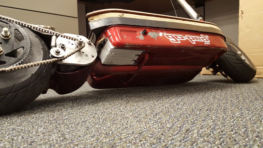

until it all went to... well it was bad.
The rear sprocket is held on with bolts... the nuts are on the sprocket side, and the long bolts pass through.
I must not have had the chain tensioner adjusted tight enough, because I hit a bump, and the chain jumped off the rear sprocket.
it wrapped around the bolts.
and yanked.
hard.

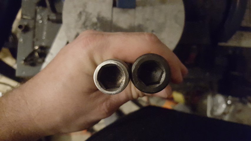

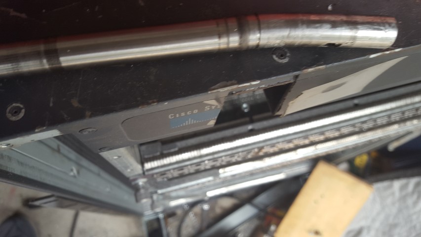

the 12mm stainless steel shaft of the motor was bent. a good 30-40* bend.
I had to push it home.

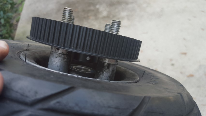

The weekend before last the parts arrived. I took the pulleys and drilled them through... the smaller pulley I drilled all the way through to the motor shaft size. I still need to cross drill it for the set screw.

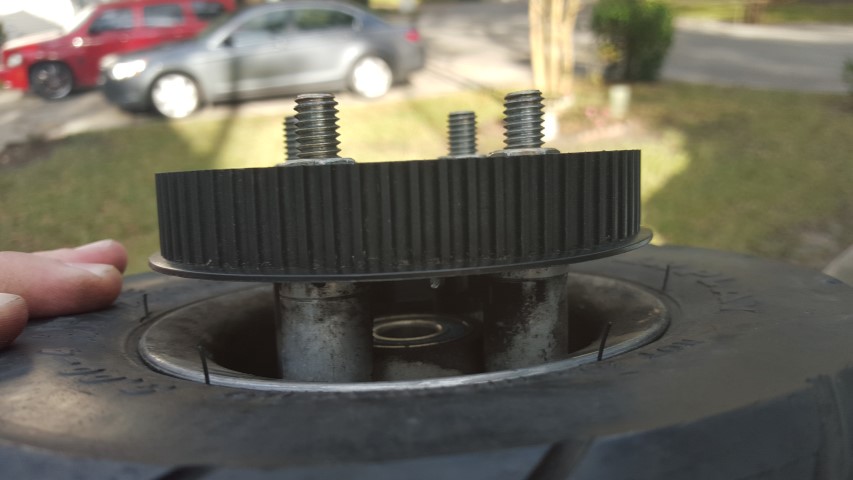

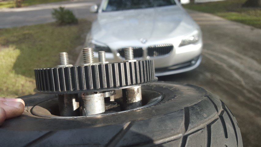

The larger pulley is all set... I think. I went with a plastic (glass reinforced nylon66 I believe) one with a aluminum hub. I drilled out the bolt pattern carefully on the plastic, and then drilled the hub to 7/8.
This SHOULD let me pass the axle (5/8) with spacers on it though... but I would need a longer axle.
My axles are just 5/8" bolts... so instead of buying an even longer bolt so that the nut clears, I am trying a new idea of using an allen headed bolt and passing it through backwards... head on the pulley side.
This means I can run a shorter bolt, and the nut on the chassis side. I keep wanting to call it a swingarm, but theres no suspension.. lol.
So that part is on hold until my bolts arrive. They should be here today, and I'll try them out tomorrow.

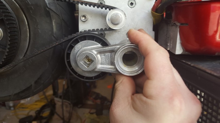

my tensioner however will not work as I hoped. It is a AC belt (thinner than the usual) tensioner for a early 2000s Chevy truck. I bought it because its simple and I like the design. unfortunately it is just too big.
So... to fix this I needed to disassemble it. going on my years of experience with this I clamped the hell out of it, put a couple safety cables on it, and disassembled it. I still managed to get the spring to fly 5ft across the room.... thankfully I knew that was likely and stayed clear. lol. seriously though, I was extra cautious. Please don't take apart tensioners like this unless you know how to keep yourself safe.
I will reuse this arm and spring, but the base and roller are going bye-bye.
I have a new roller intended for this size belt coming to me.. its from china though, so it will be a few days. I wanted a US made one, but couldn't find it... well, that's not true. I found a couple for $40+ but I will take the $2 china one instead. It is just an aluminum spool with bearings pressed in. worse case, the bearings are crap, and I will just replace them.
anyway.. as soon as I cut the motor shaft, drill/tap it and the pulley for the set screw, and mount the rear wheel and finish this tensioner.. I can ride it again.

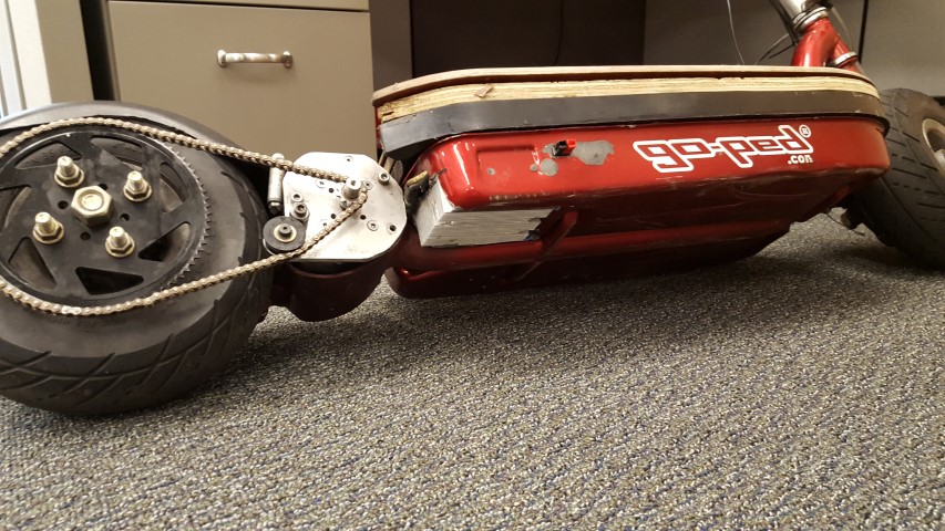

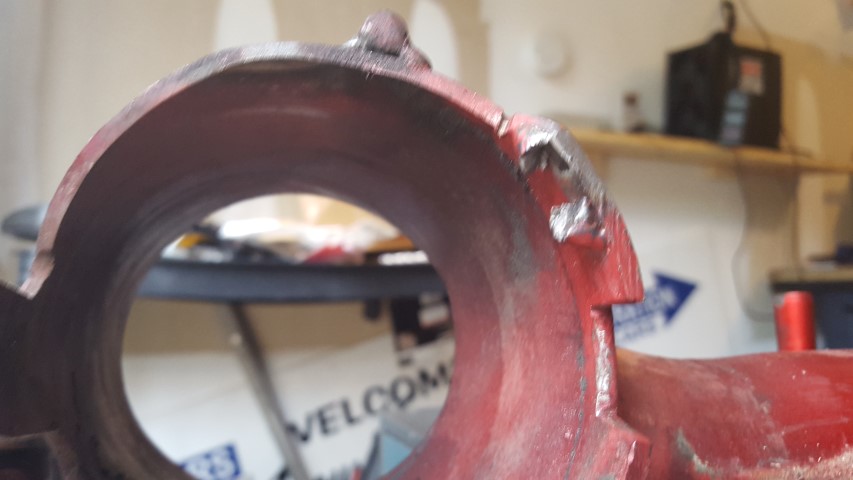

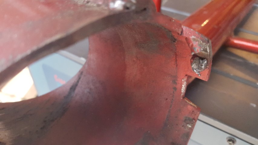

One of the nut mounts broke... no big deal to fix, but to get home from work, I rode it with two of the 3 mounts.
about 3 blocks from my house, a second mount broke.

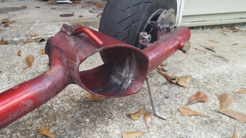

done.

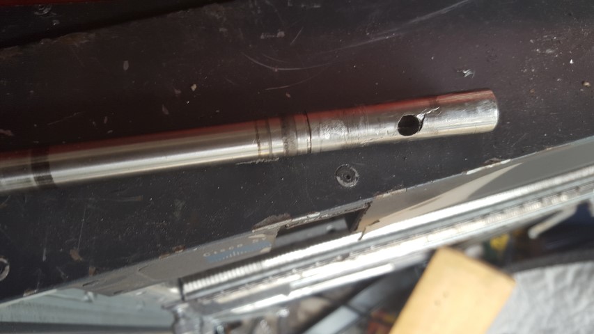

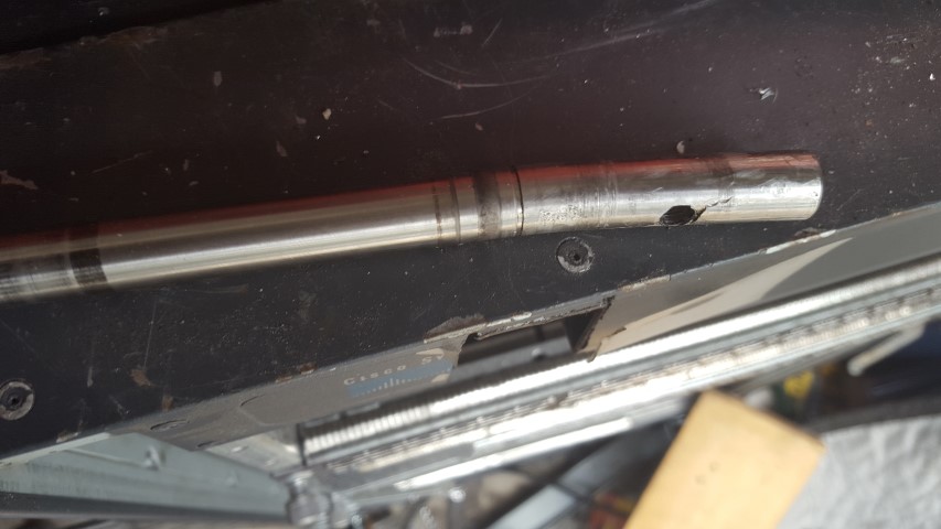

This is the motor shaft after I pressed it a bit straighter, and pressed it out of the motor.

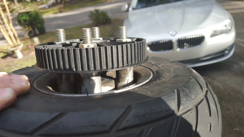

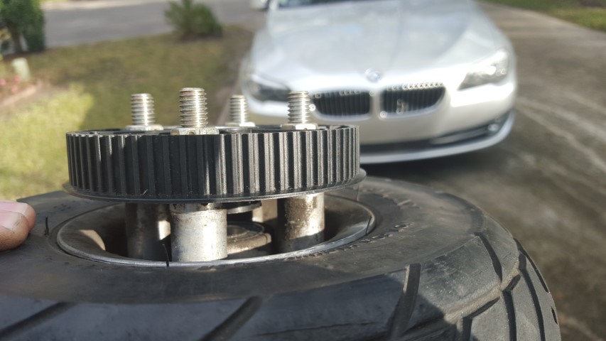

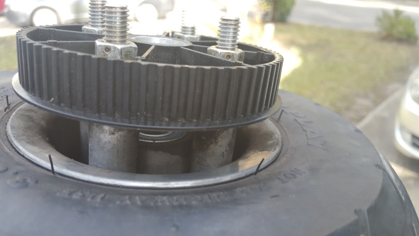

I didnt take any pictures directly of the wheel, but I did take these pics where I could see the clearance of the pulley hub to the wheel hub bearing:

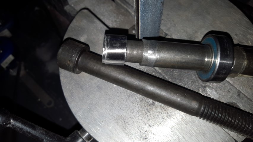

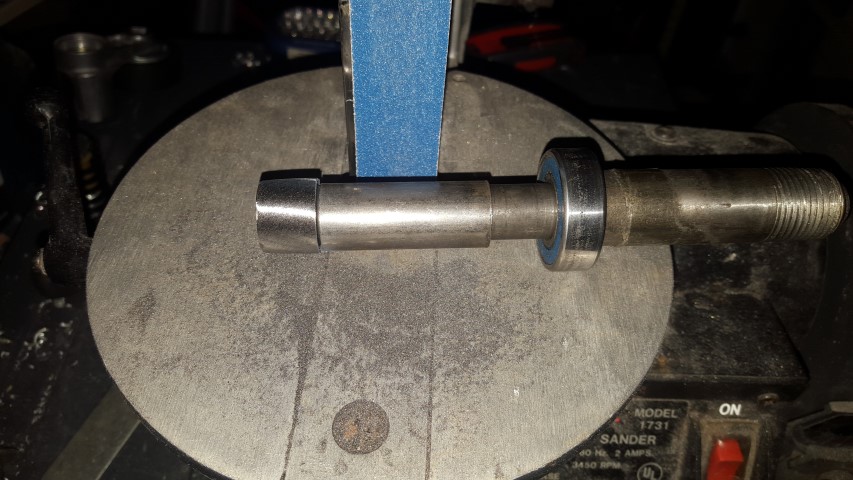

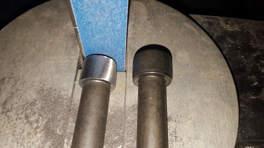

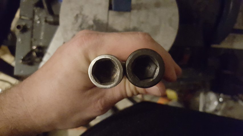

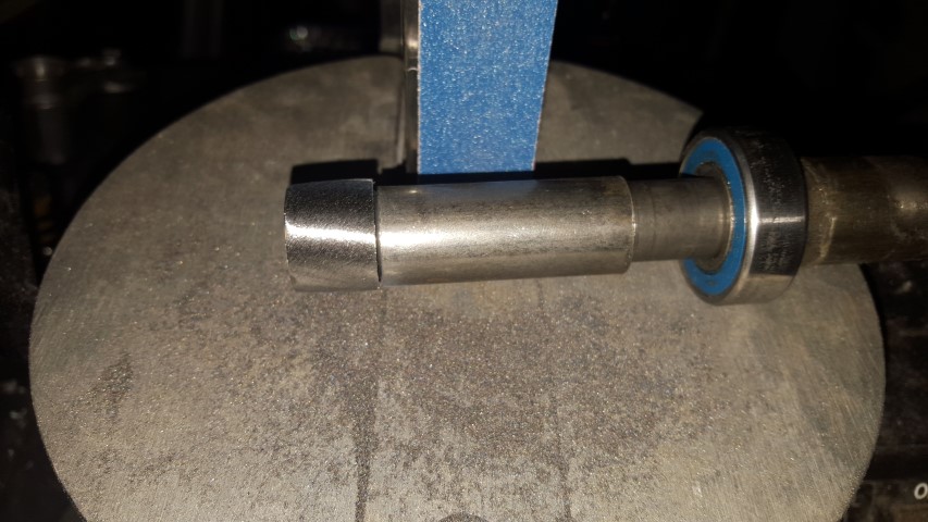

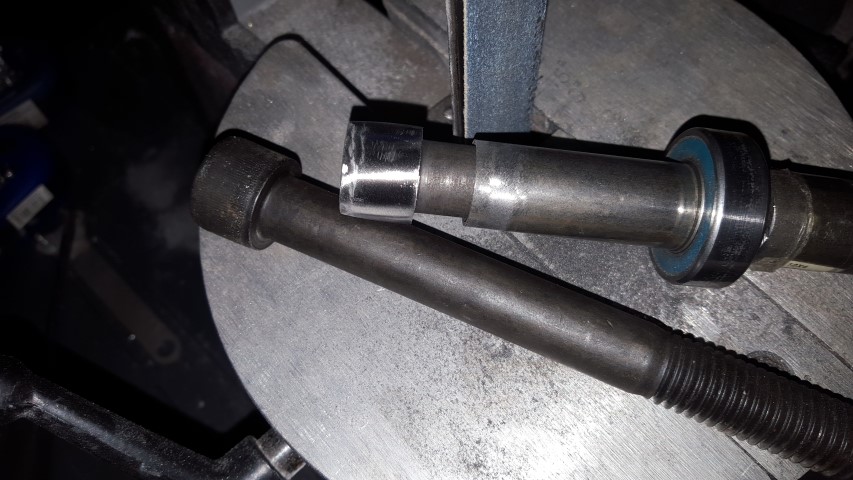

The bolt arrived, but the head is slightly too big... so I mounted a bearing on it so it can spin, and used my belt sander to bring it down to fit.
Cool, I now have an allen headed axle that I can pass through the wheel. I just need an allen head wrench that size.

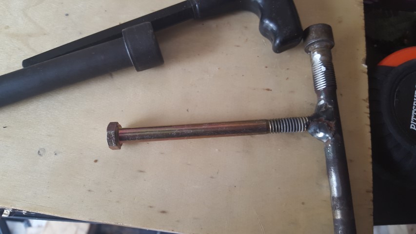

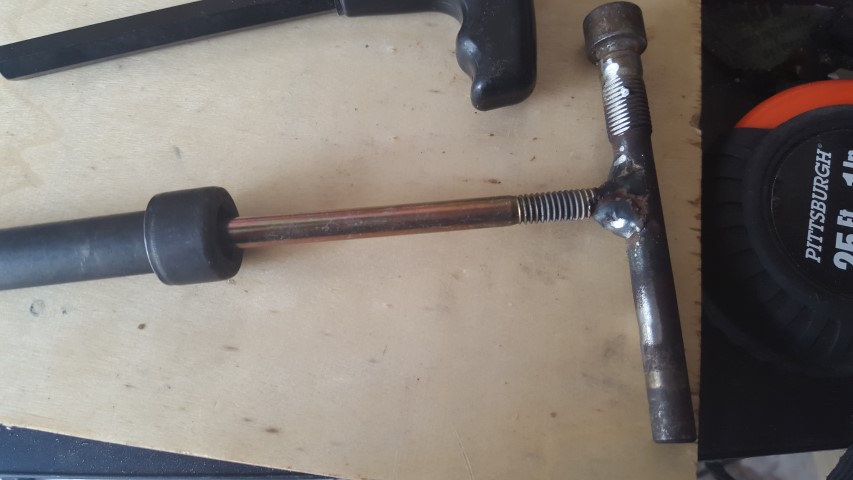

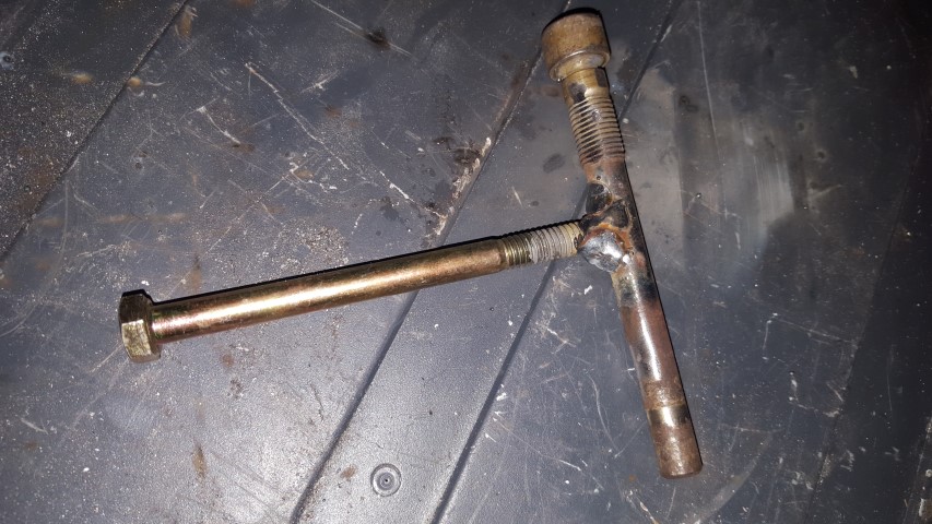

Since I can not find one locally that would reach into the wheel and work, I made a simple t-handle:

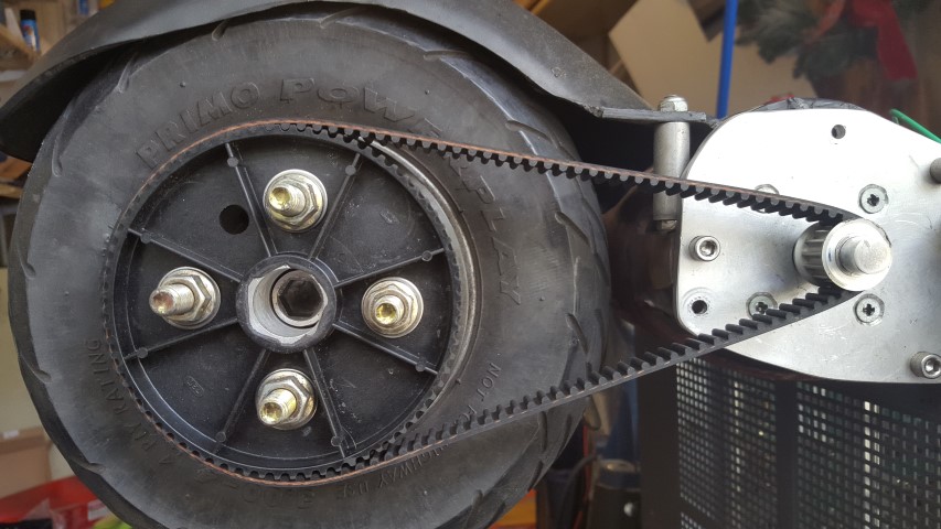

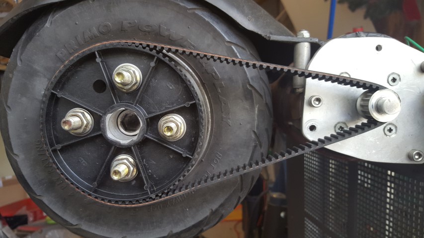

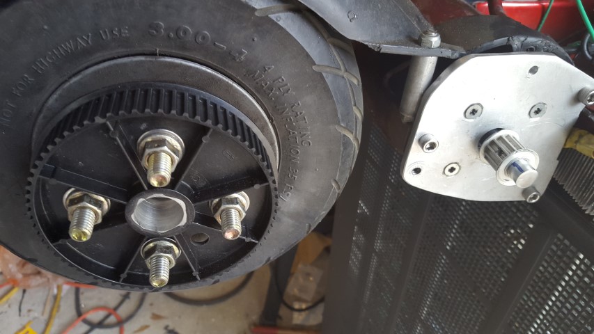

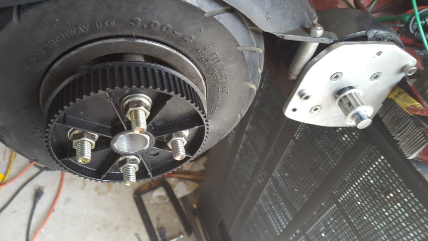

With the sprocket on the wheel, and the motor all refurbished, I did a simple mockup:
Just slip the belt on and:
excellent. the slack in the belt is intentional and perfect. The tensioner will press up and give a little extra wrap on the smaller pulley.

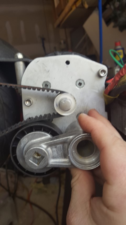

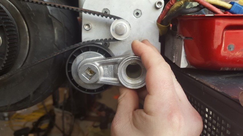

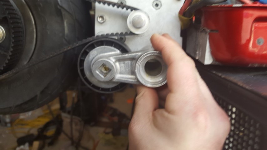

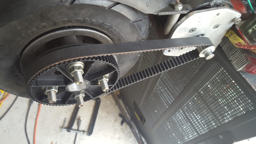

here it is, held up on the belt with the huge pulley on it:
I have a new roller intended for this size belt coming to me.. once it arrives I will either modify and reuse this arm, or just make an all new tensioner from scratch.

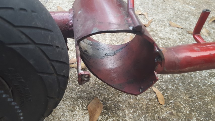

The belt mod is coming along nicely. Do you have any concern for the one sided axle mount? All that motor torque is on the unsupported side. Did that have anything to do with the chain coming loose?
naa. its all thick steel, overbuilt to the point its ridiculous. Its exactly like goped does from the factory.
If you lock the back brake on the stock goped (it doesnt have one normally) you can make the stock motor mount flex... but the rest stays solid. The motor mount for the stock motor is just a sheetmetal U.
With this, its not going anywhere.
The chain jumped off because I was going over some rough spots... the bouncing combined with me not preloading my tensioner enough (or it slipping).
really though, the chain sucked anyway. the front sprockets always wore out, and the chain always needed lube... total pain in the butt.. especially since Goped ESR sprockets are not cheap, and I have to drill them out.
I'm currently using double D sprockets and t8f chain. Double D is essentially 10mm shaft with flats at 8mm. The end of the shaft is threaded to hold a nut that secures the sprocket. The sprockets are pretty cheap and come in 9, 10, 11, 12,13,15 teeth. The chain makes a good bit of noise on the smaller sprockets and gets a little quieter with the larger sprockets. The sprockets can be found in #25 and t8f. I'll have to come up with a better sprocket mounting method if I continue using these sprockets. I expect DD sprockets will start rounding over the flats on the shaft after a while with higher torque.
