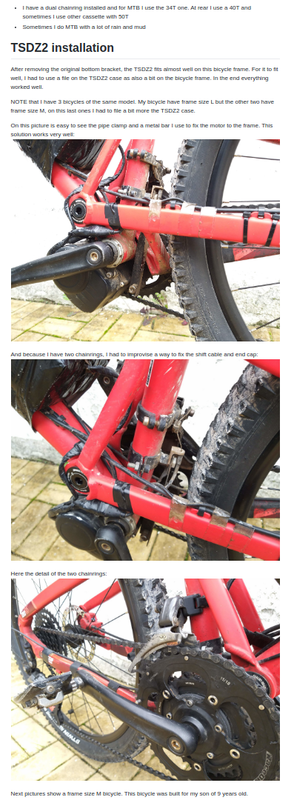

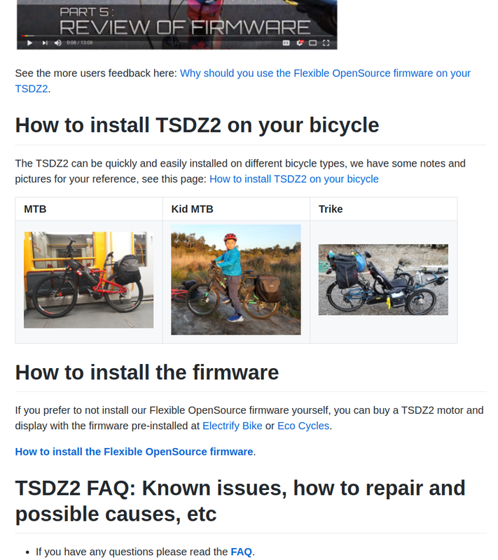

Today I did something I wanted to do long time ago: write some notes about different ebike builds with TSDZ2 so they can help new users.
For now there are notes for MTB, Kid MTB and Trike. Next I would like to add road bike, hand cycle and fat bike, but for that, I need to find pictures and notes for them because I don't have them.
https://github.com/OpenSource-EBike-firmware/TSDZ2_wiki/wiki#How_to_install_TSDZ2_on_your_bicycle
I wrote my personal notes about my ebike experience and build. If you guys would like to write such a page, i can post on the wiki.
https://github.com/OpenSource-EBike-firmware/TSDZ2_wiki/wiki/Casainho-full-suspension-MTB-and-city-commuting

fireflyer451 said:
Casainho,
Information on the WIKI looks good. For the trike stuff I would suggest adding right in that page the Torque Sensor and Assist Level settings too:
I removed that information because:
- all torque sensors have different values so no point the show your specific values
- the assist level factors are also different from person to person and bike to bike, a kid with 40 kgs will need much higher assist levels then a and adult with 1000 kgs.
