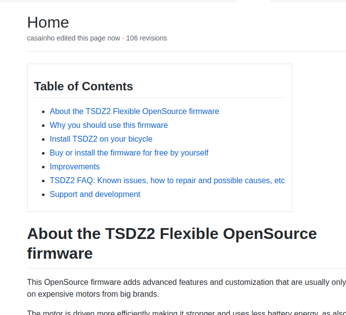

izeman said:
Everything in the motor looks fine. All gears look intact, bearings are ok - Chinese style, and I can't find any obvious problem.
As I mentioned: When I pedal there is no noise, so it clearly comes from the motor. And it's not a really complicated setup. Motor, 2 gears, another two gears, and that's it.
Did you read the wiki FAQ?? I bet the issue is the clutch slipping on the gear... and if so, it was not your fault as I said on first time. Let's discuss after you confirm the issue.
