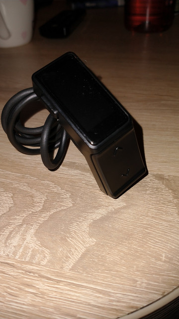

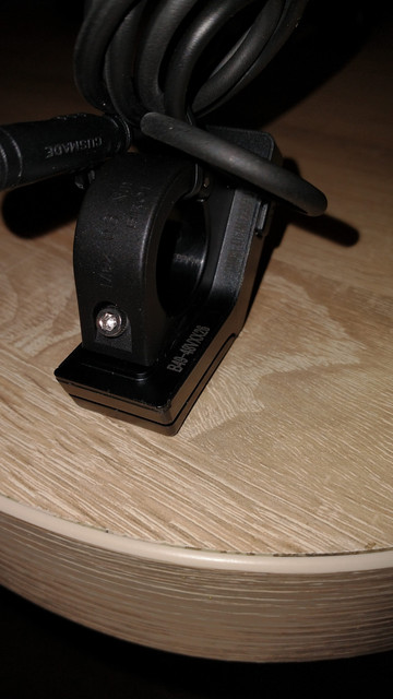

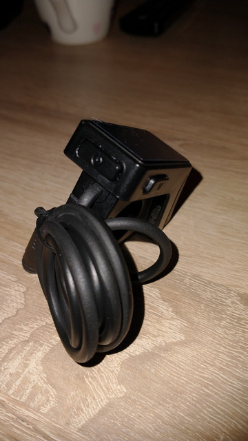

Hi. I bought a new SW102, a similar display came to the old version, this is marked as DM03. Has anyone tried to program it?
