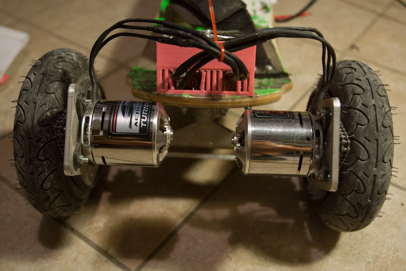

Let me post this here also. I call it bonebreaker since my last crash. 8)
Full spec:
top speed: ~50km/h (you don't wanna ride with that speed without full-face helmet and pads for knees and elbows)
average range: 20km
power: 5.4kW (7hp)
batteries: 2x10S 5Ah
motors: dual sk3 6463 245kv
esc: heli esc Turnigy delux 80A
drive: chain drive with 7.5 ratio
controller: GalWii controller with thumb throttle
brake: my version of brakes, similar to MBS V brakes.
board: MBS Atom 85
trucks: MBS ATS Truck
tires: MBS roadie tires (200mm)
There is nearly no hill in existence that this board couldn't climb. jk jk
This is my charging station. iCharger and batteries on top of 28-52V 30A DC power supply.

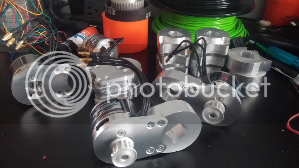

Here's a teaser of my current build. Its based off of a senior project I worked on and 1 of 6 prototypes. This one has a quite a few upgrades though.
This is my first board the Outrunner Board, It was built for a class project. I wish I would have found this website back then, we could have made a better board.
Specs are:
Sk3 5055 320kv motors
HTD 5M 12/36 gearing
3d printed hangar clamps
cnc cut aluminum motor plates
Hk150 esc w custom heatsink
Turnigy 6s 5.8ah x 2
Custom Omen Kush 16plies
Orangatang wheels 3d printed spacers
Current setup will do about 22mph, haven't ran through a whole pack before charging yet. Previous 450kv motors, 5Ah batteries did 31mph and 15miles no coasting.
The 450kv gearing was the same. It was really way too fast. That's 31mph not distance, but uphill or flat it would do it. 15mile range, no coasting and very spirited riding.
I took a dump at about 30mph after a stall. My arms were all scraped up. Its really too fast that's why I went to a slower motor. 22mph is still fast, I'm a big fan of around 15mph.
Yes all of the electrics are inside for a pretty clean look. I will see about getting some pics of the inside.

How many miles did you cover on those brackets? Are the brackets holding well?
Did you place any set screws/bolts in the caliber hanger?
