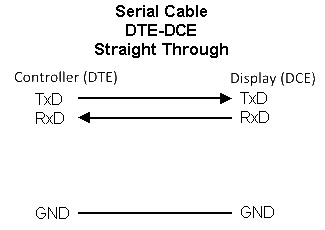

Can tell someone tell me the pinout of the cable..I don't have it with me here, but believe it is a 'stereo' cable..so it has a tip, a ring and sleeve.
What is the pinout please...
Also I assume that as per standard, the TX from the TTL adapter goes to the Rx of the controller, but which is which on the green plug. This picture I have seen below, is a bit odd in that it if you imagine it plugging together it is 'wrong' See what I mean

Looks absolutely correct to me. It's a photo I had saved and used for reference.
No, think about it. you are looking at the matching pair. The controller plug and the display plug. For the controller to talk to the display, the Rx needs to connect to the Tx
As the picture is shown, the Tx of the display is connecting to the Tx of the controller and the Rx of the Display to the Rx of the controller. Either the controller plug or the display plug has the Tx and Rx transposed
Works as shown on all three of mine. See the photo I shared as well.
Umm you are both missing the point I am making.
If the the picture showing the half of the connector that is connected to the controller, is correct, then the labels of the pins on the display cable need to be swapped. The Controller pin, Tx, will need to connect to the Rx Pin on the display, or on the TTL adapter,
if you connect Tx to TX, as the picture shows, the devices will not talk to each other as they will be both be transmitting on the same line and both listening on the same line.
If you go back to page one of this thread, the very first post..you will see it mentioned that you need to connect Tx to Rx, it is just basic communications, the transmitted signal from one device has to connect to the Receiver port on the other device.
The photo is correct.
There are two devices in a serial communications setup. The DTE (computer), and DCE (device you are talking to).
The TX line is an input for DCE and an output for DTE.
The RX line is an output for DCE and an input for DTE.
The only time you connect the TX and RX lines together is when making a crossover cable so that two DTEs can talk together.
In this case the Display is a DCE and the Controller is DTE (shown corectly in the photo).
Your laptop is a DTE and the controller is a DTE, so you will need a crossover (null-modem) cable to reprogram the controller. Not shown in the photo.
