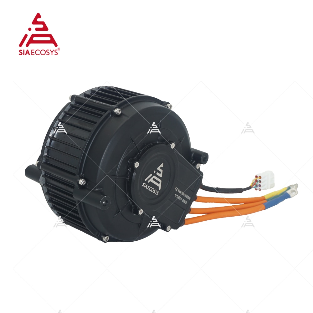

QS 165 looks like a good addition for bikes / light weight moto's.
![Sa6017a2212754fe98c056aa7b502c6acb.jpg](/sphere/proxy.php?image=https%3A%2F%2Fae01.alicdn.com%2Fkf%2FSa6017a2212754fe98c056aa7b502c6acb.jpg&hash=2eba6f4277703464543ad325e7175b54)
Is it possible to buy a QS138 90H v3 with encoder SIN/COS?QSMOTOR said:Hello,
The QS165 mid drive motor has two versions:Encoder and Hall Sensor versions for your choosing. If you are interested in it,pls feel free to contact me.

There is a CNC made QS165 10KW with gear reduction box available now.Sample cost is 1600 USD. The mold has not been opened yet. Attached pls find the info. about QS1654 10KW 60H with gear reduction box for your ref.speedmd said:QSMOTOR said:Hello,
Alan-alan@siaecosys.com
Thanks Alan. Nice form factor for a more narrow bike. Looks like a super efficient design at higher rpms and lighter loads. Good torque also at lower rpms. Any plans of a gear reduction model. Advise on shaft -sprocket options.
