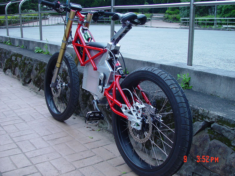

Yaah I would like to have a of-road e-bike.
So mid-drive would be a better choice :mrgreen:
To be honest, I would like a mid-drive bike also and in a few years that will probably be what most of us will use. However, the problem is that the mid-drive technology isn't developed enough for a reliable bike. There are almost no frames made to support a mid-drive and the other issue is there is less room for battery placement.
I wouldn't bother with a mid-drive just yet, i would wait a few years for that when more people are using them and frames are made for them. There is a reason why practically nobody uses a mid-drive.
To be honest, a hubmotor bike isn't all that bad off-road and are extremely reliable and handle well. If you are building it for off-road I would go with the MXUS motor because it is light in weight compared to the QS 205 or Cromotor.

I have 2 Cromotor bikes and I am building a MXUS 3000 bike and a QS 205 bike so I do appreciate the high power but heavy hub motors. Even so, I still like the idea of Mid-Drive so I am building 4 mid-drive bikes.
2 of the Mid-Drives I am building are Qulbix.
One is a Qulbix 140 that I am converting from hubmotor. The Cromotor will go to a different bike and a Lightning Rods Big Block Mid-Drive will be installed.
The other Qulbix will be a Q76 that Lightning Rods will install. He will have the frame for a while to Prototype a few options for people (small block, big block, MAYBE a Cyclone if there is enough interest, ect). Check out this thread where people are talking about the Q76 mid-drive right now.
The Qulbix makes a pretty good platform for the mid-drive kits because of the boxy frame to bolt into. There is some trickiness to high power mid-drives, as Offroader has noted. The big one is getting the power to the rear wheel in with different gears. With single speed, you can run stronger chains and gears and set it up for perfect alignment to get a pretty reliable and easily serviceable drivetrain. The multiple gears, it gets tougher. You end up running weaker multi-speed chains and rear 6 speed cassettes. The current solution I plan on taking for the Qulbix mid-drives are quite expensive custom 6 speed hubs. I hope a cheaper solution comes about but that's about it for now. Some people just feather the throttle and do ok with the Big Block motors but I don't fancy breaking stuff and pushing the bike home when way out in the woods.

The thing with hub motors for off-road is that if your bike is setup properly it handles very well off-road. When I say setup properly, you want a 10.5x3.5 coil shock for long travel and also a 17x3.00" fat rear tire run at 11-14 PSI, You really want is a shinko 241 in 3", 3" is important because the tire has soft rubber and flexes easily as the 2.75" are harder rubber.
These things will make the bike handle extremely well off-road because I run the bike very hard without issues and a good smooth ride. The only issue is if I really hit something large the front will roll over it without issue but when that rear hits it will kick up the rear of the bike. This is only when I hit something large and fast, like a curb which is rare. I assume this is mostly because of the heavy hub?
I have yet to try a mid-drive and what it feels like to remove all that weight in the rear. Maybe it will be a huge improvement that will surprise me.

Yep, 17-3.00 tire is where its at with the hub motor. For the mid-drive though, I would like to use the larger 19" since I can get torque through gearing and the larger wheel will go over stuff easier. However, I haven't found a 19" Shinko 241 in 3.00 wide. I see 2.75 and 3.50 but no 3.00 which is a bummer. Maybe it doesn't exist. I like the wider tire but 3.5 may be a little TOO wide and heavy.
Mammalian04, the perfect tire for you is a 18 x 3.00 shinko 241. This is about the same size as a 2.75 x 19.

Mike Backus (LightningRods) has been working with Mike Vidovich of TImberline Cycles. Check out the posts about his beefed up six speed.
Also check out CheekyBloke's 3 speed he made from 3 different sized single speed cogs and widened the deraileur. Derailleur hanger was a challenge and shifting is tough but he came out a lot cheaper than the the TImberline option and can run a heavier chain.
This lighting rod mid drive kit does look interesting. Since it is able to bolt to the Q76R bike and doesn't take up battery compartment space it may be worth using if you want to really off-road the bike.
I'll have to see how it all works out and how reliable it is. Seems like you can always convert your bike over to this kit and Lighting Rod even says it works really well with the Qulbix frames.
