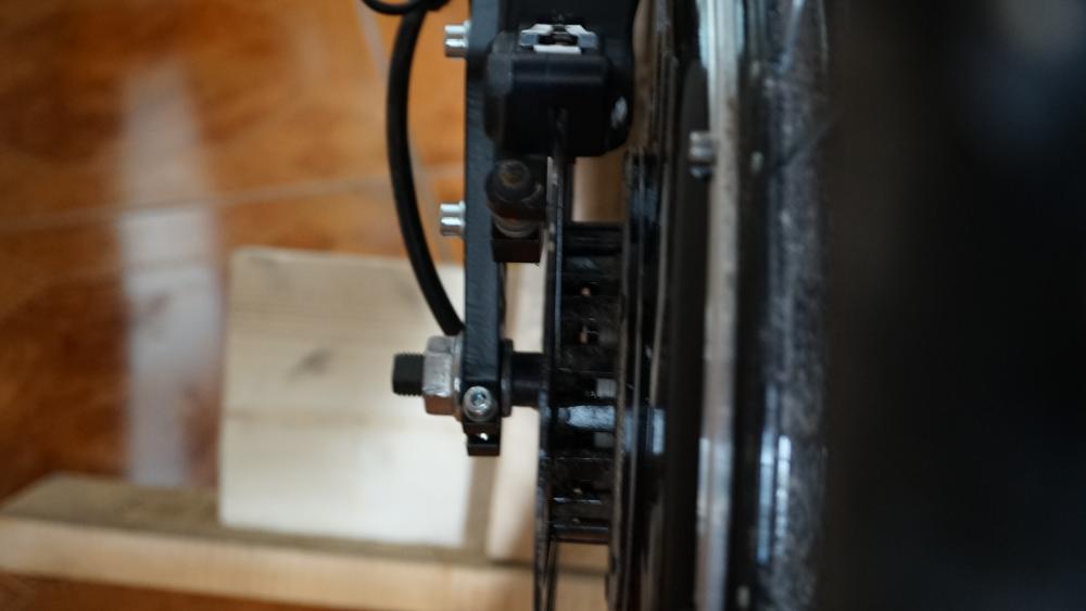

So !
first off the rear wheel. Just so you know, I use a standard 135mm width magic pie 5. I first properly aligned the disc side as there's not much you can do on this side :
I then put some washers so I have enough room to fit the end nut. I'm not gonna lie, I bent the arm a tiny tiny bit here, but it seem to be mostly ok :
I'm lucky, the derailleur I had had enough travel to reach every speed of the cassette. but if it didn't, something like this would have helped : http://lunacycle.com/motors/hub-motor-accessories/1-2-inch-free-wheel-spacer-for-hub-motors/
I just had to adjust the high and low limit screws and I can say that the derailleur is perfectly aligned.

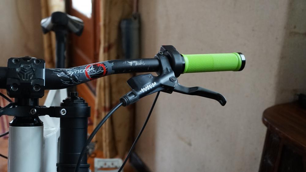

my starnut problem has been worked out and I cleared the headset a little (green handle grip thing because, yeah !)
BB is installed but, I don't know if this is because I used to unmount this thing a LOT in my previous bike, the inner BB axle seems a bit too short and I had trouble having enough length to the other side to screw the two arms together (I'm not sure if I'm beeing clear here). Basically I'm wondering if the BB tube of the frame is a little to long or if it is the width of my crank arms that is too small. Also, I'm not very impressed by the paint job of the frame. some of it (not much and it isn't noticeable) came off while installing the BB. I mean, the frame is great, but the paint job is nothing like my santa cruz bike wich pretty much still looks new even after 5 years of riding.
The rear derailleur cable is too short, new cable is on it's way.
