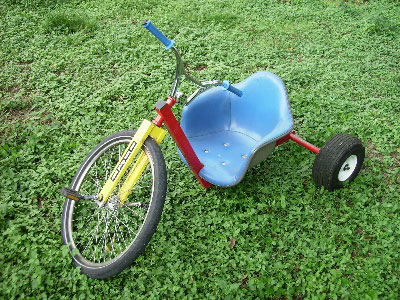

The recumbent format I have tried that alleviates many of the problems I mentioned is the recumbent trike. In he 90s, I used to work with Rick Horwitz and got to try out one of his designs. Later I checked out a Kettwiesel.
Eventually, I built my own recumbent trike. I guess you could call it a front drive delta fixed gear lowracer:
